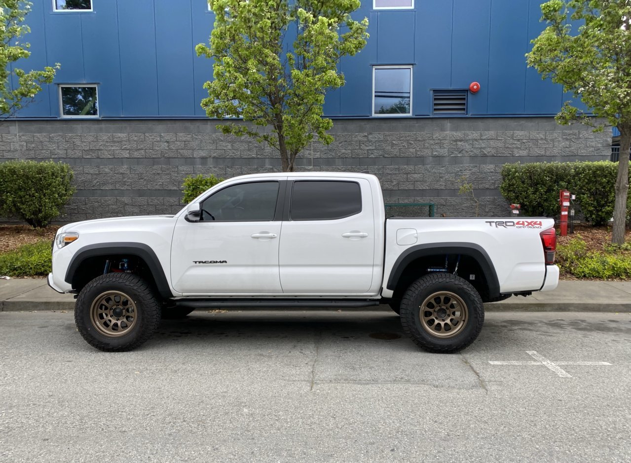

    I’m running the deaver stage 1 expeditions

    little over 2.5" in the front and a little over 2" in the rear

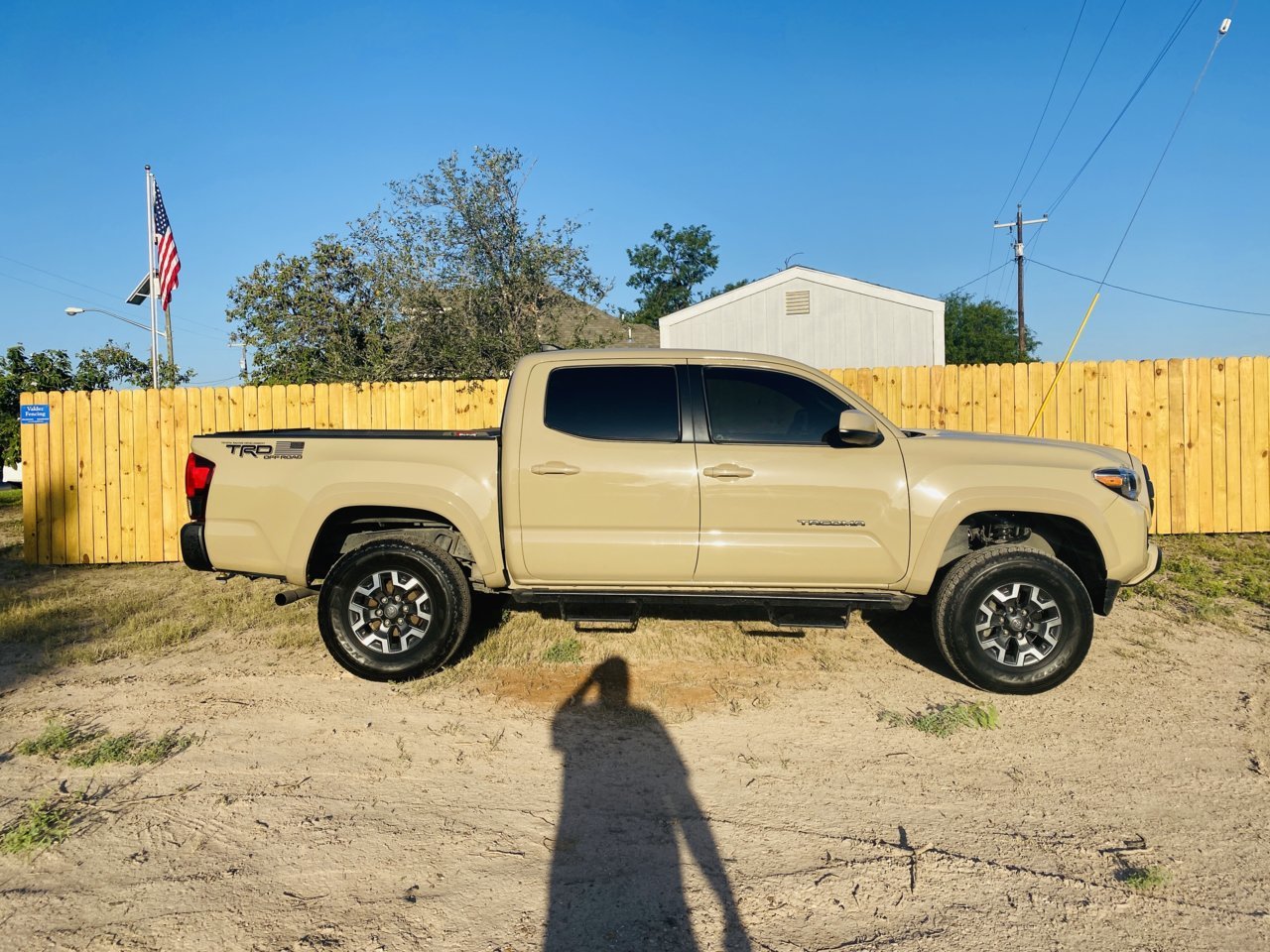

    Looking to order king 119AExt and 121A ext anyone know of a place that has them in stock and can ship ASAP?
