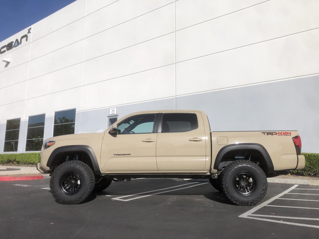

    What are you planning to add to the rear? I have the Icon RXT leaf pack and am satisfied with the lift and the ride quality. My bed is empty 95% of the time and I run "option 1". If/when I add a HC rear bumper, bed rack with RTT, etc, I like that I can add the additional leafs it comes with.

    About 2" in front and 2.5" rear after 6 months of settling (the photo above is right after install when I had 2.5 all around). I'm planning to add more preload up front to level it out again. 2.5" is the max you'd want to lift the front, otherwise you'll be topping out all the time and degrade the ride quality.

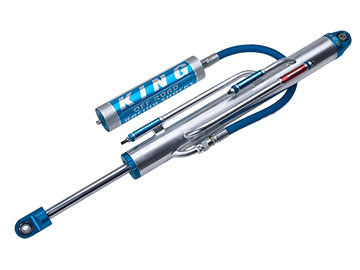

    Can someone give me a quick nutshell version of how to play with the comp adjuster? I was told setting it firmer is better for higher speeds, softer for low speed/off roading. But to me it feels stiff and I have the front/rear set to 7 clicks.

    they are mid speed adjustments so that's the speed where you want to assess your adjustments. best advice i ever heard is to back your adjustments out all the way for minimum compression (and rebound if you have it). then drive and adjust from there adding small amounts of compression & rebound independently until you start to see your truck stabilizing over the terrain you're tuning to. if you only have compression adjustment it will be more straightforward. in your case if you have excessive stiffness you may be oversprung, most trucks around here and even most running Kings are oversprung. Kings run soft out of the box so evaluate your spring rate. do you know that info?

    that's another adjustment available on bypass shocks. it sounds like you have the compression clicker so that's all you have to play with. see the bypass tubes with adjustments on each end, blue is compression and red is rebound in the pic.
