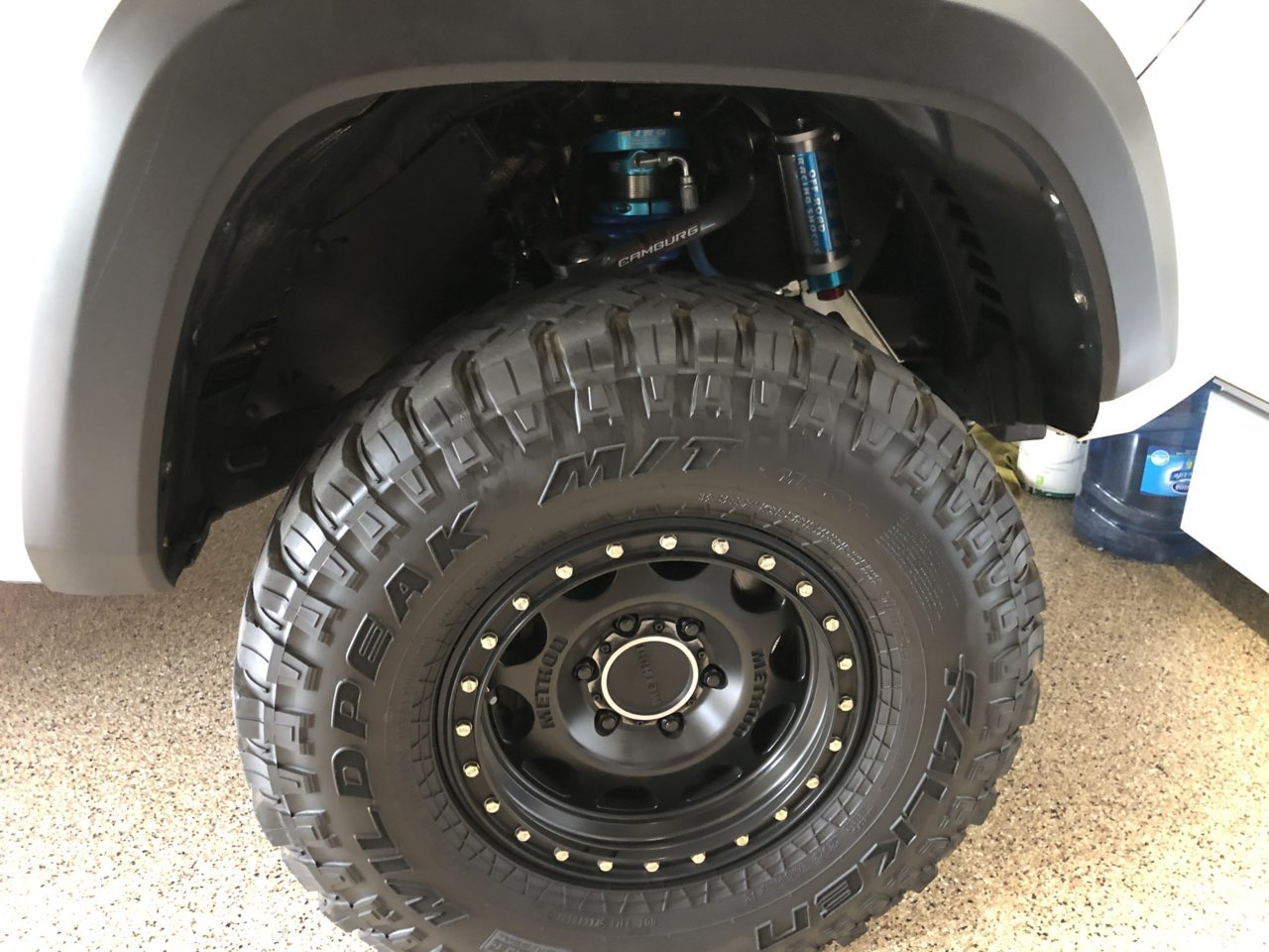

    Ive King2.5 adjuster w Camburg UCA, Deaver J66 rear leaf , 16" Method wheels, 285/75 Falken MTs tire and Timbean active bumpstops. My only complaint is that they are squeaky and noisy for being so expensive upgrades.

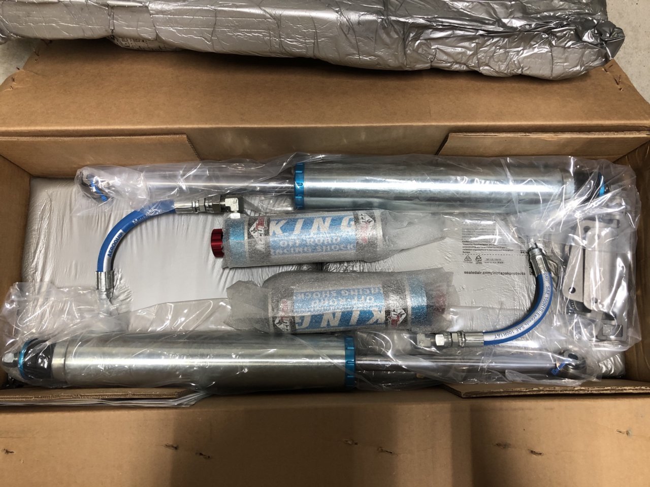

    Just received my rear shocks from Accutune. Man these things are massive, I can’t wait to get the rest in and get everything installed.
    Shout out to @AccuTune Offroad for all the help.
