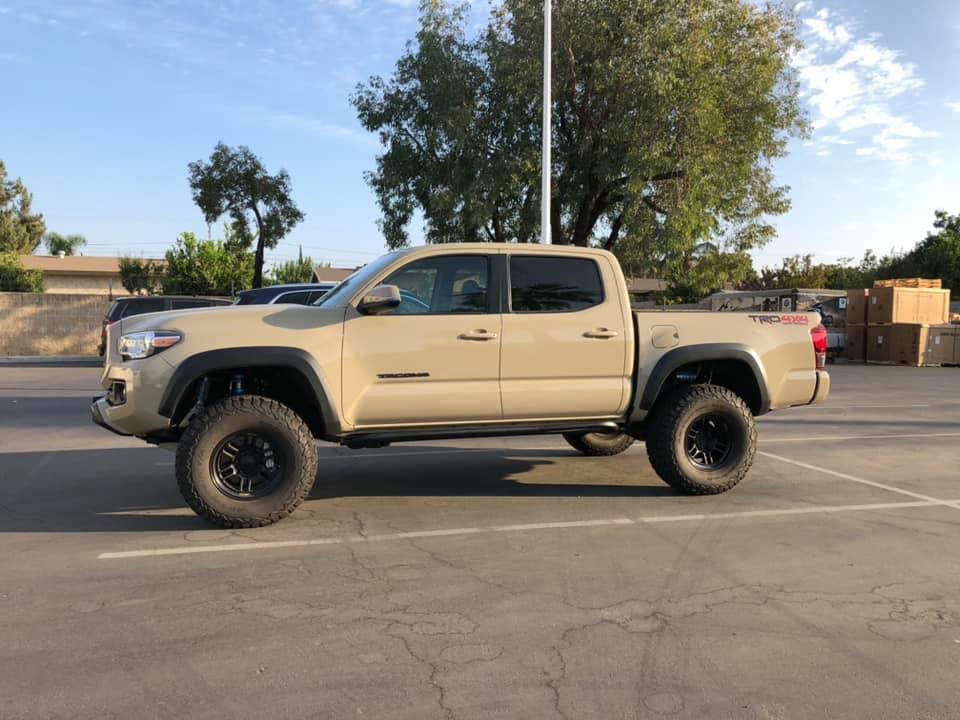

    Please HELP!
    Just finished installing Kings 2.5 Front Coilovers with Adjusters & King Rear Shocks with Adjusters, Total Chaos UCA, and ICON RXT Leaf Pack.
    Already driven for 500 miles.
    Here is my issue:
    Front Kings are adjusted to 3 inches (Installed diff drop for better cv angles)
    No problems with the front.
    Rear of Vehicle is now higher than the front, because I installed the ICON RXT Leaf Pack. Icon states (Option 1) gives 1.8 inches of lift over factory.
    What is factory rake/lift in the rear. If it’s 2 inches factory, does that make my rear lift 3.8 inches now?
    How can I make my truck level now? I don’t want that rake look.
    Sorry for the poor write up. Be kind

    Lift is measured off stock height, so you should be close to the advertised 1.8". The springs are still new and will continue to break in/compress with time. You can add some extra weight to the rear to speed up the process if you really want.
    FWIW, I have nearly the same setup as you now and I sit dead level with 2.5" of lift up front. No major extra weight, just aluminum skids and a full size spare in the bed.

    Got it, just wanted to confirm you couldn't lift the front more. You're basically at the max height we would recommend.

    First picture is Left Front
    Second picture is Right Front
    600lb springs
    This is my daily driver. No weight at all.
    No bumper. No skids, no nothing

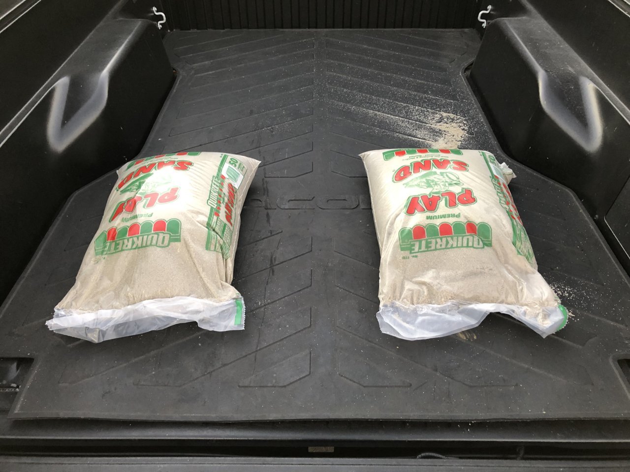

    I think I solved my problem!
    Added about 100lbs of sand to the bed and it’s level now!
    Probably will add a full size spare to keep it level long term.

    Did you remove your stock spare? And adding 100lbs of sand is not the solution I'd take after replacing my stock suspension with Kings or anything of quality.

    Yes removed stock spare. And you’re correct I don’t plan on keeping the sand in there. Just used it to estimate how much weight I need to add in the rear in order to give more of a level appearance.
