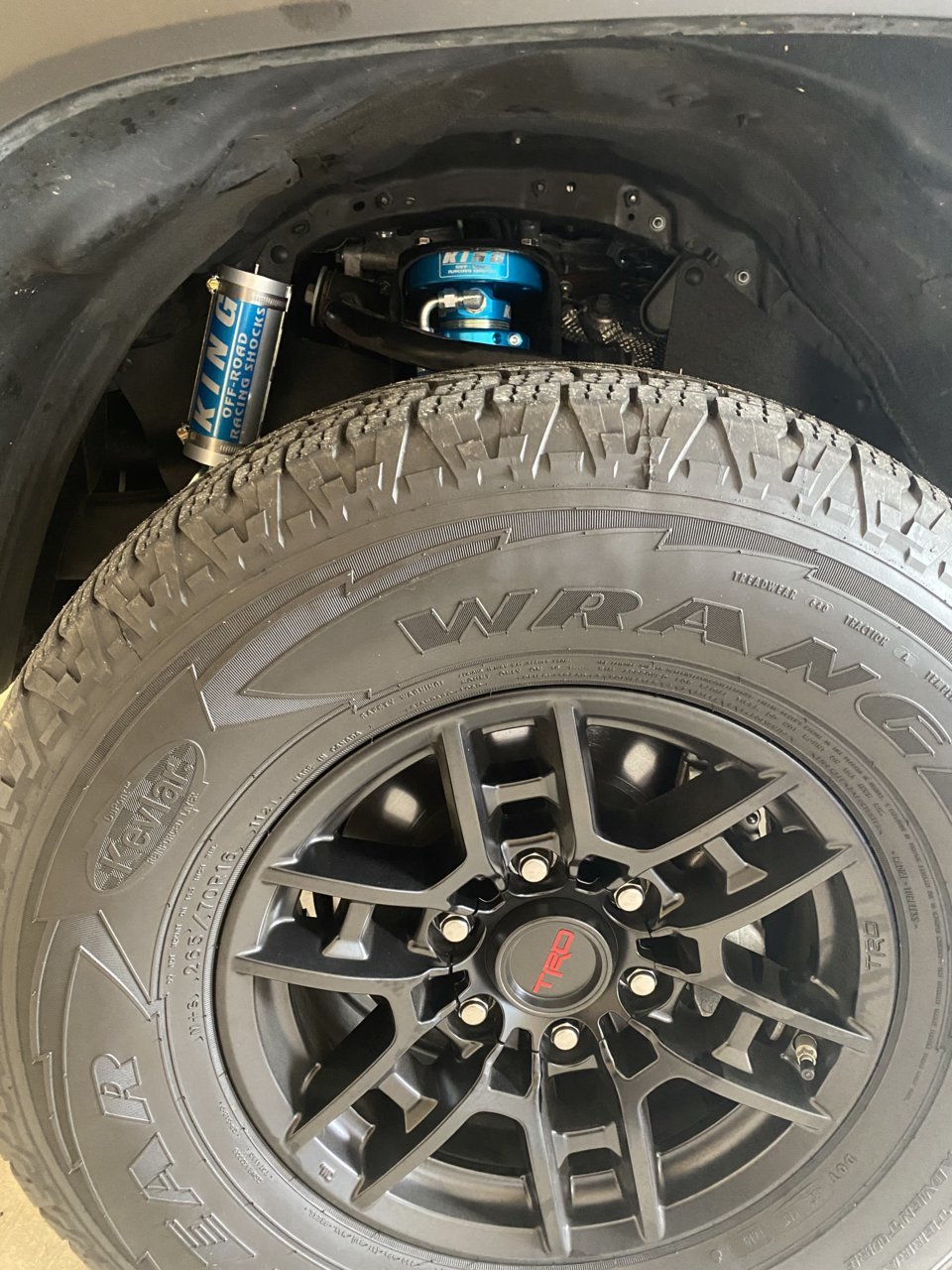

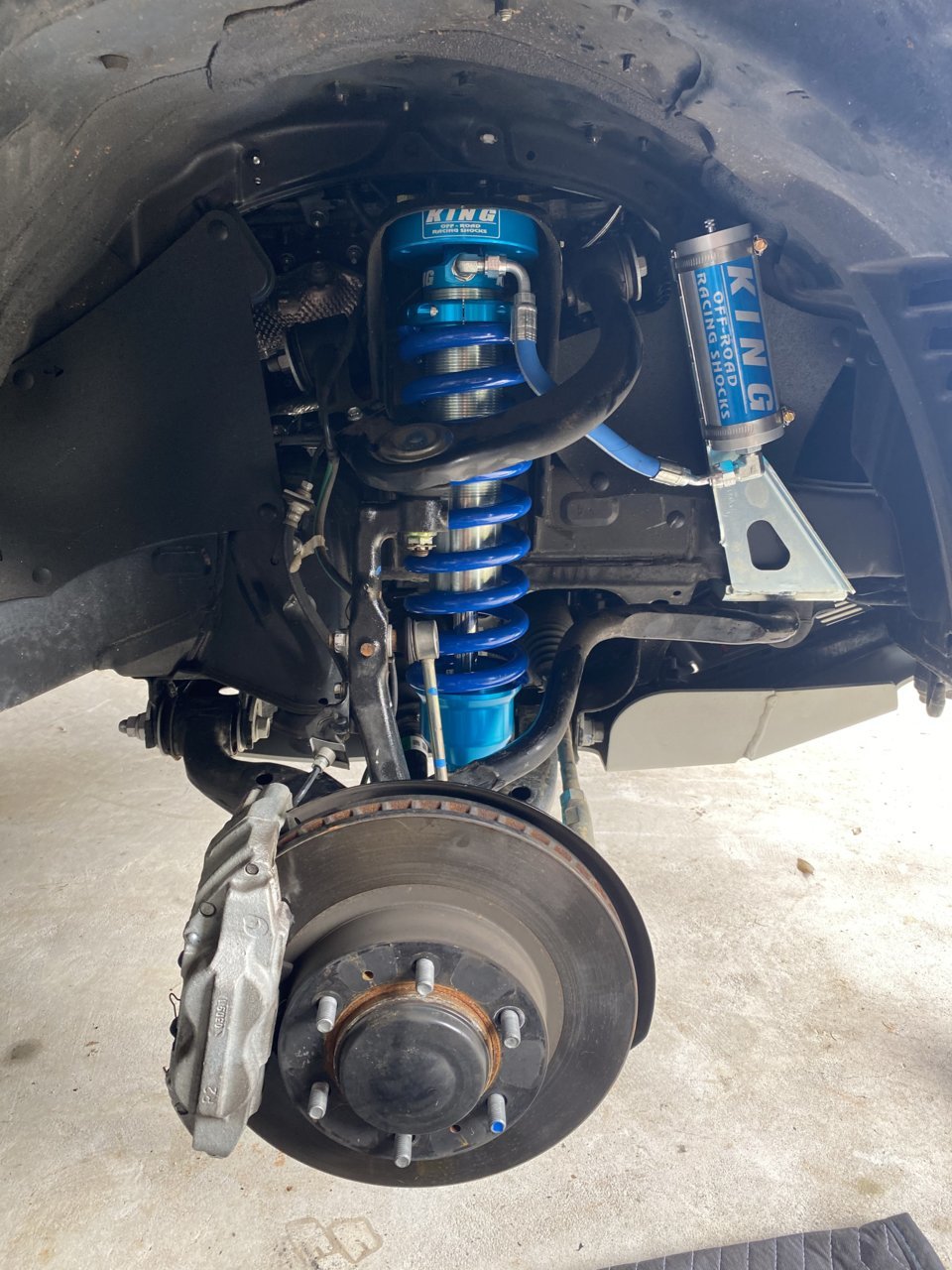

    Spent half the day tackling this install. Really need to invest in a lift for my garage. Factory King preload on stock TRD Pro wheels, UCA’s and 265/70/16 without AAL. I also bought an Icon 1.5” AAL that’ll be installed when I eventually get bigger tires. Sits pretty level so I’m happy with it. Forgot to take before measurements and will edit the post with after measurements once I take it for a drive. These things are BEEFY
    fronts and rear seem to be sitting at 21.75”

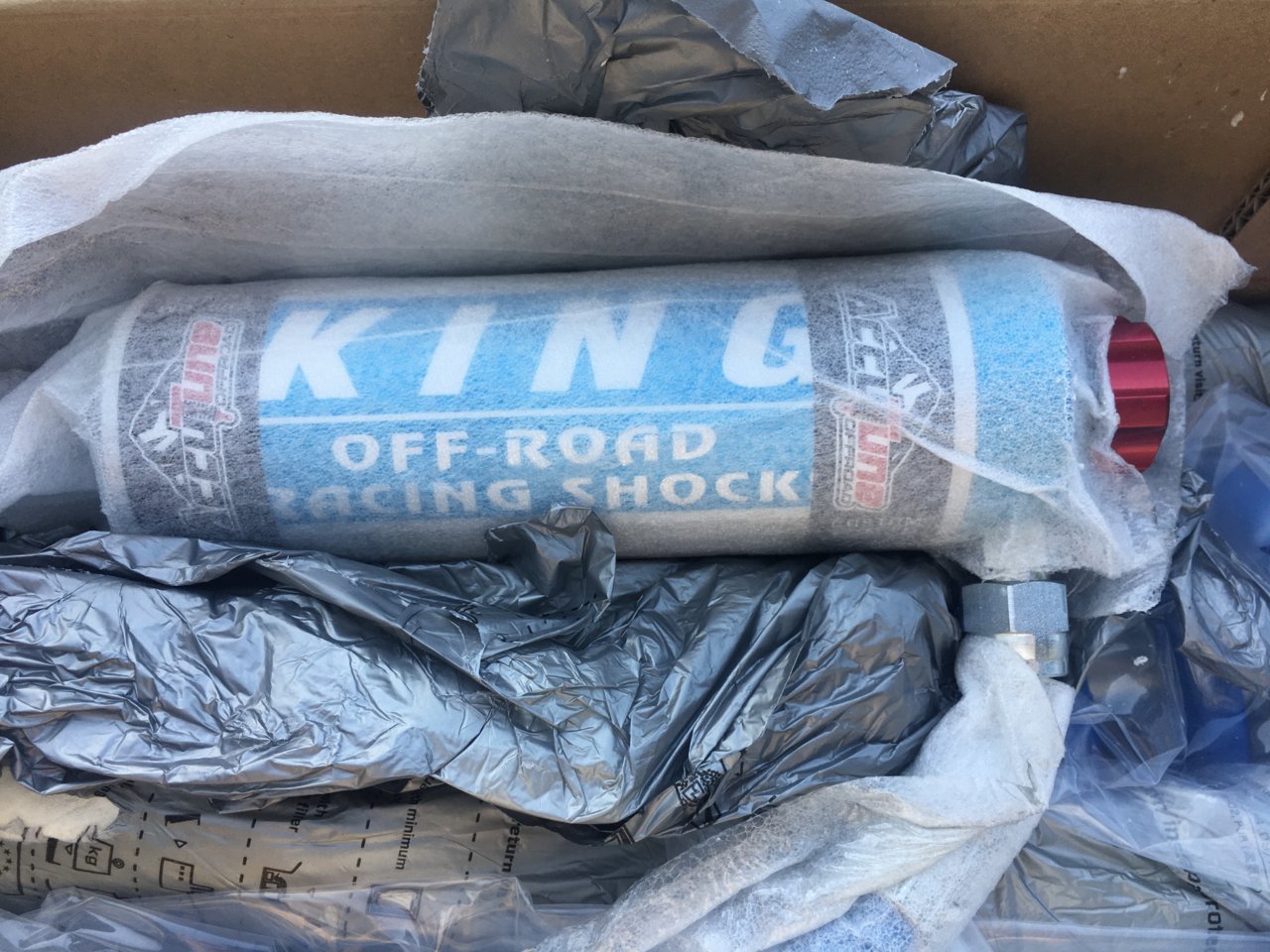

    So kings came in this morning. I got 650# ext for the front. I opened the box and took a peek. It has 4 threads on both sides. I’m assuming that’s about 2 inches of lift?

    El Cajon, CA
    BOMBS, jeremy5000, 20tacoma17 and 2 others like this.

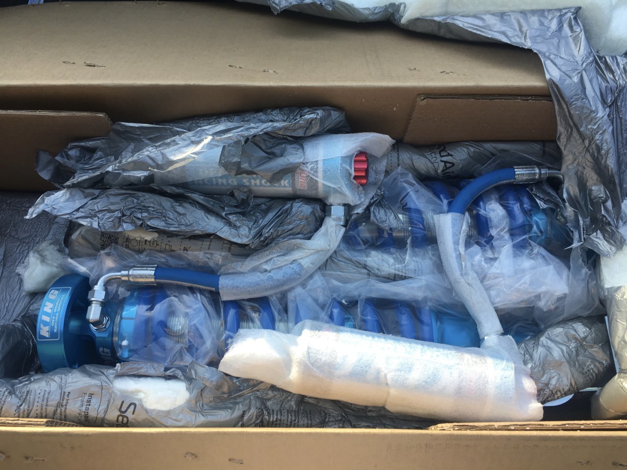

    Finally got the last piece of my King kit today. So glad the wait is finally over.

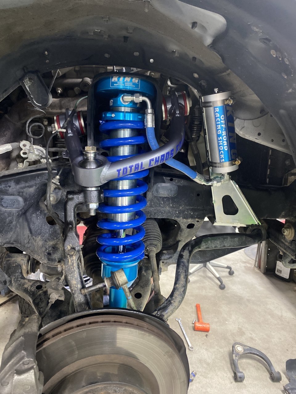

    This is my current setup, I believe I went with the 600/650lb springs whichever they come with unless getting the 700lbs. They ride decent on road, they handle sudden bumps pretty well, not as great at slower speeds. But around 40-50 bumps feel minimal. Off road they’re fantastic. My truck floats on bumpy dirt roads, up in the mountains of CO they perform well.
    Although during installation /adjustment I managed to knock a bypass bottle hose loose on my passenger side and some of the fluid came out, and I’m thinking that might have to do with some of the shortfalls I’m having with the ride comfort etc. Any of you guys experience the same thing? Was there negative effects? Should I get the fluid refilled/inspected?

    Standard Kings come with 600lb springs but you can get 650 or 700 I believe? Not sure if these are Charged units or not but many shops can recharge them if you lost pressure? If you only lost a little fluid probably nothing to worry about. If you lost a good amount then I would get them checked. Fairly new to the King world so hopefully someone with more knowledge will chime in.

    Standard spring is a 14" x 600lb, unless you chose to upgrade where ever you bought. Depending on how much oil was lost, yes I would get them topped off. This will require the shock to be pulled apart though. This will ensure they last as long as possible. If. you're ever wanting to change the ride quality, we can certainly help with that.
