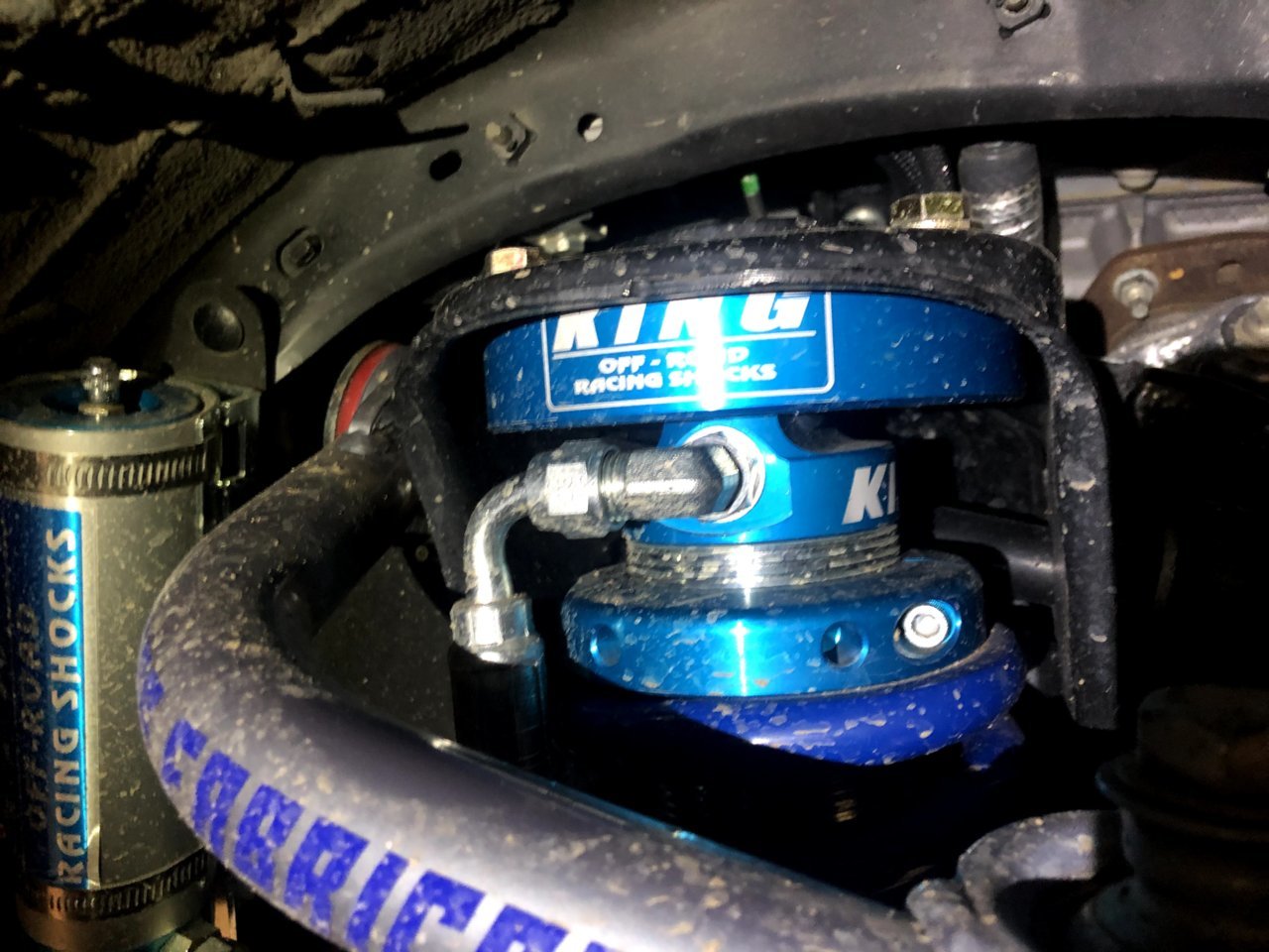

    Below is an image of my front coilover. I have about 3/8 inch of span (threads showing). I'd like to raise about another inch, but concerned with loss of travel. What have you all done.

    I too would also like to know this. Currently running 700x14 springs and mine looks the same. Came that way and yielded 2.5" lift up front over stock. With truck on level ground, uniballs on UCA are centered and axle angles don't look too crazy. Wanting to go up another 0.5" to level closer to rear rake.

    I tried it for a bit with 700 lbs coils and it still has crazy body roll at highway speeds. This was when I was commuting more and farther. Didn't matter if truck was empty or loaded. Lower offset wheels helped a little (went from +0 to -25 on 8" wide wheels). I'd recommend try at your own risk.

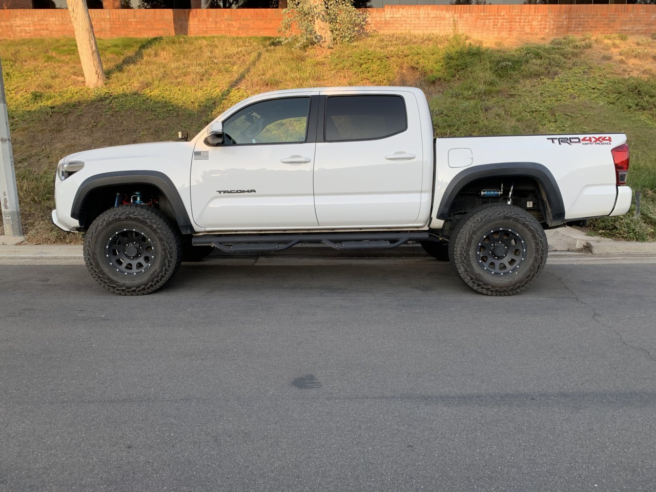

    Has anyone who’s used heavy rear leaf packs noticed a notable rake with these guys? I feel like I have at least a 1.5-2” rake goin on. Granted I’m putting a tent on the bed eventually but it’s still bugging me. Should I wait until the weights in the back before I try and get more out of the front end?

    Rake looks good! Might need bigger tires. Lol. What leaf packs are you running?

    For me to go larger I’d have to trim and regear for 35’s. That just sounds like an expensive pain right now. I just got the Dakar heavies with my setup. I’m sure they will settle down more once they have weight added to them. The front just seems low in comparison is all.

    True. Are you currently running 33s?

    They will settle. Give it some time.

    Yessir. Currently have the 285/75/16 falken at3’s goin. I honestly think the back is so high it makes them look smaller. I’d like to go 35’s but that’s a purely cosmetic jump for me and an expensive one at that.
