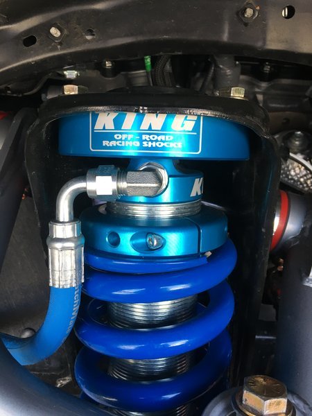

    IMG_3415.jpg Quick question guys! I installed my coilovers last weekend I slightly rub when only turning slowly. I seen on YouTube that people adjust the coilovers without removing it from the vehicle. The instructions say to remove the coilovers, adjust and than install again. I don't want to remove my coilovers if you can do it with them still on the truck. This looks like the best place to ask this question. Thanks guys appreciate it

    You should read through this thread especially while it's still short... there is some good information for you, and this question had been answered many times. The short answer is yes you can adjust the coilovers on the truck. You may want to have an alignment first though if you haven't already. Ask the tech to put in a little extra positive caster as this will eliminate the rub through the entire suspension stroke. Unless you are running 285s most people have to do some trimming regardless.

    Like Wyant said, just read through this for a lot of good info. But yes you can. But do not remove the Allen bolt all the way. That's where I messed up, the force of the spring cause the collar nut to jump a thread. Had a hell of a time fixing that. So just loosen it, and start turning (you don't have enough room as you'll find out and will need a spanner wrench or the "t-handle tool from king) and remember to lift the truck off the ground to get weight off the coilovers. Good luck :thumbsup:

    Thanks guys appreciate the info! I did all that and still wasn't able to adjust the coilover. Will need the spammer wrench

    I'm still trying to find a solution to the same problem. I ordered the King t-handle adjuster (with the bent end) and hope it will give just a little more turn on the collar to pass the hose and give access to the next collar hole. I'll let you know how it works.

    ^^ Just get a flat punch or the supplied wrench/rod, place it on the side of a hole on the collar and hit it slightly with a hammer. It should turn enough to clear the next hole for you to use the supplied wrench again to turn some more.
    It's a little tedious, but better than removing the assembly and guess at how much to turn.

    The King T-handle does the job. Hated spending $40, but I was able to get access to the collar holes and adjust the preload. I added 3 turns. Wheel to fender is 22.25", giving me 2.75" of down travel, full droop is 25"; Kings added about 0.5" more travel over stock 24.5". I'm going to run this for awhile - the truck sits level. Getting an alignment on Friday. Still running all setting at full soft.
