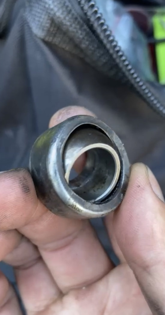

    got mine fixed up yesterday too - something so soothing about not hearing this incessant squeaking while i drive. Also just drives much smoother now (maybe its in my head)

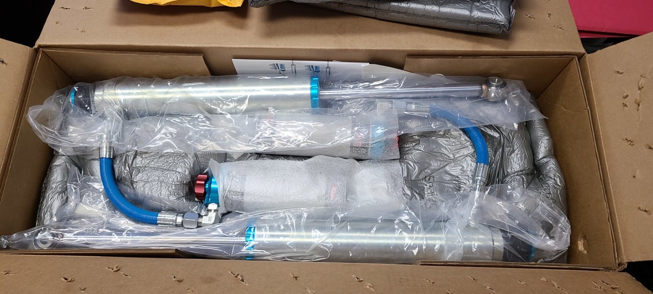

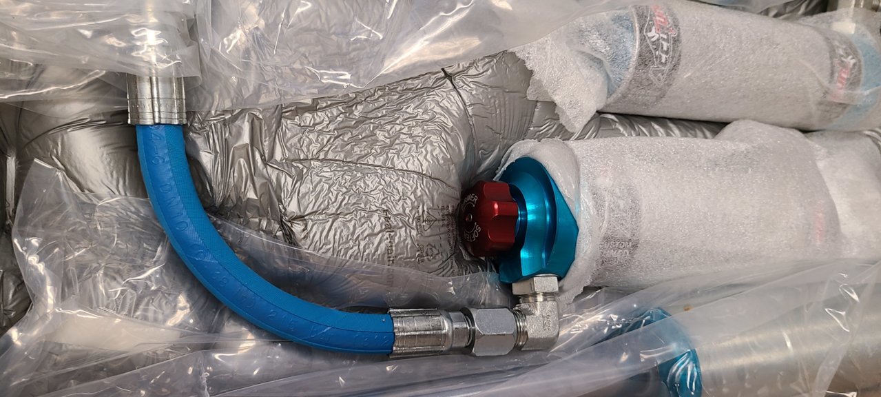

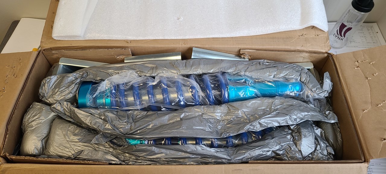

    After months and months of waiting... the time of greatness is approaching. Thanks @AccuTune Offroad
    Mmmmmm... clickers...

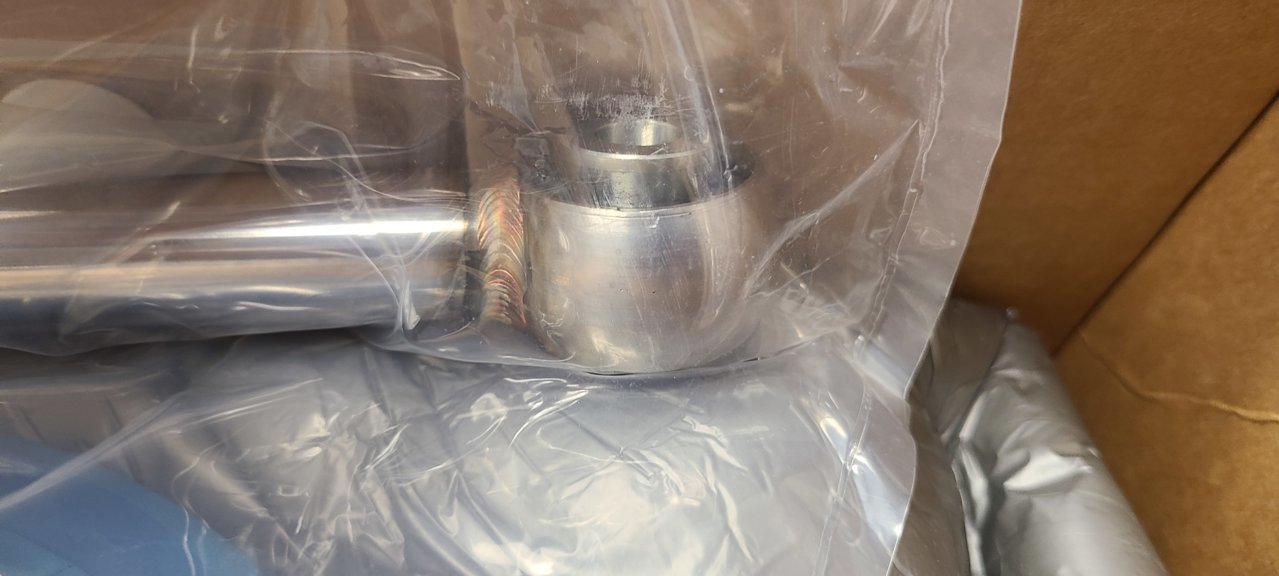

    Also, a little different with non-aluminum lower eyelet...

    tundra shocks have welded on lowers

    Yeah, I wonder what the logic is with that... I actually prefer it this way.

    Pure speculation - I bet they cut down a shaft they have for another application and weld the end on, instead of building a new shock shaft for limited applications/sales.

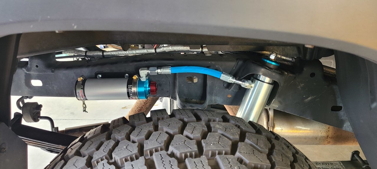

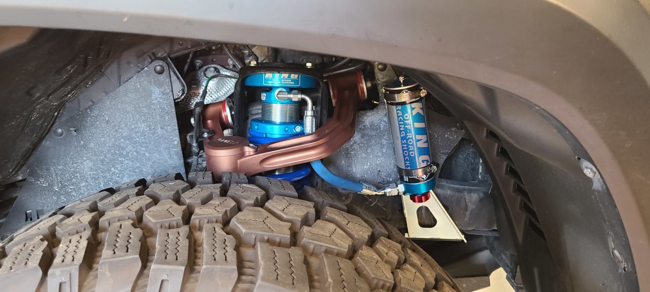

    Installed some King shocks that were tuned by @AccuTune Offroad. First impressions, I'm very impressed. However, I'll get some more miles on them before I form a complete opinion.

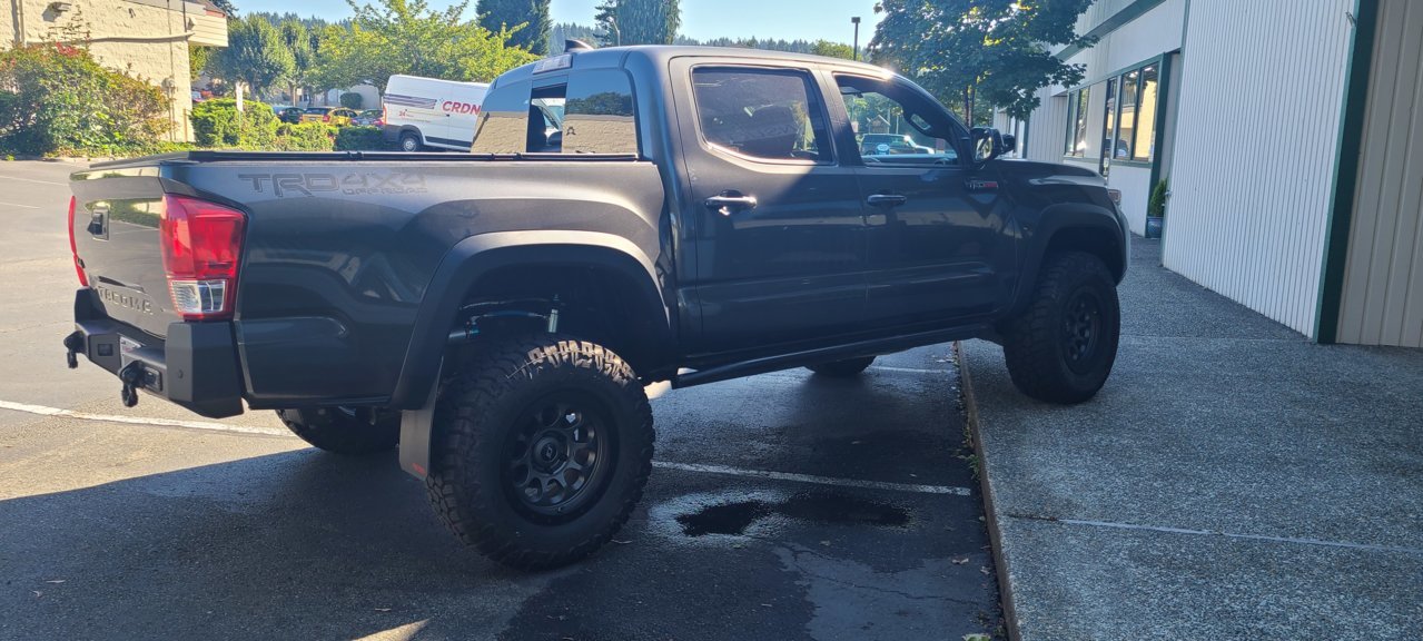

    Buyer beware! There's one unintended consequence of installing this suspension...
    No curbs are safe!

    just going to post this over in the ahole parking thread :rofl:

    Fortunately, it's my office (on a Saturday), so they know I'm an asshole...
