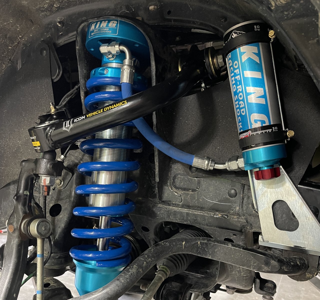

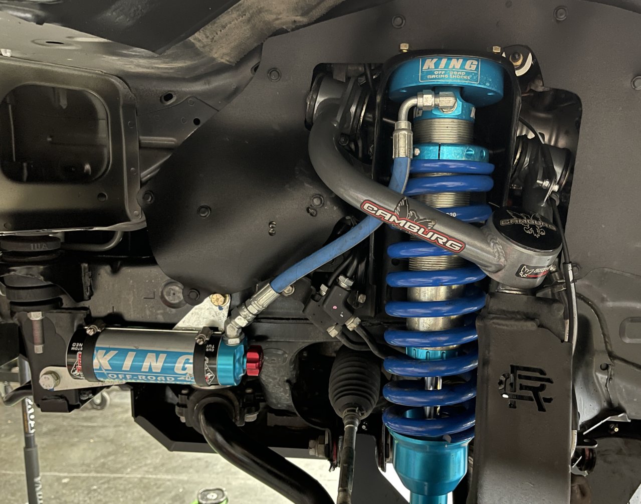

    Anyone out here knows If a 5th Gen 4 Runner Front Kings Suspension with adjusters fits a 3rd Gen Tacoma? Thanks
  18. Nov 10, 2021 at 3:40 PM
    #3018
    a2lowvw
    a2lowvw Well-Known Member
    Jan 12, 2021
    #352533
    1,965

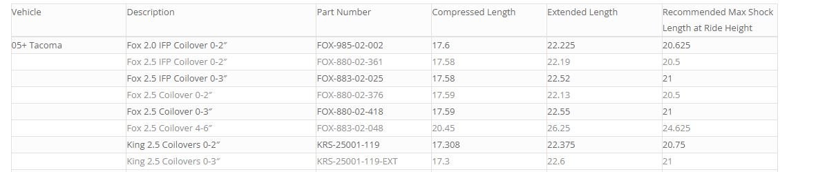

    Justin
    Bothell, Wa
    2019 DCSB Limited
    Stuff and things
    If you simply follow the max length at ride height guidelines you are in pretty good hands. The only real exception is when your weight exceeds the springs and you have more than 1 1/2 inches of threads exposed, then you enter spring bind territory
    Bertw192 and AccuTune Offroad like this.
  19. Nov 10, 2021 at 4:14 PM
    #3019
    AccuTune Offroad
    AccuTune Offroad Well-Known Member Vendor
    Jan 28, 2019
    #281012
    1,656
    El Cajon, CA
    Hey that chart looks familiar!
    Main difference is the reservoir mounting brackets and hose routing. Can it be made to work, sure, but you will need to get the bracket and have the hose fittings changed around.

    I swear I have posted it with that link countless times.
