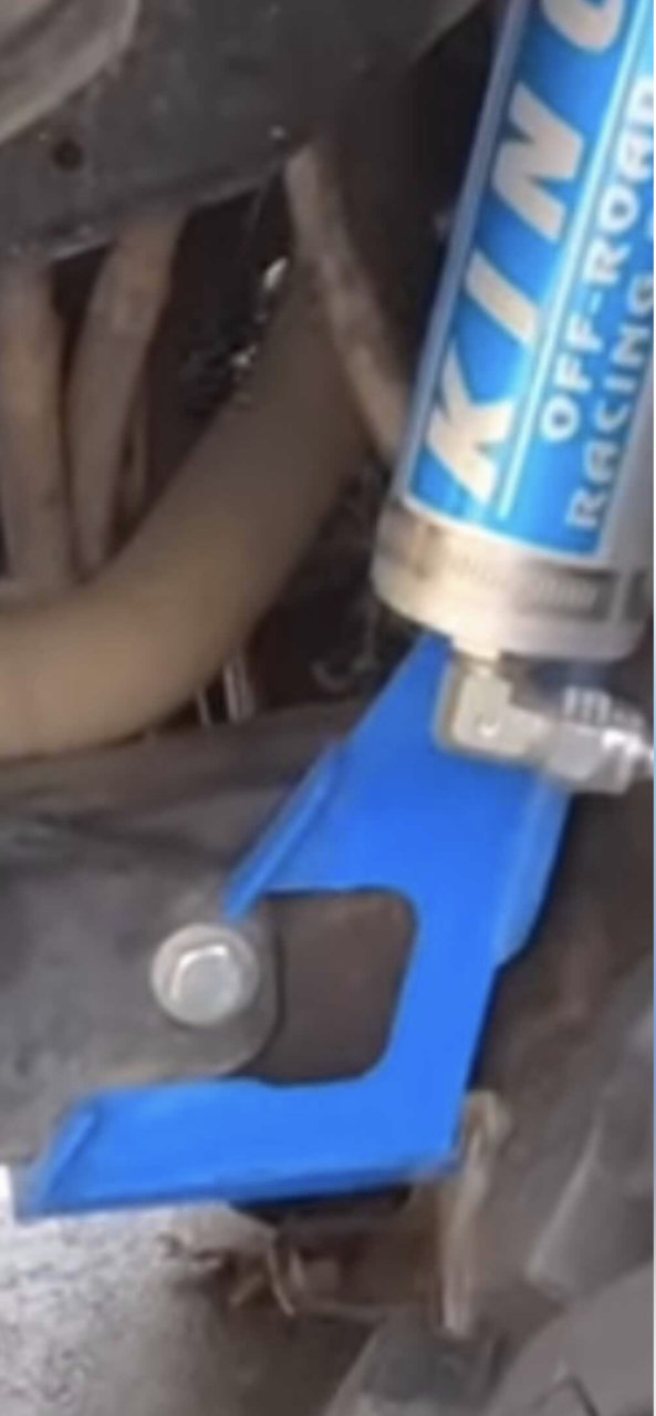

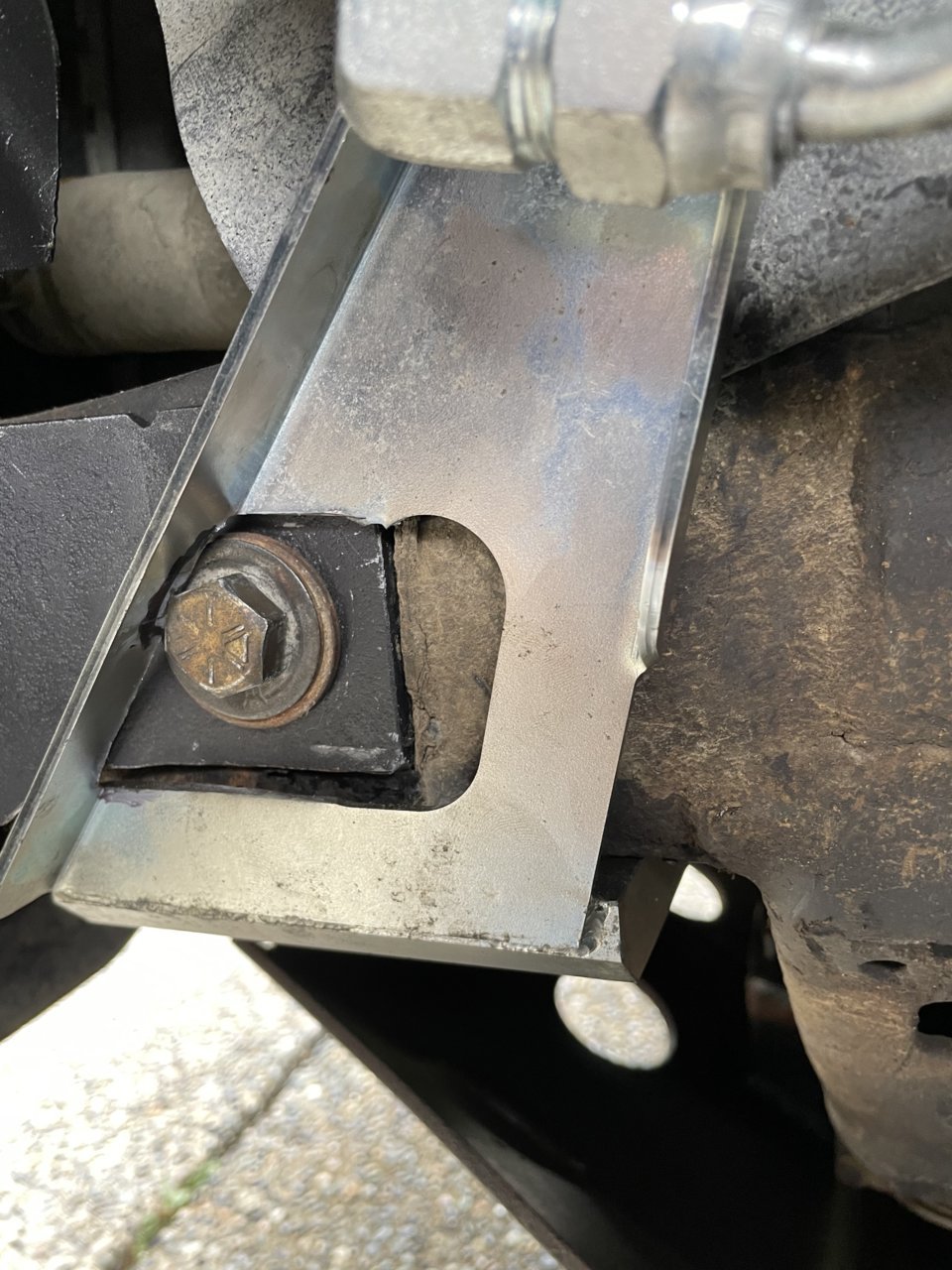

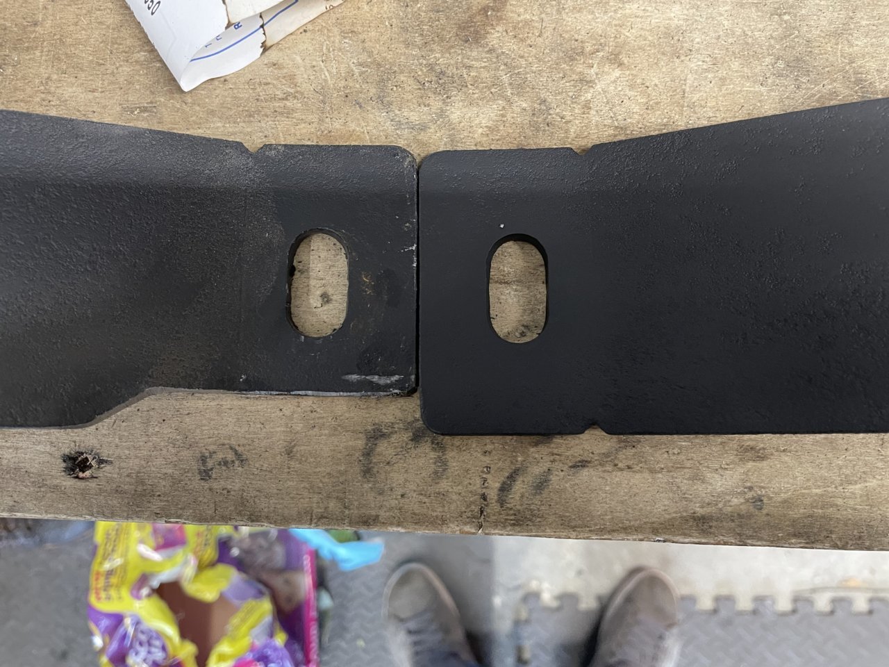

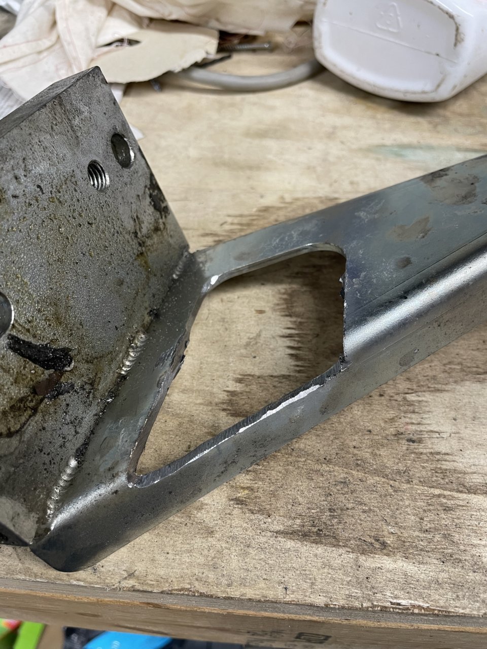

    Bumper Frame supports vs Kings res holder.
    So I can’t be the only one who’s run across this issue. I tried search a while ago, best I could find was some poor cuts made, as well others advised to beat the 90 flat and drill it. 1st photo what I’ve seen online, next photos what i did.
    It’ll help someone, maybe not everyone.

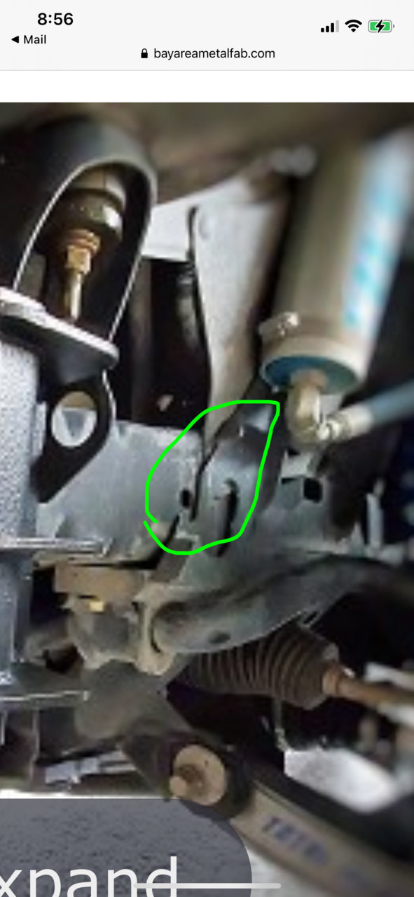

    Or... I think the BAMF bumper braces may work without modification.
    https://www.bayareametalfab.com/FBR...inforcement-brackets-2005-to-2022-_p_142.html

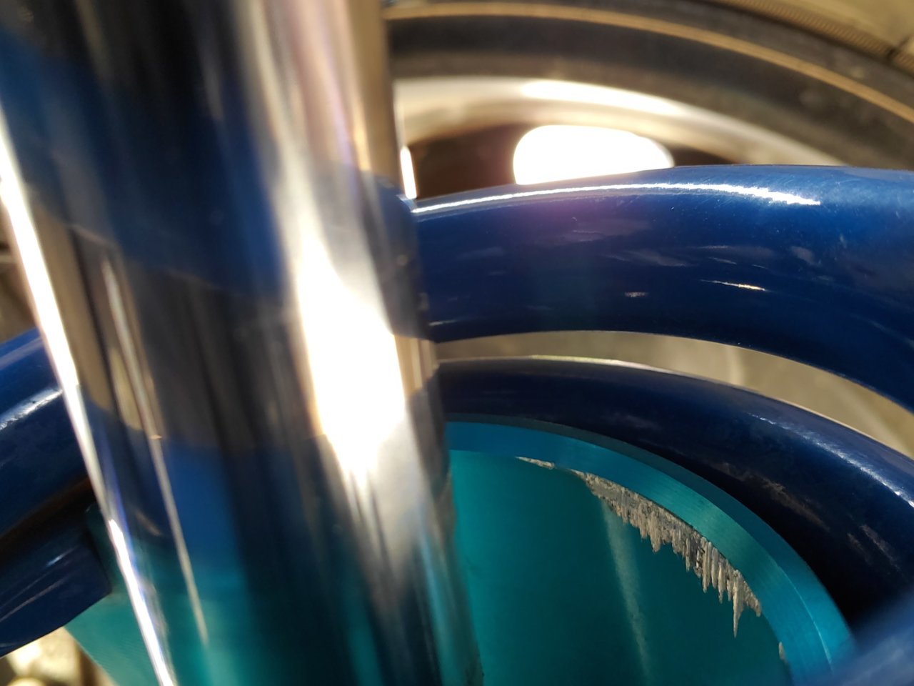

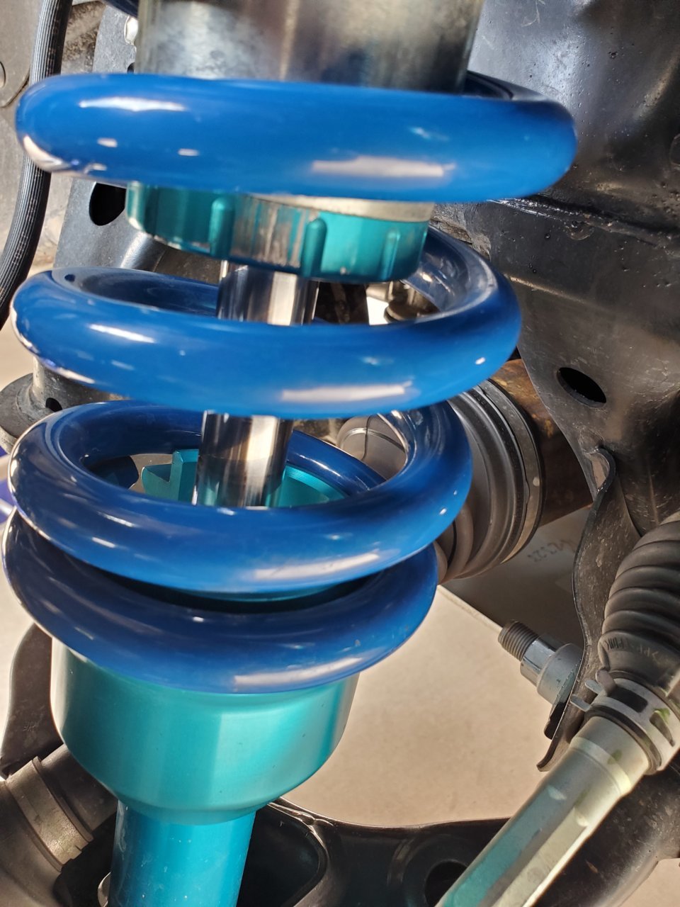

    After much searching of the interwebs... I could not find anyone else having the same issue I have discovered. Behold...
    From what I can see, nothing looks out of whack. The scuffs say otherwise. I sent a plethora of pics to accutune and had a convo over the phone about it. They are checking into it to see if they give some ideas about what is going on or what happened. Anyone else see this before? Collar isn't cross threaded and the lower spring perch appears to be seated properly.

    Accutune was great and gave me some pointers on where to start, even though all they had to go off of was pictures and a couple conversations. I took it to a local off road shop for their input in person, and since they had the right spring compressors, tools, etc. This shop has experience with King, Fox, etc.
    One concern observed was how the end of the coil on the bottom, was positioned right over the opening of the lower perch. It was suspected that may be causing the spring to bow. The threaded collar was not cross threaded. Initially that was a possible issue as well. My bad for trying to adjust pre load w/ out using a spring compressor, and not paying attention to the spring and perch spinning and where they ended up. The weird thing is, there were no issues until I started backing off pre load. I had cranked it up too much initially. Lesson learned.
    The local shop rotated the coil spring 180. After getting it back on the truck and romping around a bit over the weekend, it looks like we got it figured out. I will keep you all posted if it shows up again. Just figured I would throw all this out there, I surely have never seen it before, and many others haven't either.
