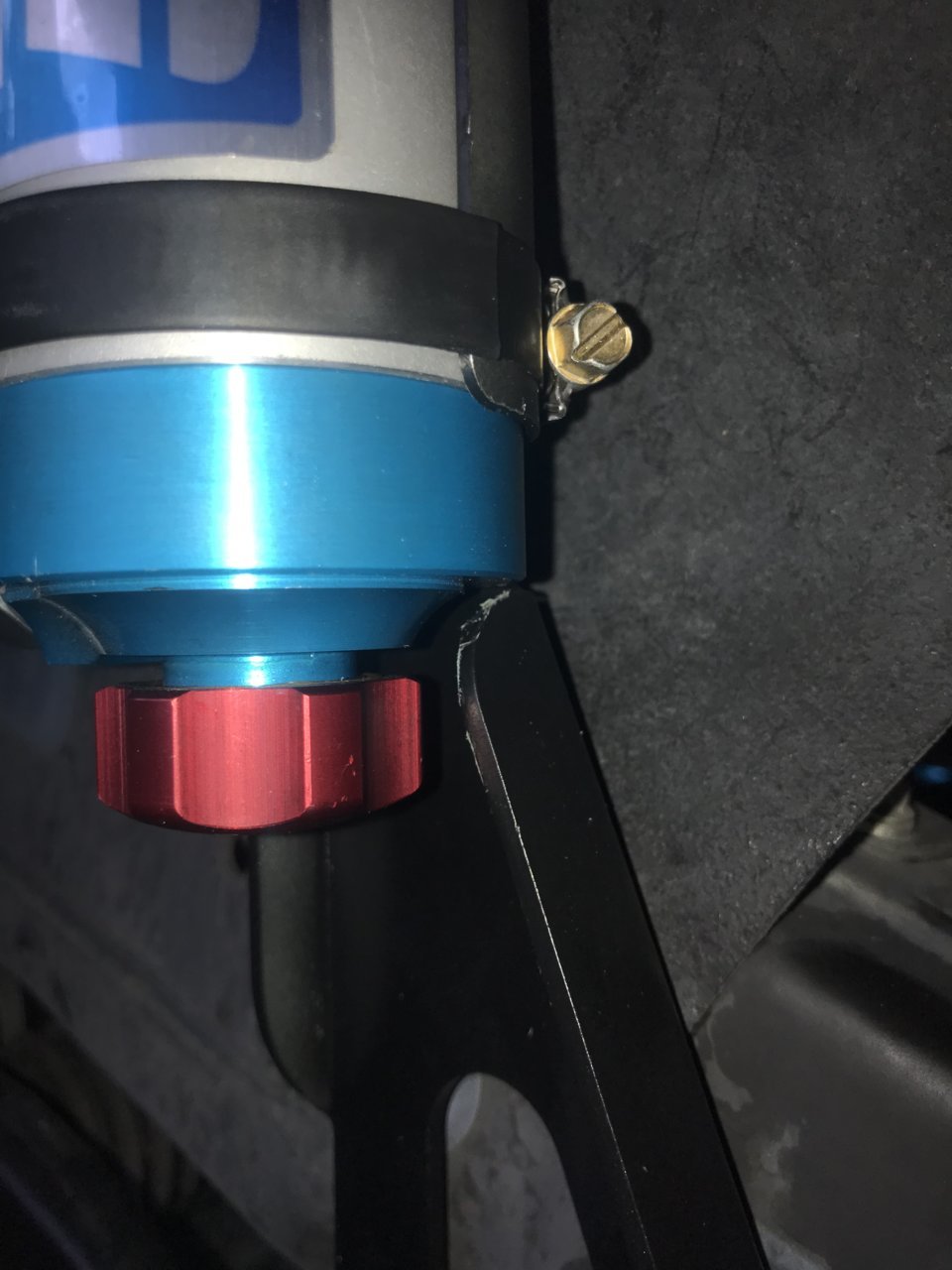

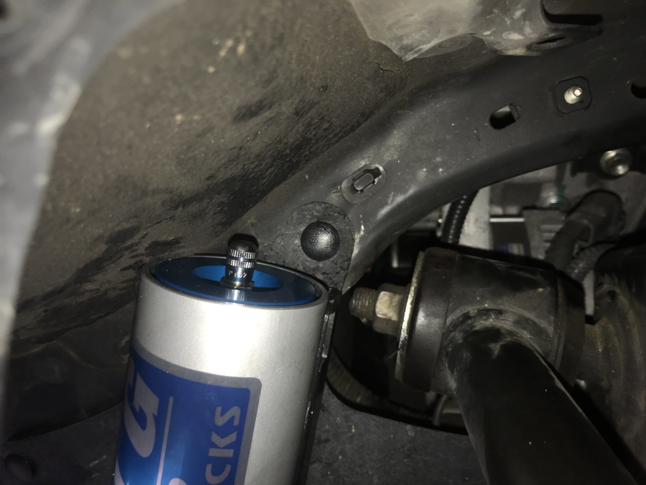

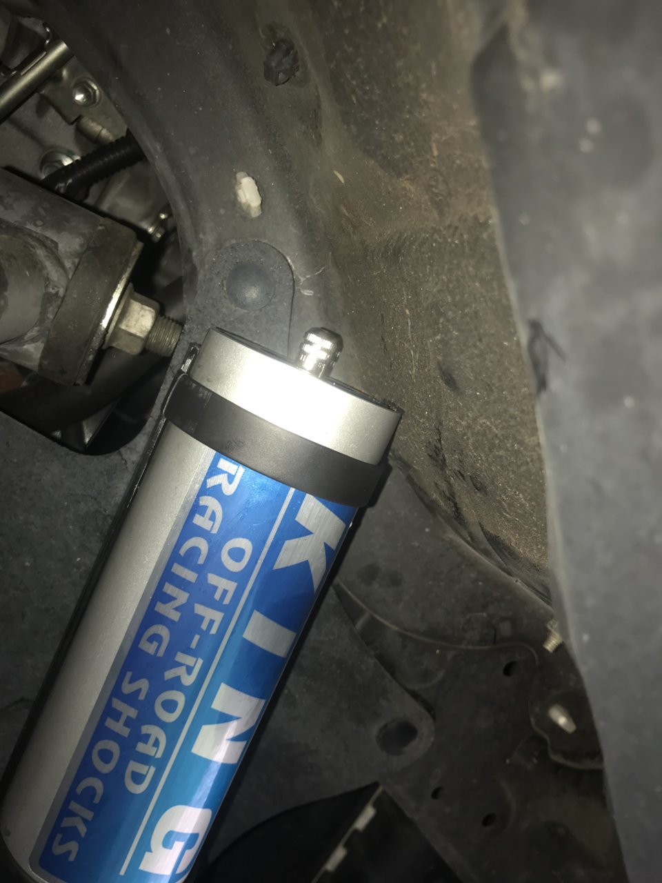

    Mine are the exact same way. They contact the wheel well. Not a big deal. I bent the brackets slightly. I can get all my clamps on no problem so not sure what’s stopping yours

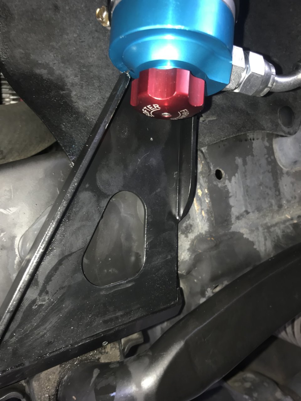

    The reservoir is at an angle in the bracket with a gap at the top. I can’t lower the reservoir anymore and can’t push it in any further at the top. The clamp is too short.
    I have a set of energy radiator bushings coming Thursday. If that doesn’t get me the clearance, I’m going to have to grind/cut off a little of the bent support rib on the reservoir holder so I can drop the reservoir lower.
    Just worried about damaging the reservoir in between now and then - They’re mounted to the rigid frame and coming in contact with the wheel well which flexes with the body on bumps.
