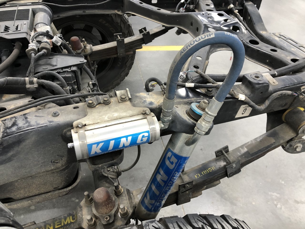

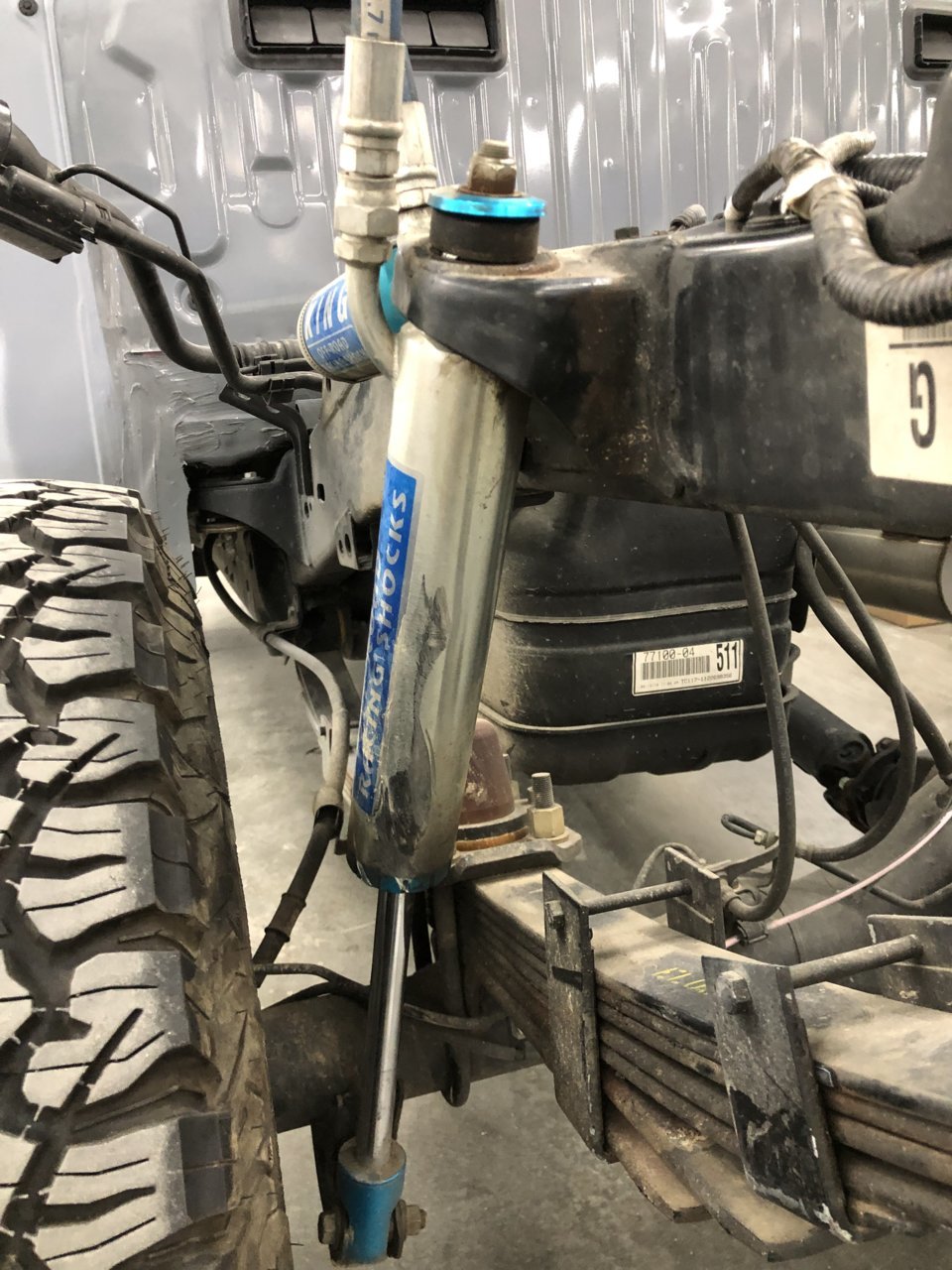

    I just bought my Tacoma and it had king shocks on the back. I was rear ended and damaged one. Having a hard time figuring out what ones they are and locating any. The rear end also has OME leaf springs. Part number EL095RDB59A4BB-E0BC-48E8-BDD7-6C484DE39AB1.jpg738F92E3-D0FF-48D4-9FD8-FF48F32817AD.jpg

    If you email us some better photos of the damage, we can get an idea on if its repairable. Unfortunately that rear shock design/style (standard Tacoma rear shock) has been discontinued and only sold in pairs, so your best bet at the moment would be to see if it can be repaired. Unless you are wanting to buy two new rear shocks. Sales@accutuneoffroad.com

    I was planning on getting a new set. Are the newer ones in stock? Most seem to be sold out from what I’m looking at.

    All of our Tacoma rear Kings are in stock. Send over a message with some more details on your truck and lift height and we can help ya out.
