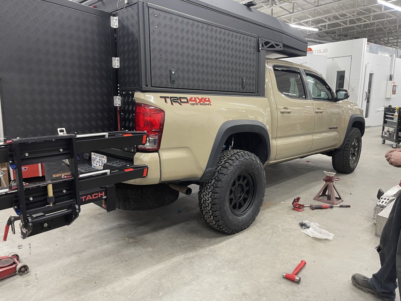

    That’s a fairly wide tire, my first thought is the 0 offset wheel, and trying a set of spacers. Is it rubbing super bad, or just touching it a little?

    As you can see from the photo it is pretty mild but have not taken it to the dirt to fully test

    Is that rub on your sway bar too? And is it only the one side?

    Both sides are rubbing. That is just a smudge from the install I believe

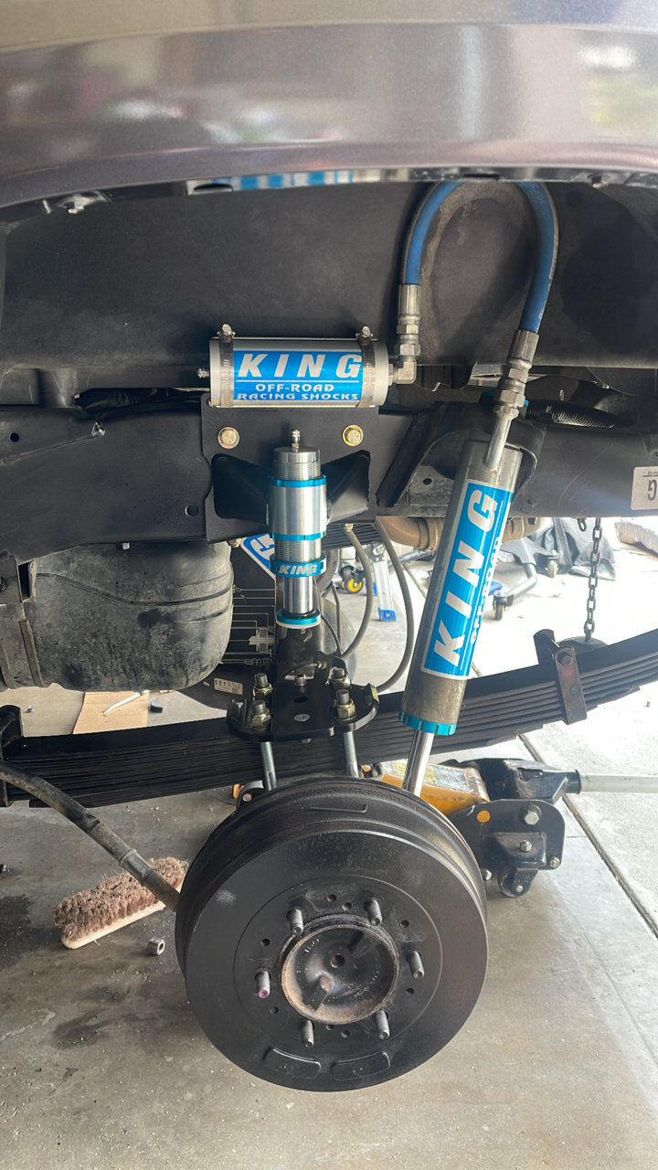

    Are you ordering through Accutune? I just had my King 4A suspension installed 2 weeks back. I went with the Tundra rears to gain an extra inch of travel (also availability). They custom tune them to work with the Tacoma, I love the ride quality.

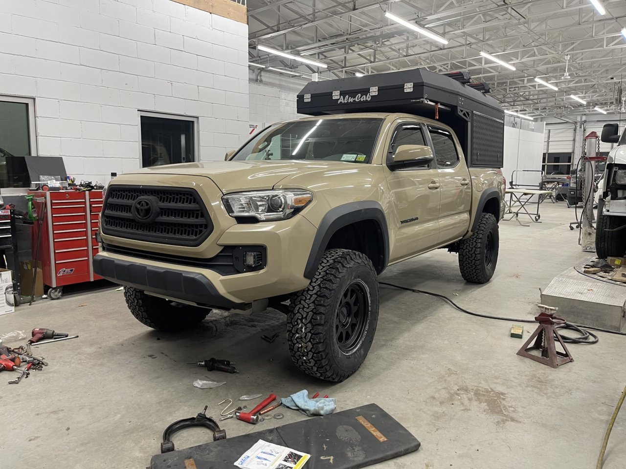

    Installed the rears today. Magically the rear shocks showed up this morning. Hey not complaining. Anyone wanna save me 161 pages worth of reading and tell me how many threads on the coilovers for 2.5” of lift lol :fingerscrossed:

    It's all going to depend on spring rate and weight on front. I have the 2.5 ext front with 600lb springs and about 70 extra lbs of weight on the front. Running 9 on passenger and 11 on drivers. Getting about 2-3/8 lift in front.

    Awesome thanks. I got 650s and have probably the same but got them in anticipation of a winch. Just wanna get close in the spring compressor and I’ll fine tune after I get it on its feet

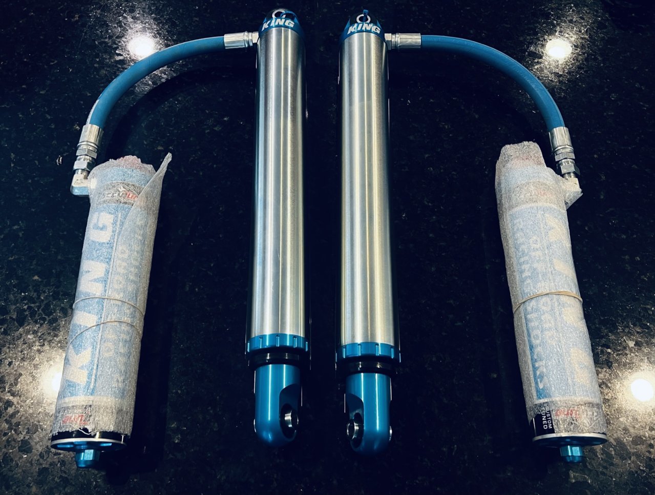

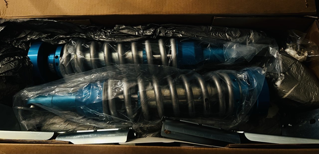

    @AccuTune Offroad Super impressed with the ordering process, customer service and ship time. I ordered and these showed up in less than a week. Actually kind of jacked me up, I was planning on two or three weeks shipping for install, now I am scrambling to install like this weekend (prob not :)).

    Silver coils? Since when?

    option from us, not from King.
