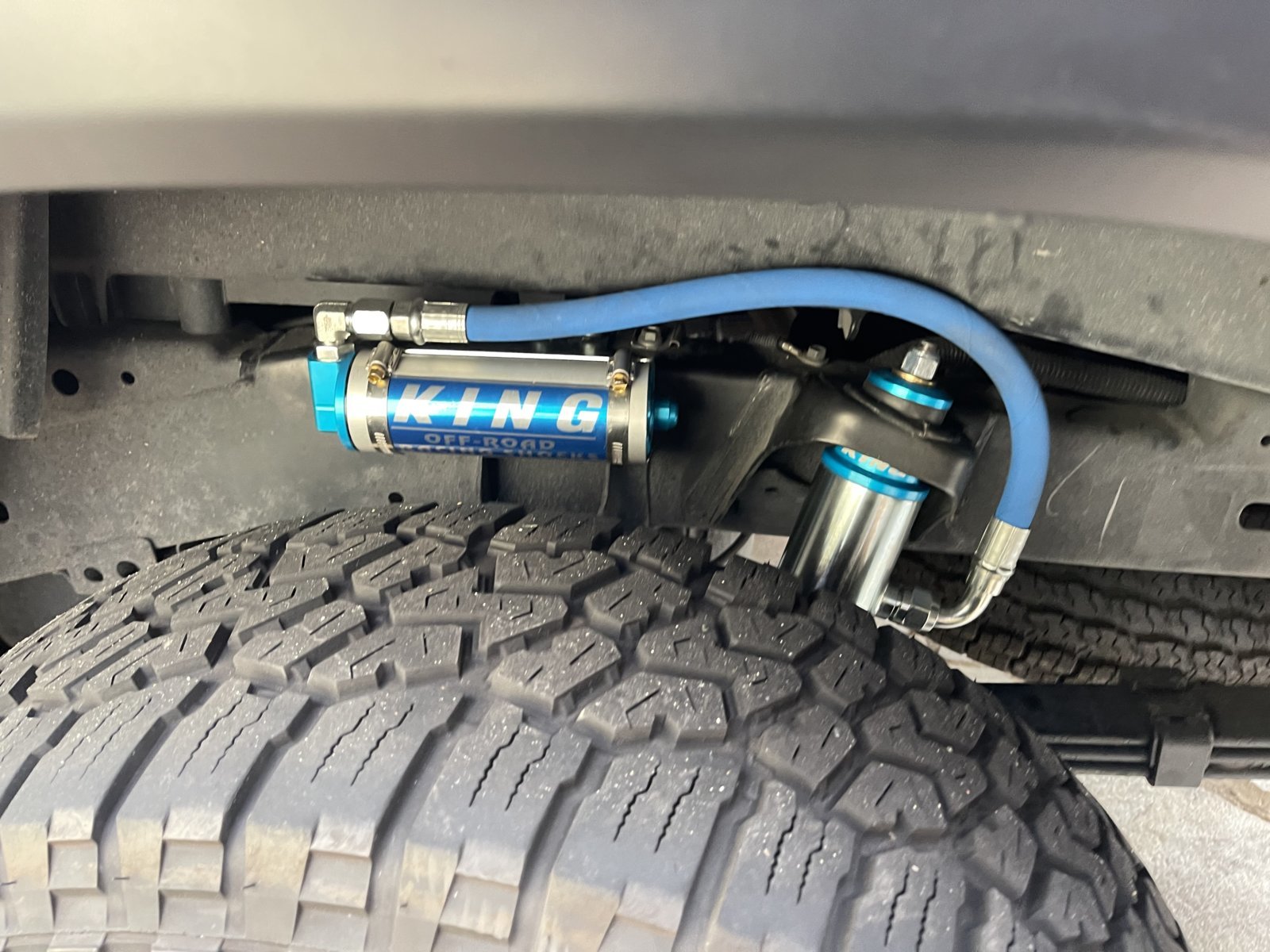

    Accutune stage 4 with adjustable King 2.5's. Icon RXT installed in configuration #1. Added 4 turns to preload. Roughly 2" gained.

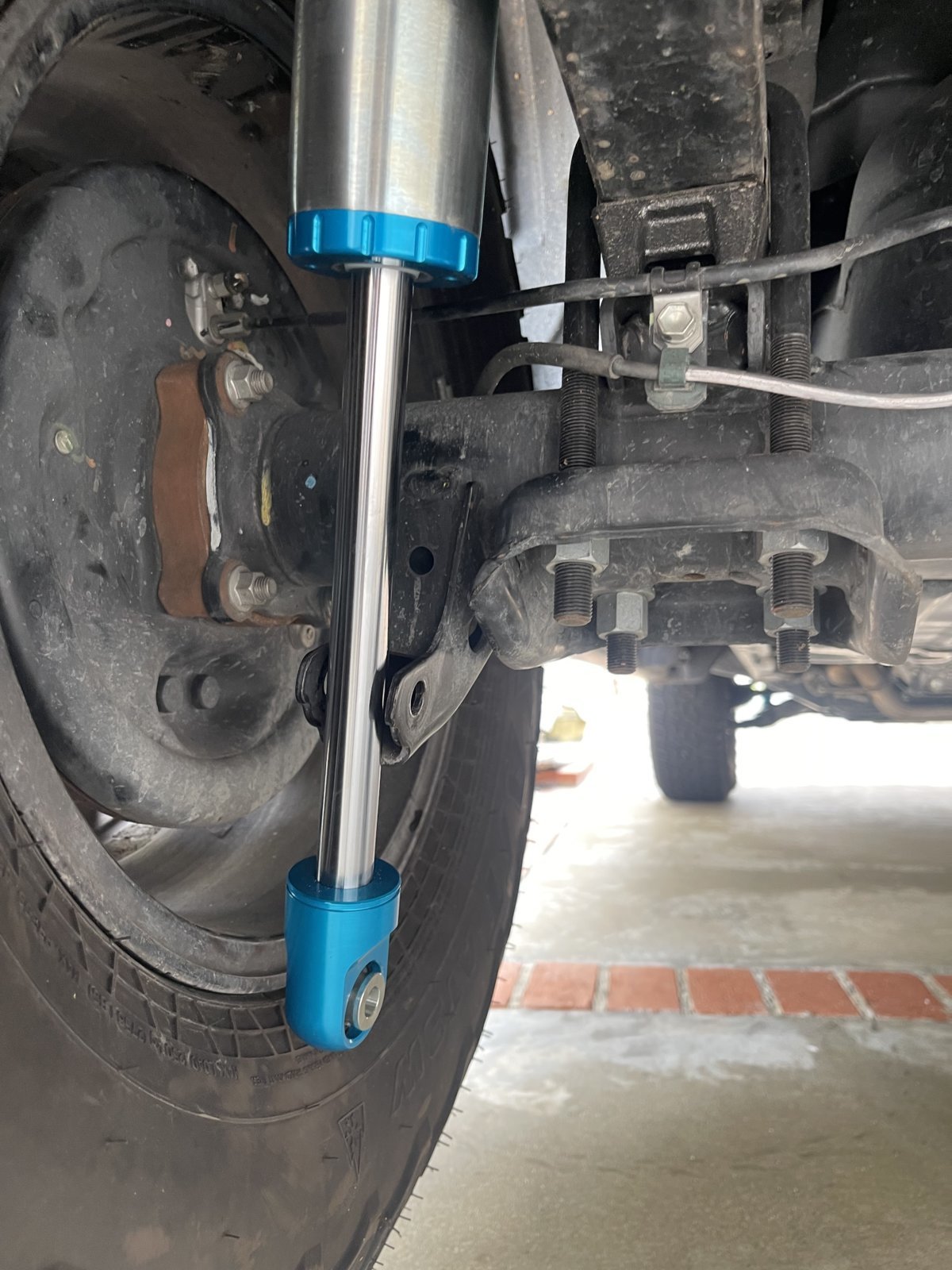

    Any tips to mount this? Seems like the rear shocks are ext but they’re not based on the part numbers.

    Lift the truck with a floor jack until the rear axle begins to hang or lift the rear axle with a floor jack. :notsure:

    Are you installing these with the truck on the ground???? :anonymous:

    no I just lowered it but it’s good now both are installed and ready. Coming off 5100s the rod was a couple inches shorter didn’t have this problem.

    Part number and shock design has changed a bit. Long story short, there is no -EXT option anymore. The one and only length King offers matches what the -EXT shock lengths were.
