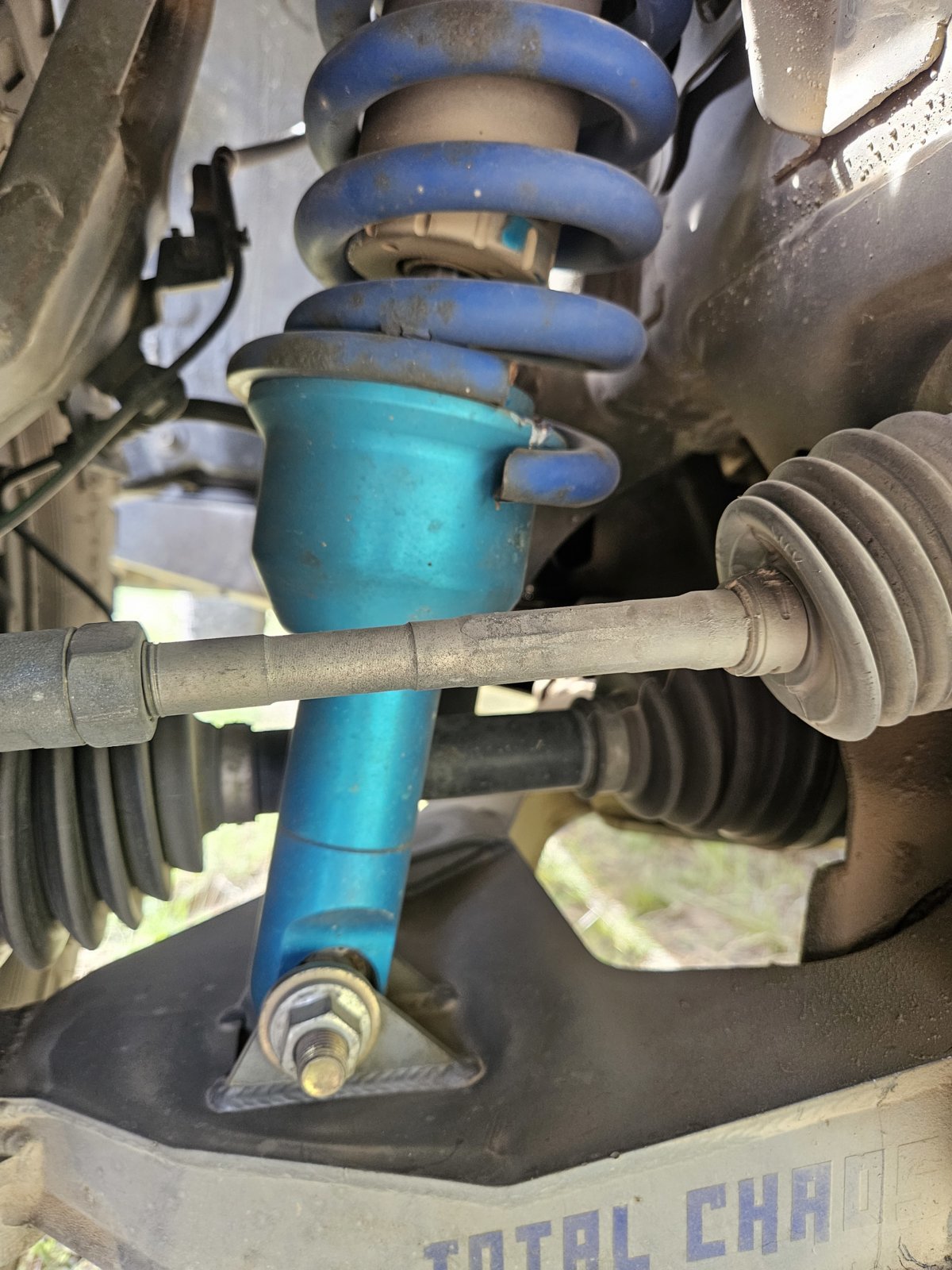

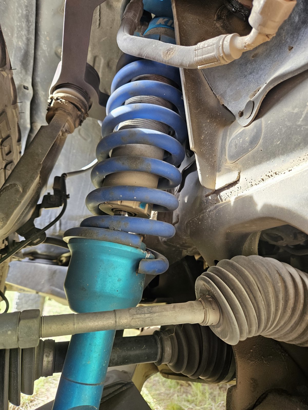

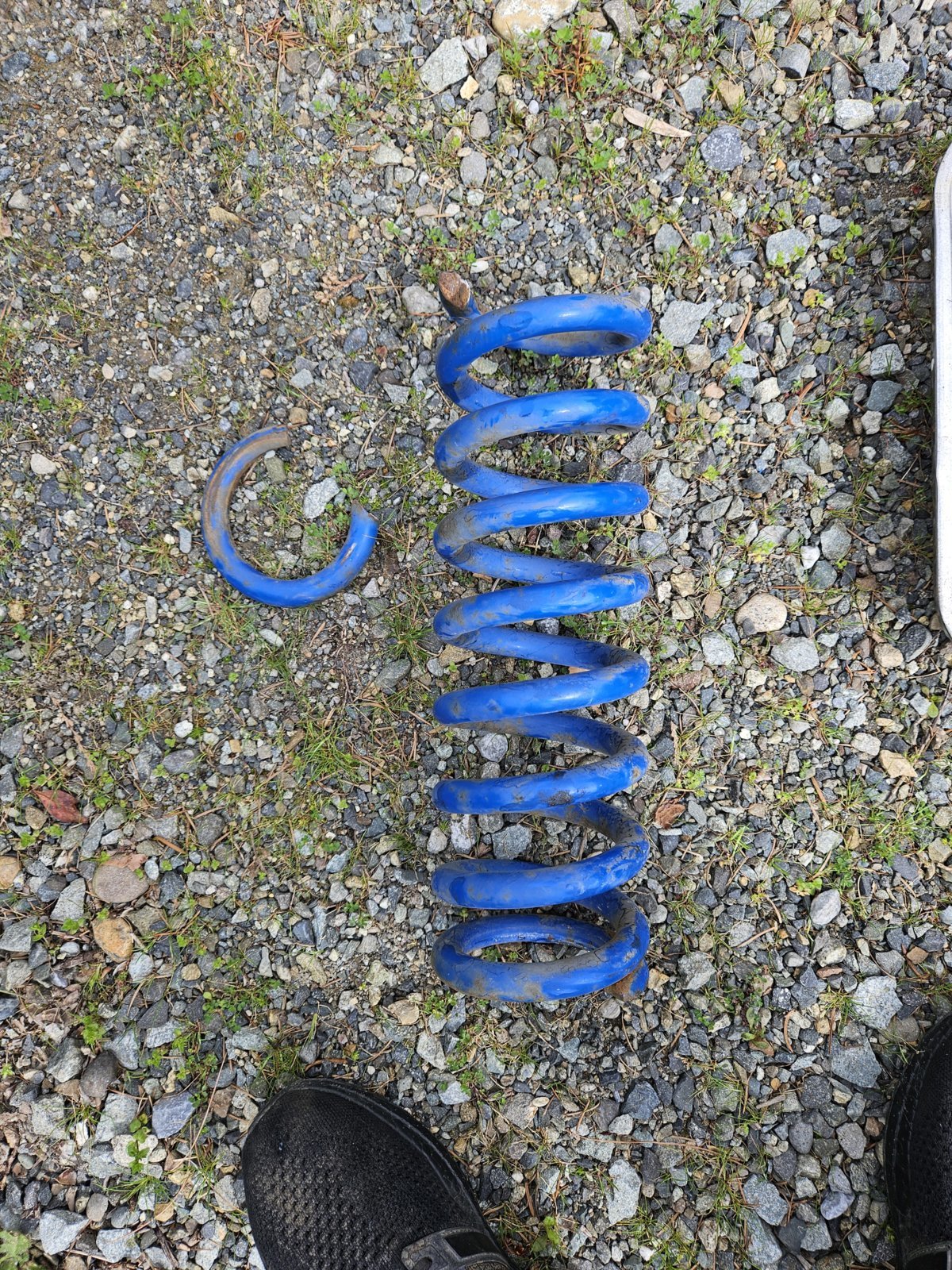

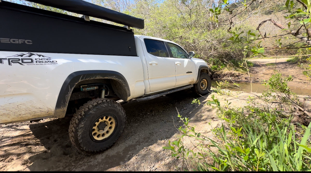

    Doing the most innocuous offroading in some sand, I had my passenger coil snap.
    Not sure what caused it, but it's pretty disappointing when I don't live in the rust belt and I'm pretty gentle on my truck. I'm a trail turtle, so I know it's not from abuse.
    @AccuTune Offroad how quickly can I get a set of replacements? I want to switch to 650's anyways, as I intend to install a hybrid bumper soon.

    2 years in the PNW and springs had a failure. Any thoughts from you how this could be? Any warranty from AT or King?

    There could be a few things going on, hard to say without diving deeper into the issue. Too much preload & coil bind are my first thoughts. Unfortunately I don't think this would fall under a manufacture defect. Its hard to prove the springs were not misused etc.

    I really don't want to jump in here but there is no fast silliness in WA, no rust, and bumps spaced for the lift and LCAs.
    Why pay the price, or for that fact trust them if actually going silly in the desert?
    No hate, just wondering.

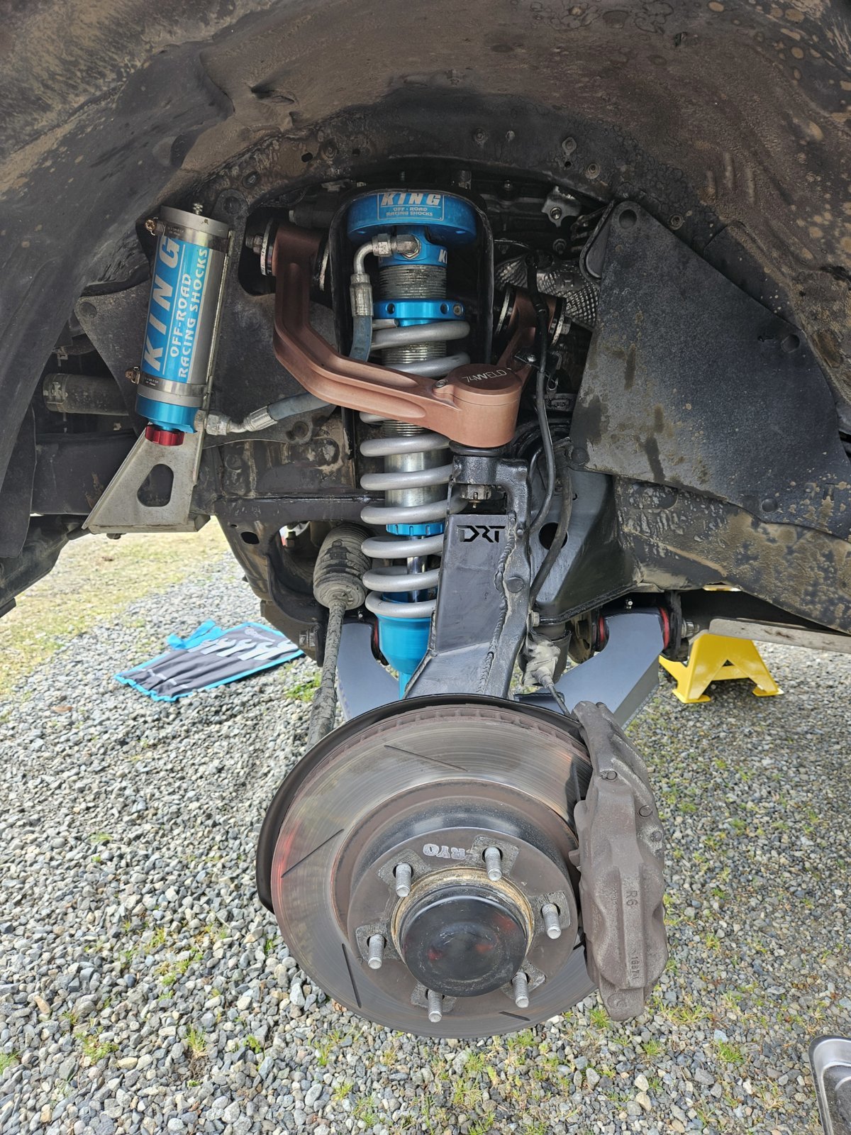

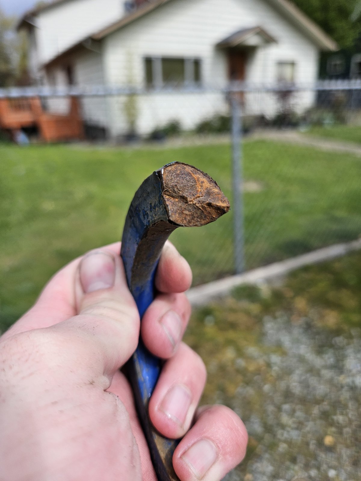

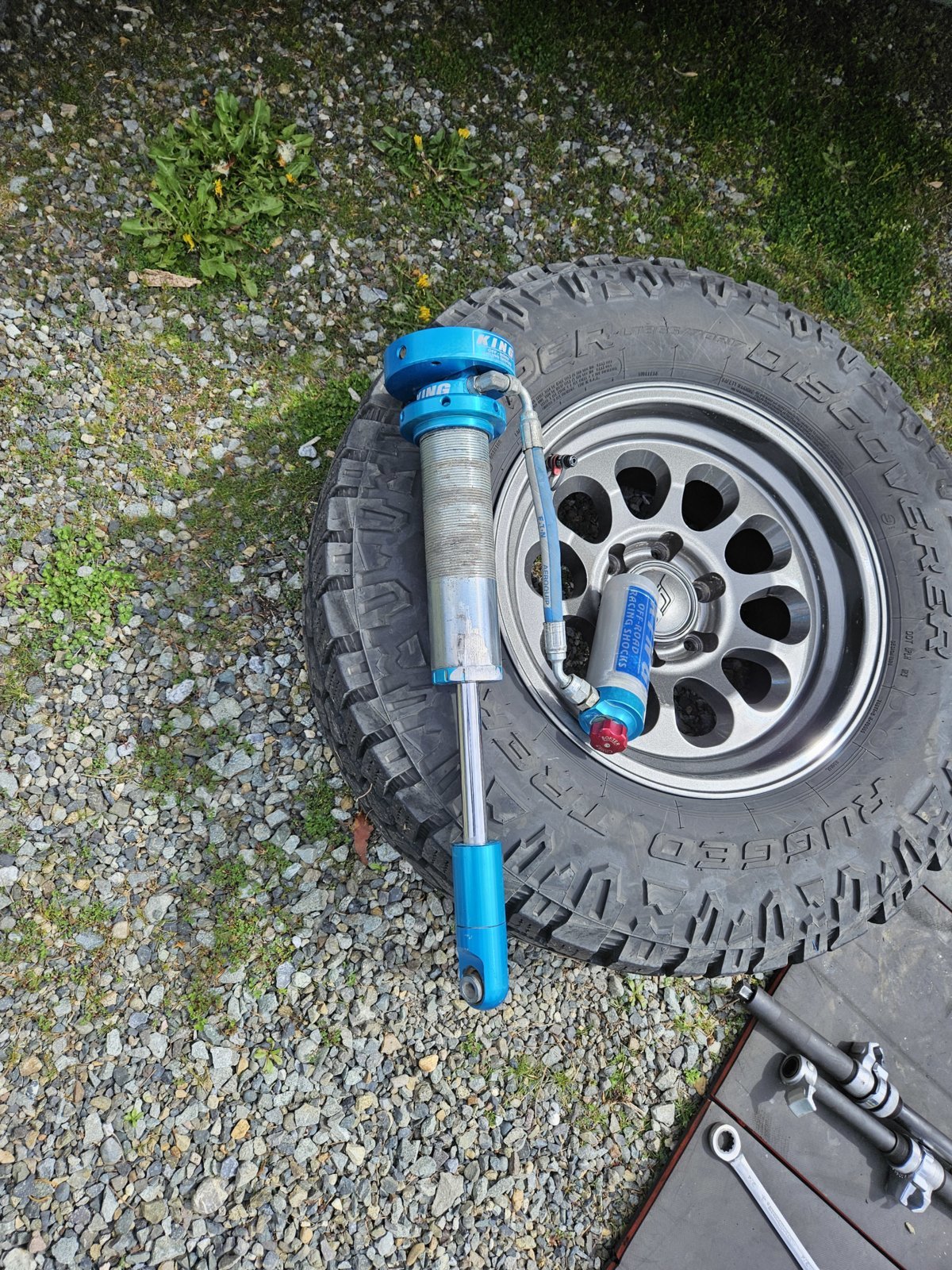

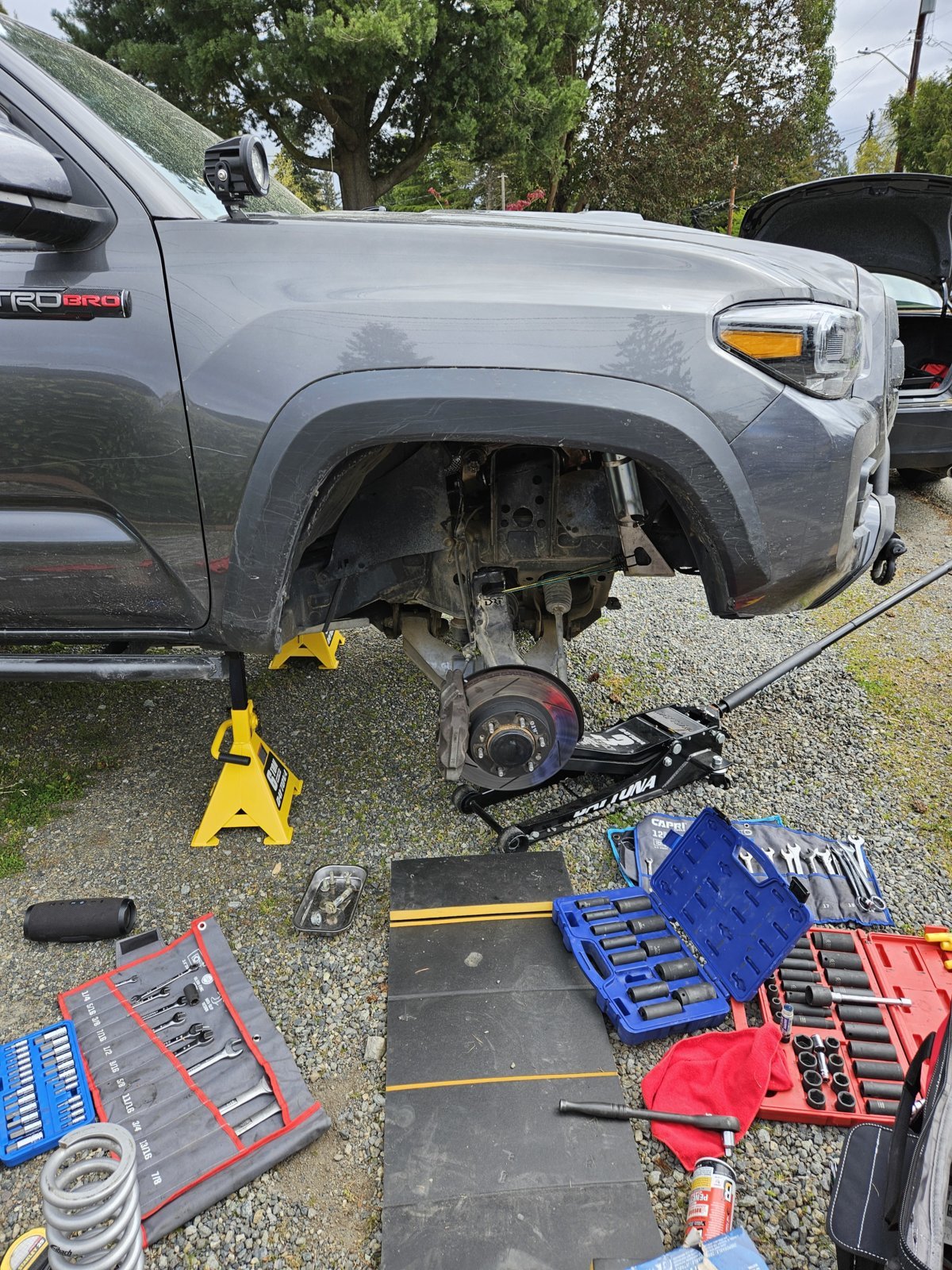

    20240415_121448.jpg 20240415_121454.jpg 20240415_121604.jpg 20240415_121612.jpg 20240415_121618.jpg 20240415_121655.jpg 20240415_130438.jpg 20240415_143549.jpg
    All repaired... still need to adjust the new ride height and get an alignment, buts she's rolling.

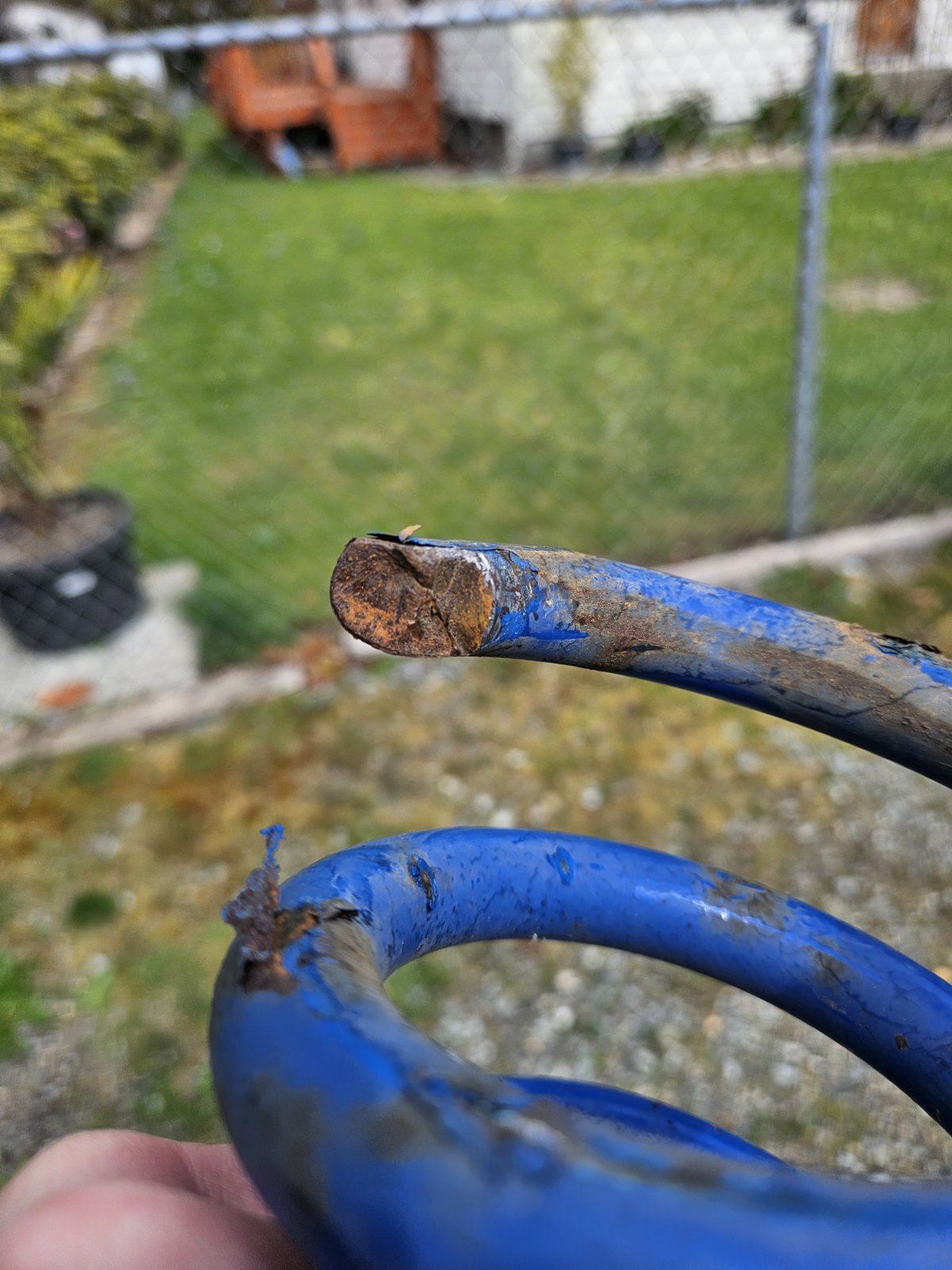

    Looks like it was cracked for quite awhile with all that rust?
    xxTacocaTxx and Bertw192[QUOTED] like this.

    Agreed. Looks like there's only the thinest sliver of silver that must have been keeping it together prior to this weekend.
    Needless to say, I'll add "coil inspection" to the list of regular checks. I still think this failure is wild, given the use condition.
