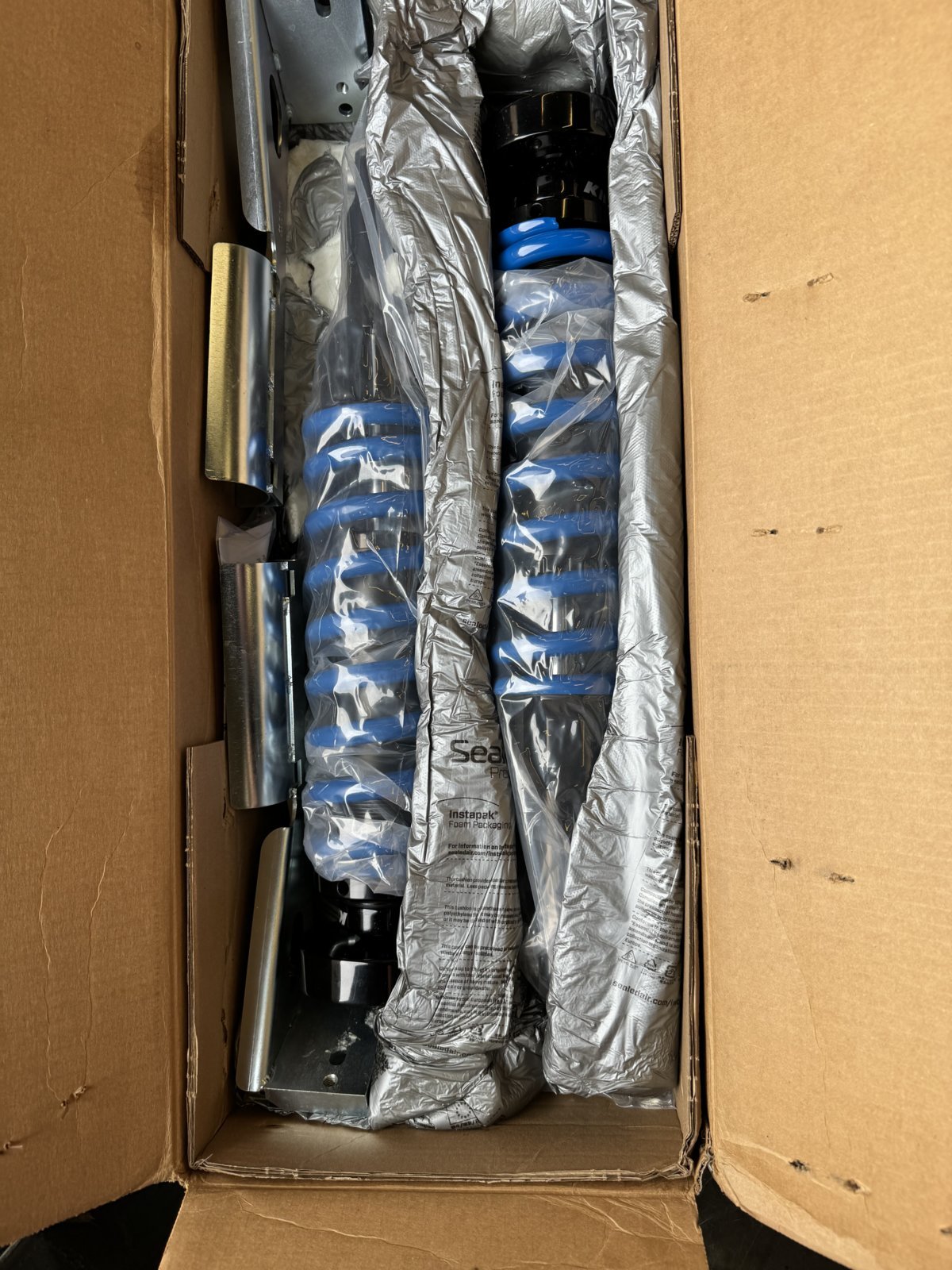

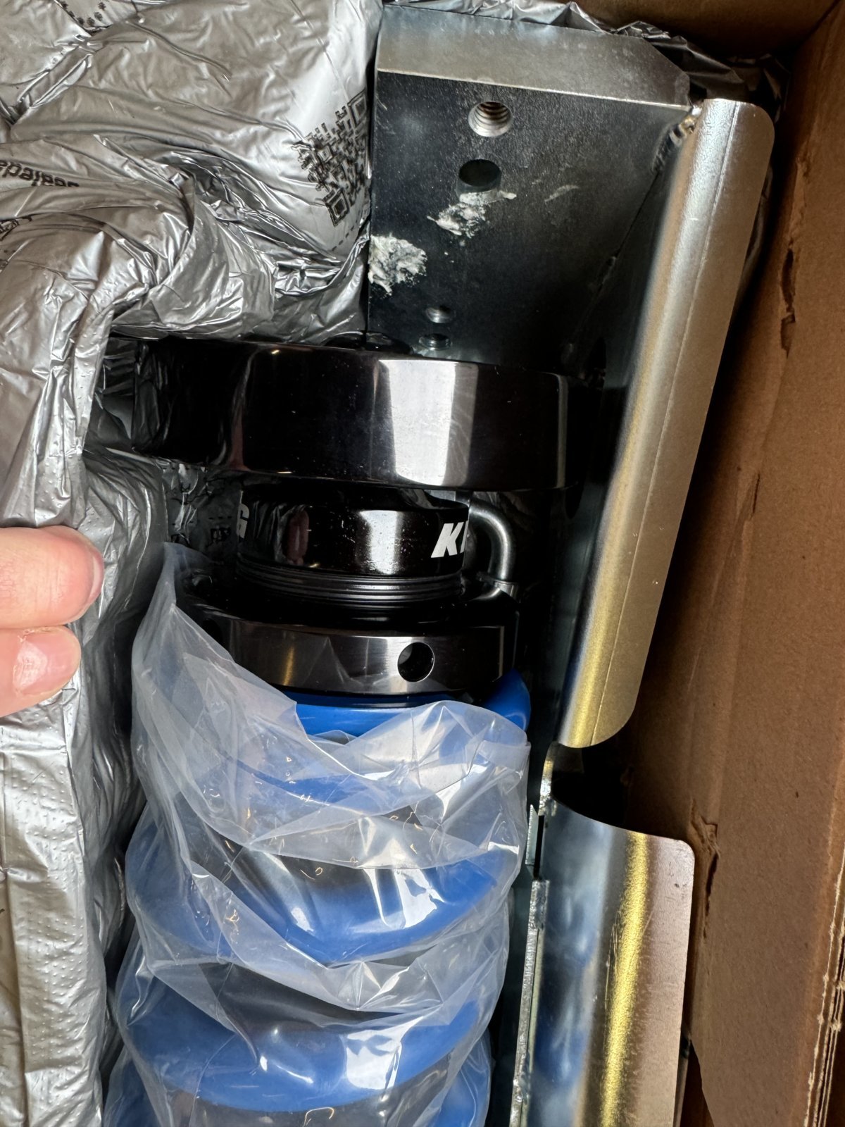

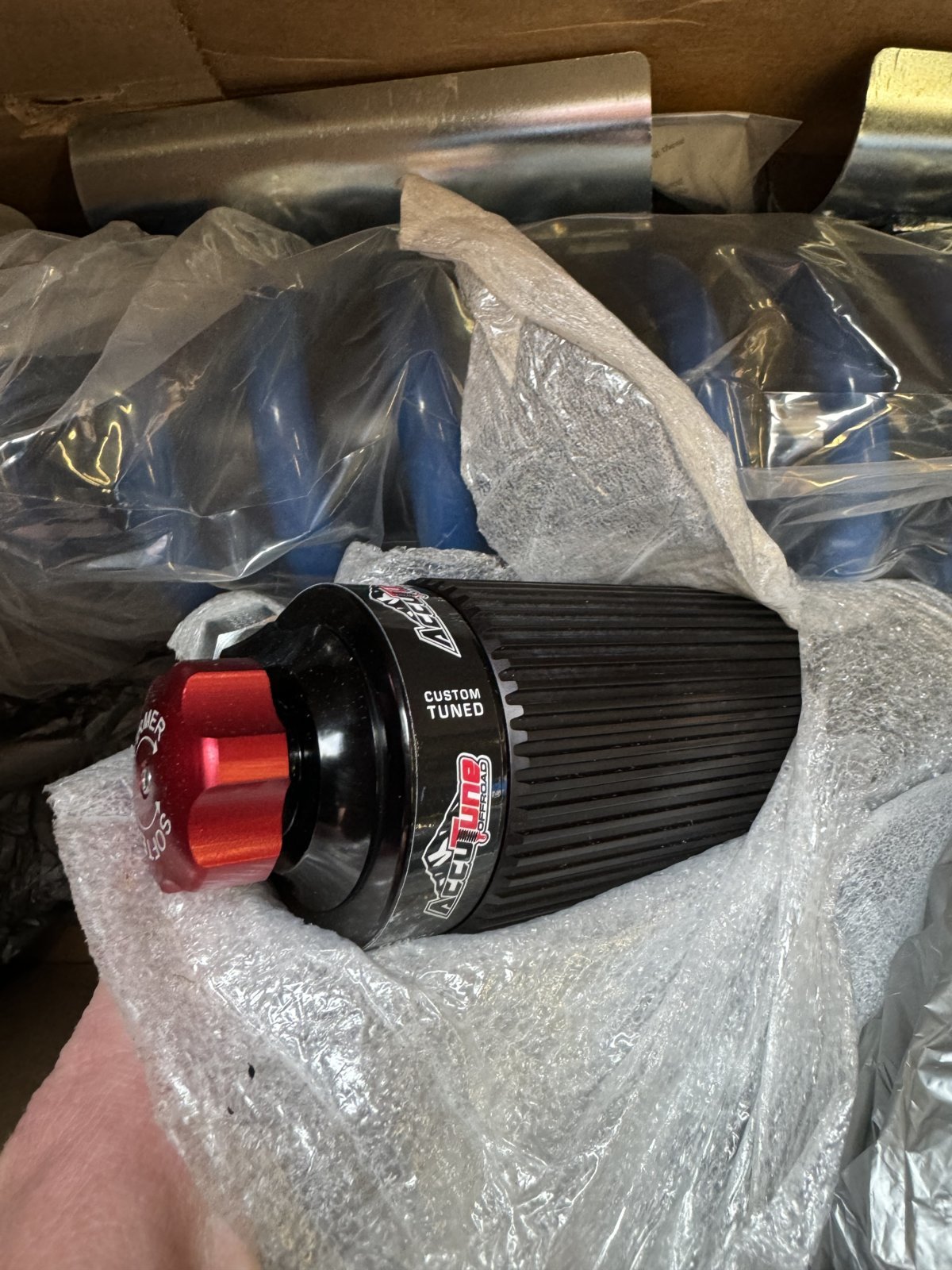

    Just got my custom painted kit in. I’m looking for suggestions on high quality black spray paint for my springs to bring the all black look together. TIA.

    I would suggest looking into getting them powder coated. Those shocks are beautiful and spray paint wont last.

    I was actually told by your shop over the phone to just spray paint them. I had an email with king as well when trying to get them black and they told me that powder coating may cause issues and cracking if I strip them and recoat. They said that color options weren’t available on the springs at the time of order. If I have the option without damaging them I will absolutely get them coated.

    We recommend powder coat first, using a supplier that is familiar with painting coil springs and can do a quality job. If thats not an option or the color you want is too specific, spray paint is an option. Prep for something like this is super important to make sure the paint will stick. Since the springs are flexing a lot, it can be difficult to get regular spray paint to stick.
