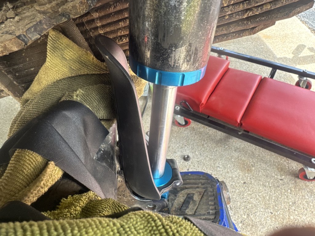

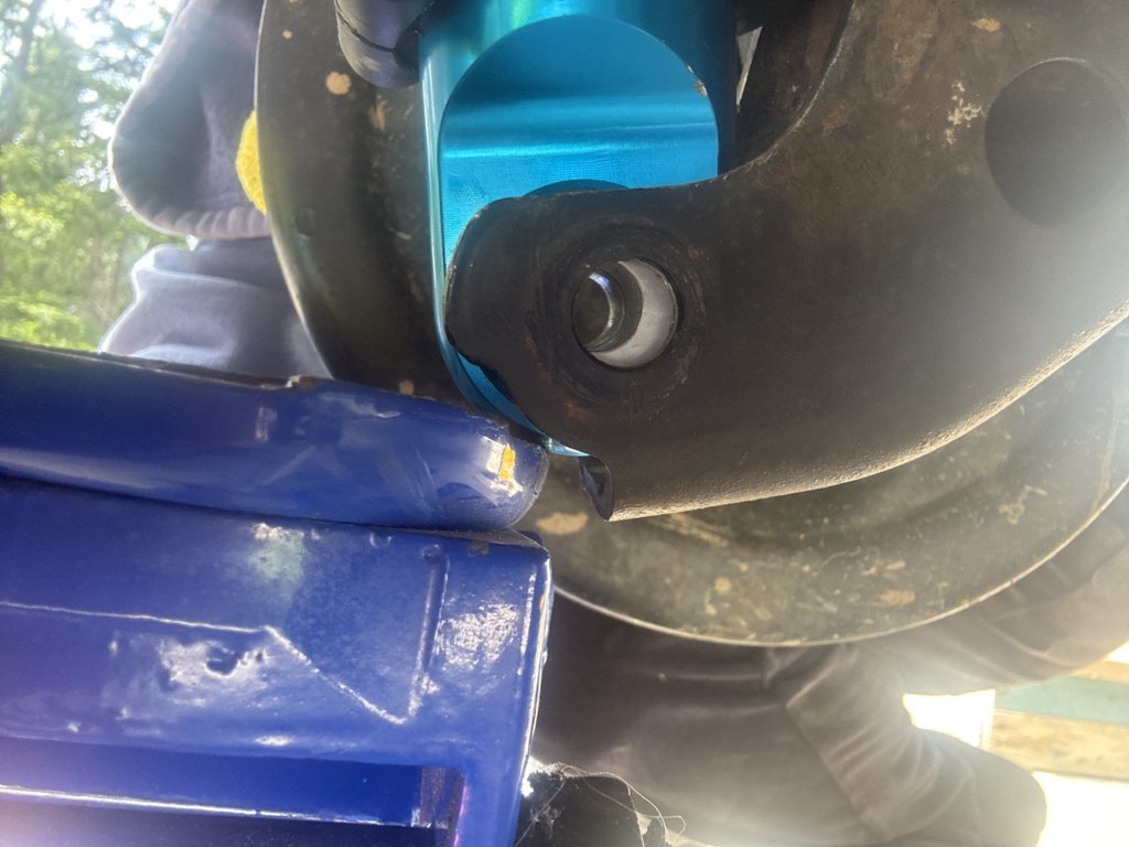

    Trying to refit my shocks after a rebuild and installing king’s shaft guards on the rears. The guard doesn’t fit on the driver side…that is if you want to run it facing forward…it contacts the axle. Running it backwards seems pointless. I’ll probably scrap these and find a universal guard kit. The only other solution I can think of is heating the plastic and trying to reshape it a bit.
    Anyone else using these have a similar issue?

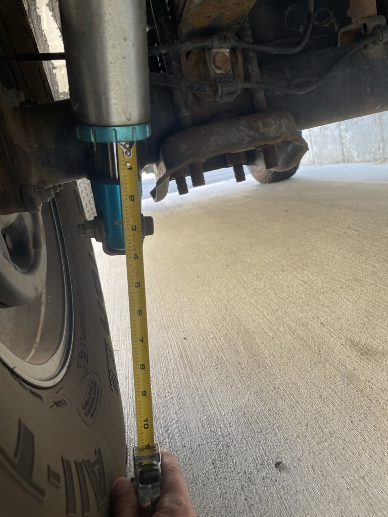

    shocks will bind before bump stop even gets close to frame..
    Any recommendations on what to do? I could lift and extend the bump stops but I got these shocks to avoid having to lift my truck higher. I was also under the impression that these would not need bump stops to be raised since they aren’t the 1.5-3?
    Any advice is appreciated

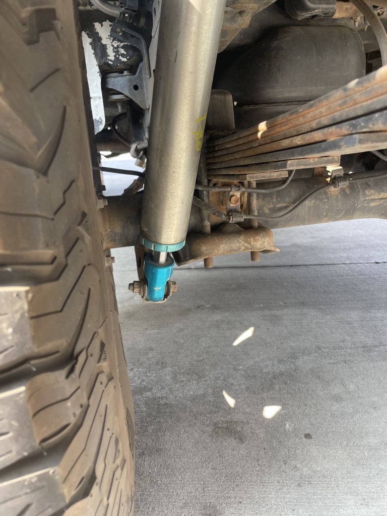

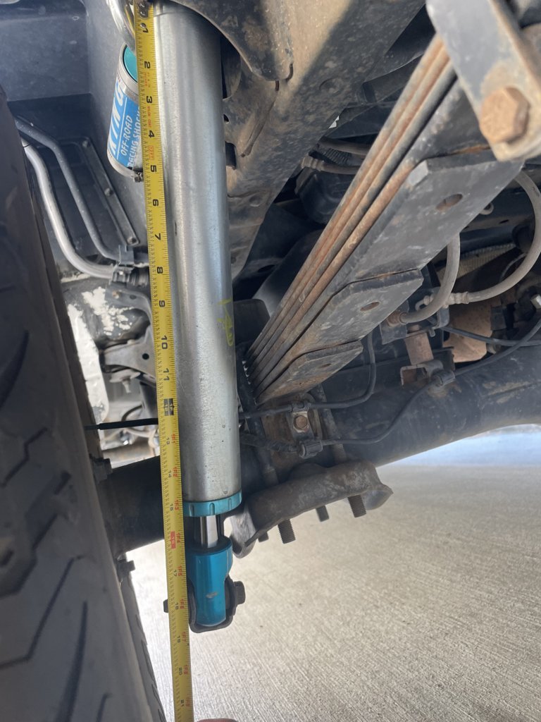

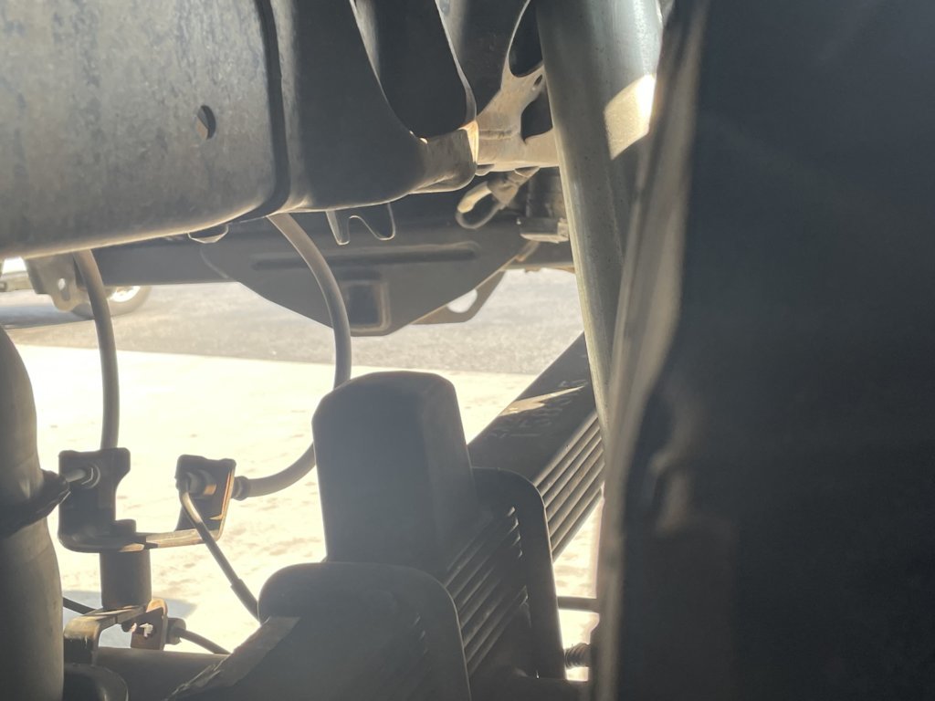

    took some measurements and pictures..

    Added pics to last post^
    Should I lift my truck more to make these shocks work or just get rid of them?
    https://www.tacomaworld.com/threads/rear-kings-have-no-uptravel.865679/
    I have RXT leaf pack and can go from option 1 to 3, as well as u bolt flip kit with super bumps (would need to raise the bump stop multiple inches)
    front is king coils with currently almost no preload that I can raise

    Have you looked at your leaf/shackles/hangers to see if the issue isn’t there? From my (limited) experience, the shocks shouldn’t be a factor with ride height, but I agree, something doesn’t look right. From the pics you’ve posted, your leaf look/ pretty flattened, and your weight seems pretty heavy for a stage 1.

    Hmm you’re not wrong, I’ll try installing going up to stage 3 next week and then see how things are looking

    also. I suggest removing the shocks and seeing if you can compress them by hand/body weight to ensure they’re not leaking or blown.
    what’s that yellow marking on the shock body about?

    definitely not blown haha, took everything I had to get them to compress.
    not sure what the yellow is for, previous owner used a paint marker on it for some reason. will probably clean that off next time i'm under
