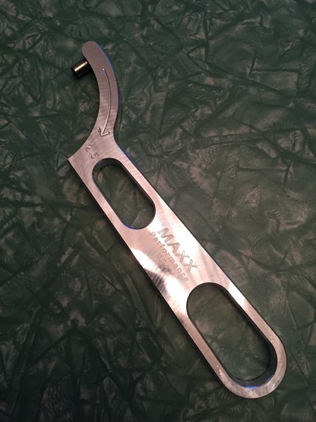

    So I got this spanner tool from pacificcustoms.com thinking this may help me with the with adjustment around the reservoir tubing on the passenger side. Nope. The tool doesn't fit between the adjustment ring and the coilover bracket to reach the hole. Does anyone know if that Kings T-handle tool works better than the spike wrench thing that comes with the coilovers in reaching the hole for adjustment? Don't want to buy another tool, nor do I really want to have the coilovers removed in order to adjust.image.jpg

    Yes, the King T-handle works. I bought it and with the straight punch tool that came with the shocks, you can get access to all the holes. I paid about $40. I also used WD-40 on the threads.

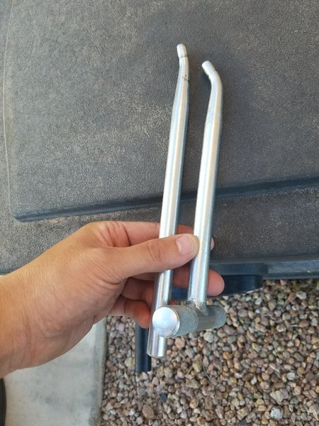

    Aside from the T Handle from King, has anyone been able to successfully adjust the coilovers w/resi while on the truck with maybe an alternate tool? Ideally something that I can find from a local tool store? (trying to avoid waiting for shipping)

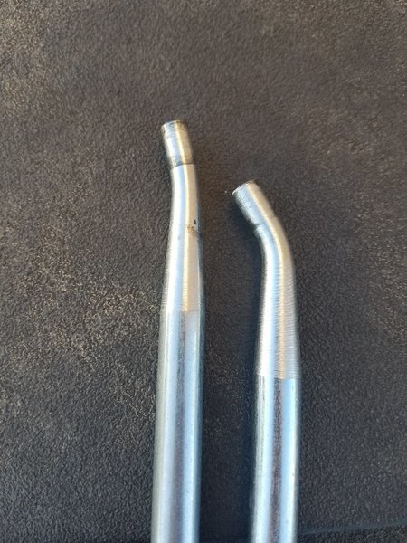

    Just a heads up, I was able to find the King T-Handle locally at SDHQ. It really made the adjustment possible. However I did notice that as I was using the punch tool, the end started to bend a little and ended up pretty close to the angle of the T-handle. Once the punch was bent, I was able to use that solely to adjust the other side. Just something to consider if you are able to bend the end of the punch tool, you might be able to avoid having to get the T-handle.

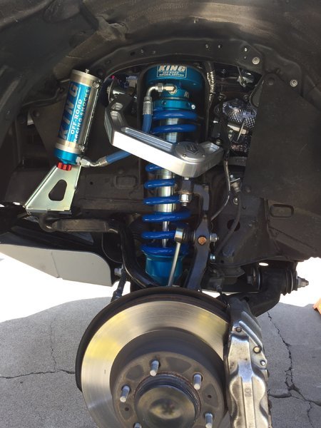

    Thanks for those on this thread for guiding me in the right direction. Got my Kings w/clickers and couldn't be happier.

    I pretty much left it the way it came from Kings and was told that it was the optimal setting. Got me around 1.25" of lift in the front. But I did turn up the drivers side one thread to accommodate the "lean".
