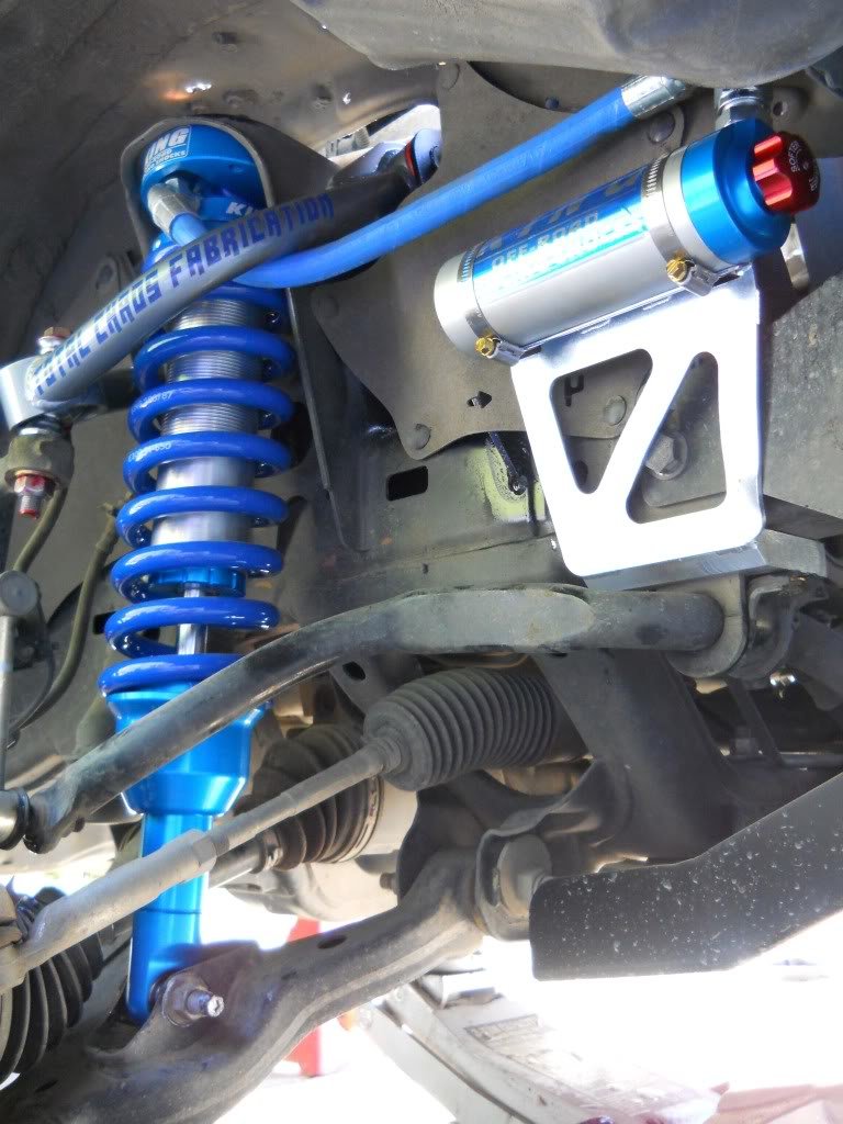

    Are you on Kings now? The remote res bracket IS the swaybar relocation as well (I'm pretty sure).

    I have kings sitting in the garage, gonna get to them in a few weeks. I do have the remote res bracket, and it would be perfect if that solved the problem. However, you sound unsure and I would like to confirm.
    I bought them from @Downsouth Motorsports , perhaps they can confirm this.

    It appears the bracket moves the swaybar clamp down a bit, so that probably gives the corner/angled part of the sway bar more room between the strut. Would be good to confirm though, but that's what I've gathered and seen from other posts.

    Thanks, those look like the ones I have. How many clicks on the resi in/out are your running? Spring rate?

    I'm on 6112s. I grabbed that pic on Google. Eventually will have Kings one day though haha

    Yes, i can confirm the Resi Mount relocates the sway bar. :thumbsup:

    relocates it towards the front?

    down and forward

    Thank you sir, just saved me some money on a relocation kit.
