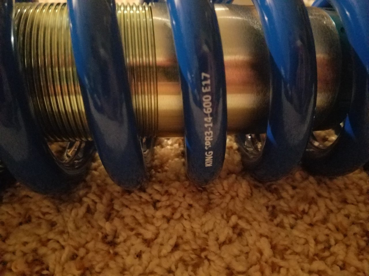

    Okay cool. Thats what I expected with the standard setup.
    Hm. I emailed King and asked if there were 3rd gen specific kits but they said no. Said it was a direct carryover from the 2nd gen with no change in part number. I also inquired about spring rates from headstrong and they said they come with 600 standard

    Are the springs labeled?
  9. Jul 27, 2017 at 7:38 PM
    #389
    c4lvinnn
    c4lvinnn [OP] Well-Known Member
    Sep 30, 2016
    #198603
    2,128
    '17 TRD Off Road DCSB
    They should be. I'm pretty sure somewhere in this thread has a pic of the numbers on springs?
    Doggman[QUOTED] likes this.
  10. Jul 27, 2017 at 7:41 PM
    #390
    Doggman
    Doggman Well-Known Member
    Sep 8, 2015
    #163722
    2,544
    John
    Alabama
    2017 TRD OR MT
    They are. Looks like mine came with 14" 600lbs. I ordered standard kings from headstrong fwiw. No custom spring request.

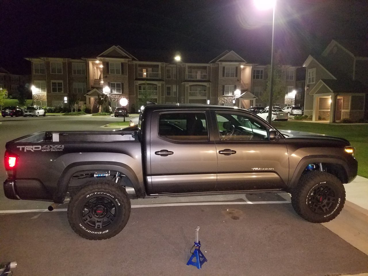

  18. Jul 29, 2017 at 7:20 PM
    #398
    Doggman
    Sep 8, 2015
    #163722
    2,544
    John
    Alabama
    2017 TRD OR MT
    12 hours later...
  19. Jul 29, 2017 at 7:29 PM
    #399
    20tacoma17
    20tacoma17 Well-Known Member
    Nov 8, 2016
    #201910
    7,079
    2017 DCLB Sport AT
    Kings, 275/70/17, a few custom items, lots of Meso mods.
    Love it, able to get a lifted measurement yet? Our trucks are very similar.
