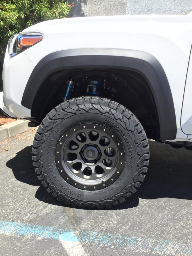

    am i preloaded too much? I have about 12 threads showing in the front, hub to fender measurement 23.75", or about 2.25" of front lift. i have the 14" / 600 lb spring.
    i haven't taken it off road yet with this new set up, but i do notice when going over large driveways fast, i hear almost a bump in my suspension, maybe bc I have it jacked up too much... How are you guys getting so much lift without cranking it up so much, seems like most are running 14" too?
    just got my Kings installed about 4 weeks ago. 2.5" with resis all around (non adjustable) and using a 1.5" Icon AAL in the rear to lift. tried to read through this thread, but i'm a newbie to this stuff.

    I thought front stock height was 21? You were 21.5 stock? Just checking. That could be 2.75 LIFT.

    hmm it's definitely possible my measurements could've been slightly off. :confused:

    Just keep in mind, the higher you crank them up, the less downtravel you have.

    I'm new to this but thought I read 3rd gen front stock 21, rear 22? U don't know because mine came new with readylift, want to change to kings but exact same height. 23.5 front.

    "bump in the suspension" is your sway bar hitting bottom of coil over? did you relocate it

    Bump sounds like one of the bolts isnt torqued. Probably one of the sway bar bolts. I forgot to torque down an end link nut that connects it to the spindle and it was clunking. Tightened it up and all was good.
