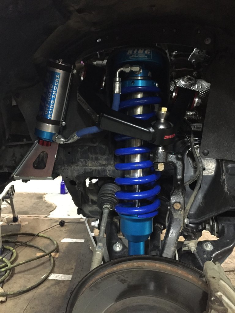

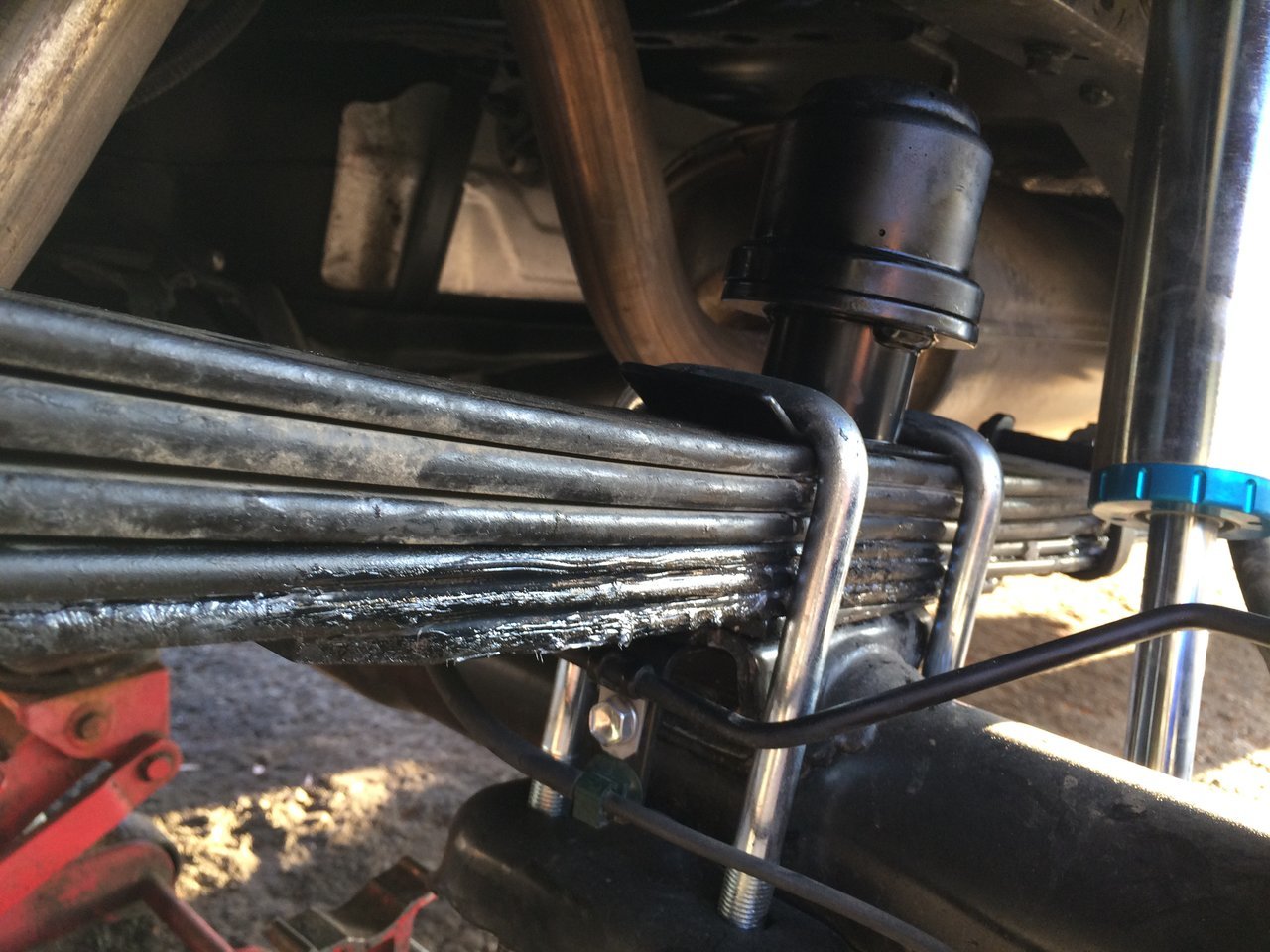

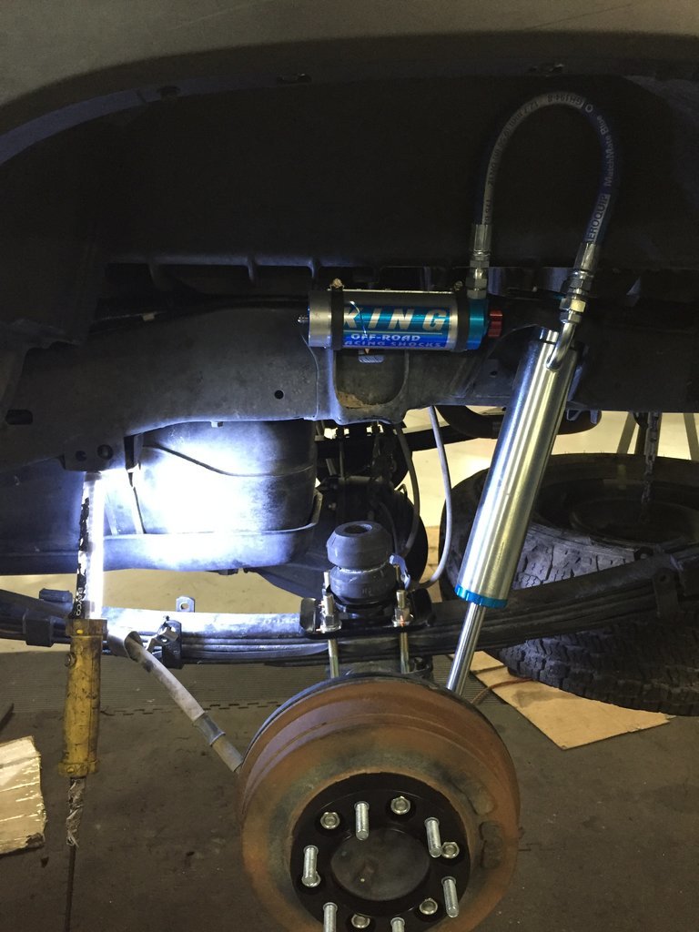

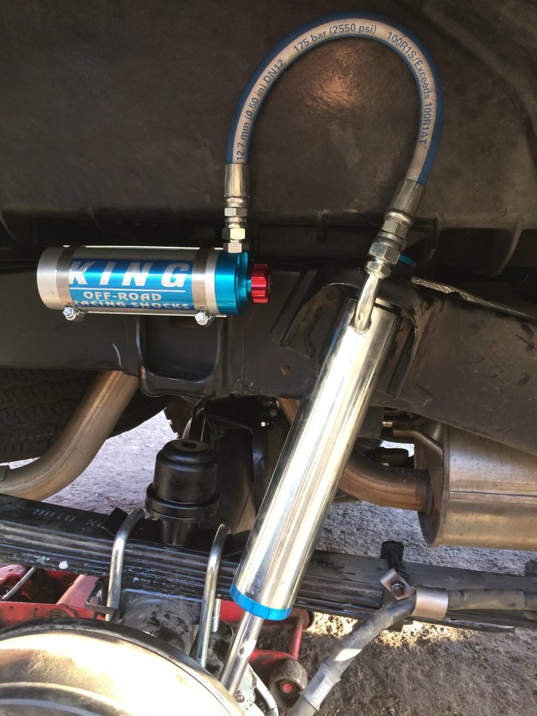

    Just upgraded to Kings.
    - KING 2.5" Rem. Res. Ext. Travel Coil Over w/Comp Adj. with 650# coils.
    - KING 2.5" Rem. Res. Ext. Rear Shocks w/Comp Adj.
    - Total Chaos Uni-Ball UCA’s
    - Front / Rear Extended Steel Brake Line
    - Icon 3-Leaf Progressive Mini-pack AAL (overload removed)
    - Clamshell Bushing (Replaces Needle Bearing)
    - Wheelers FRONT / REAR Superbumps Bump-Stops

    How's the ride with that add a leaf?

    cool stickers and a baseball card With clothes pin, sounds awesome ! wicked
    Why did you choose to remove the overload spring

    Most of the time when I off road the bed is empty and I prefer the softer suspension.

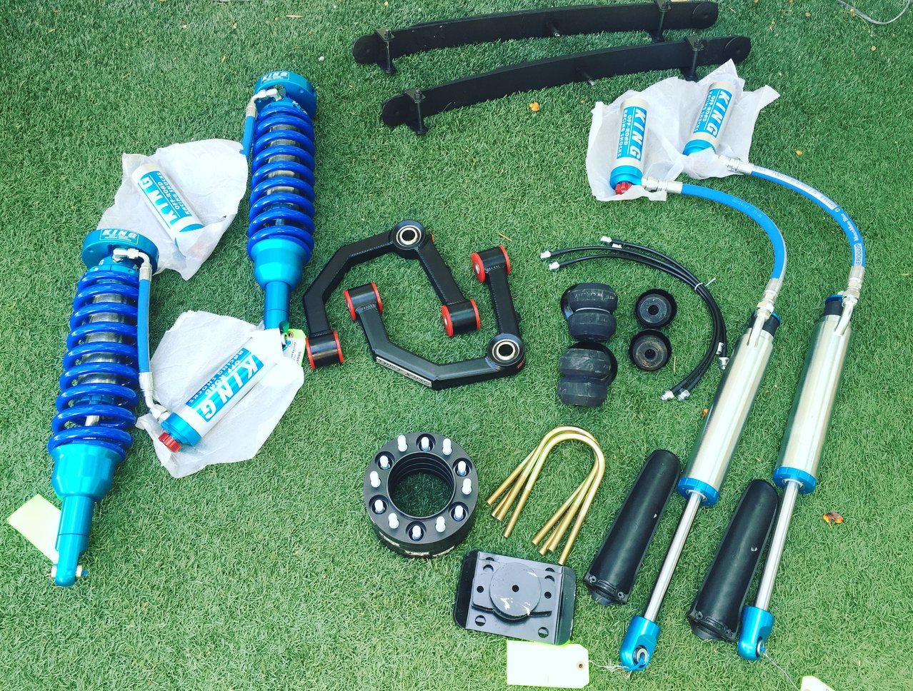

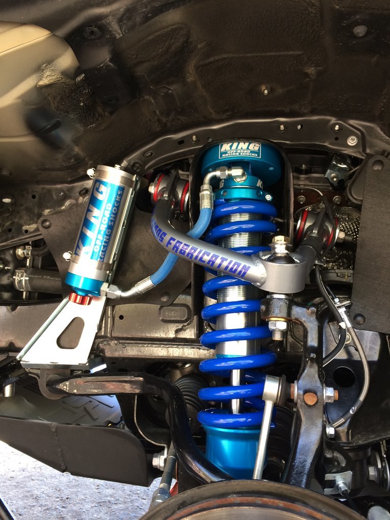

    Here are some pics. Ended up with a 3" lift. Ride quality was well worth the money!

    Have you had any problems using the stock UCA's?

    Night and day difference on road when I adjust them softer :thumbsup:

    It looks like you're not running much lift. I'm hoping for 2.25 to match the current lift.

    I'm on 14" springs with 650 spring rates that's why it's not preloaded. Standard is 13" springs and 600 spring rates.
    I'm lifted to 2.5"
