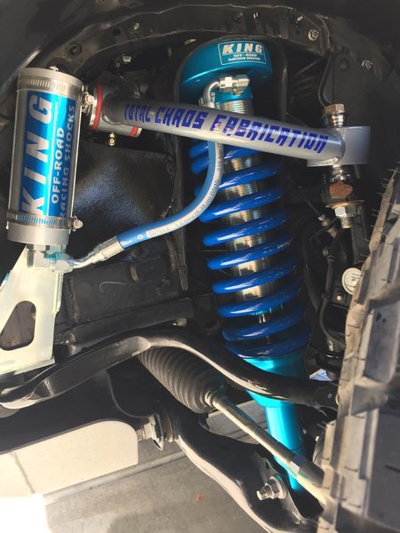

    I just wanted to pass along the procedure I used to adjust my coil overs with a little help from @Lord Helmet. :)
    Here's what I did... I bought a punch kit from Harbor Freight, and cut down the 5/16" punch so it fit in the adjustment hole with enough space to fit behind the reservoir fitting.
    Then I used an extension and a hammer to rotate the pin past the fitting so I could use the King tool in the next hole.
    I did oil the threads and had no problems at all using the King wrench. When rotating be sure to check the lock nut as it tends to get tight as you rotate it. I lifted the truck so there was no load on the suspension.
    Hope that helps some of you out!

    Nice idea, thank you guys. Does oiling the threads affect collar after you lock it down? I'm afraid that could allow it to creep over time.
    Also, what UCA's are you running? I noticed on my boxed UCA they are beginning to rub the hose. Are you finding the same?

    Nope as long as you tighten the collar Allen screw down without stripping it it won't move at all.
    Boxed UCAs I've seen so far have a few cases of rubbing the resi hoses. Mainly the Dirt King ones.

    Yea I have the Dirt Kings. Started showing some rubbing within first week. I wrapped the contact section with wire / cable wrap in hopes to prevent any serious damage to the hose. What I would like is an alternate way to mount the reservoir, but I can't seem to find any other option.
