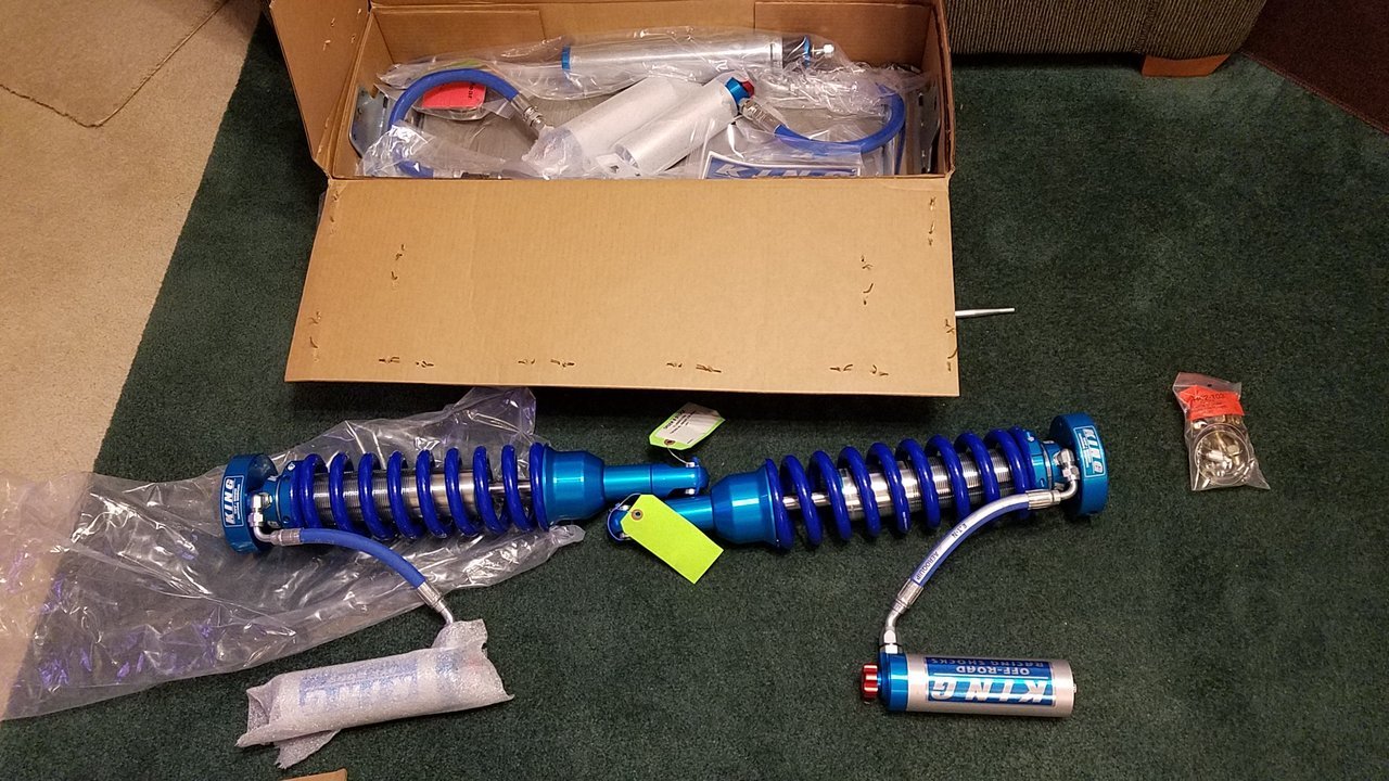

    Well they arrived with great service from @HeadStrong Off-Road :yes:Now to figure out best preload adjustment for 2.5 lift or just under. Replacing Readylift spacers and want exact same height. The instructions look easy but I've read some people disconnect lca?
    They sure look big..:benchpress:
    JoeCOVA and HeadStrong Off-Road like this.
