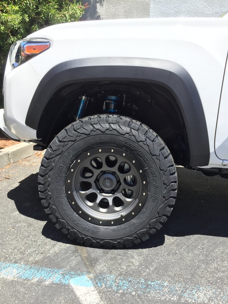

    not really, it had already settled about 1/4" from intial install at the time i took this picture. i have lowered it about two turns (approximately 1/2") since then. Rides a bit smoother, and my shock doesn't feel like it's bottoming out on large driveways / speed bumps anymore.
    i have about 9-10 threads showing now and am getting about 2-2.25" of lift. I also just added icon UCAs and made a big improvement on the way it drives on the freeway

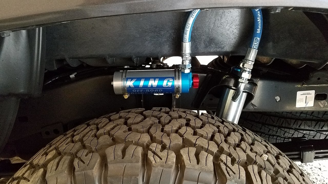

    Got the rears done. Had no idea these things were so much bigger than regular shocks?? Especially the reserviors...Next Wednesday the fronts...:goingcrazy:

    No rear add a leaf or leaf pack?
