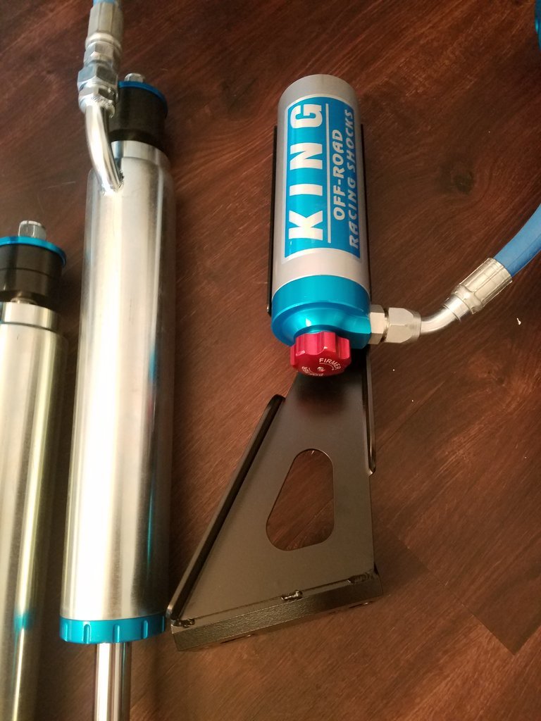

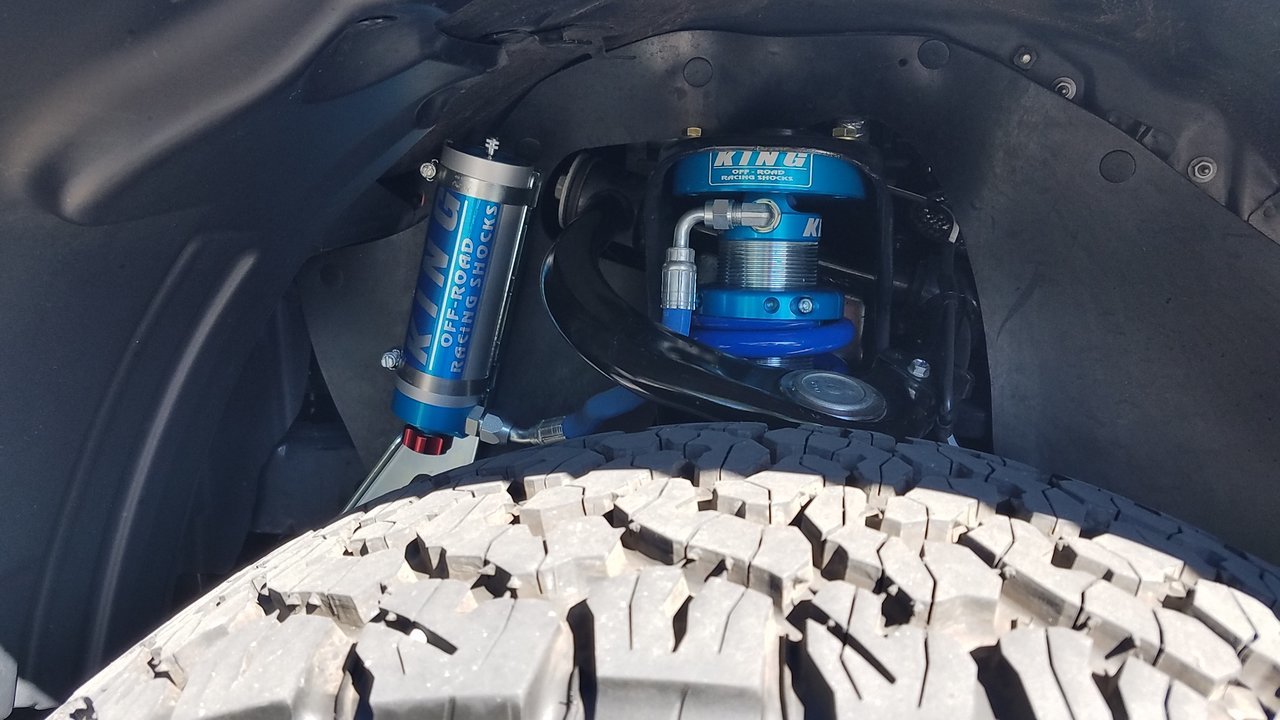

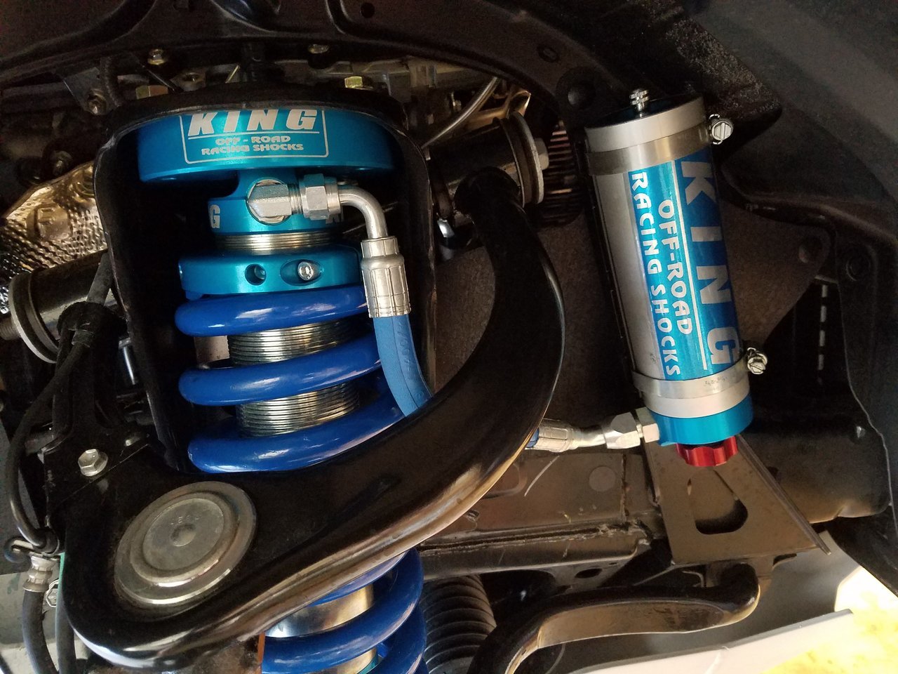

    Kings w/700lb coils and compression adjusters.
    Front bumper, winch (w/ synthetic line), and BD light bar total weight 145 lbs. Probably lost 10 lbs with the removal of the factory aluminum crash bar, give or take, for a net increase up front of about 135 lbs.
    I left passenger side at factory preload setting, and turned the driver's side up two turns to compensate for the driver side lean.
    Obtained right about 1 3/4" lift on passenger side with no adjustments from factory setting (about 3 threads showing above collar).
    Obtained right about 2 1/4" lift driver side with 2 turn increase.
    The ride, especially at front, is outstanding. No way I'd personally consider dropping down to 650's or 600's with the bumper and winch weight.
    Also, if you think the remote res brackets for the Gen3 are as funky as I do, consider having them powder coated black as I did. Nice improvement in overall looks if the shiny, funny bracket bothers you as it did me.

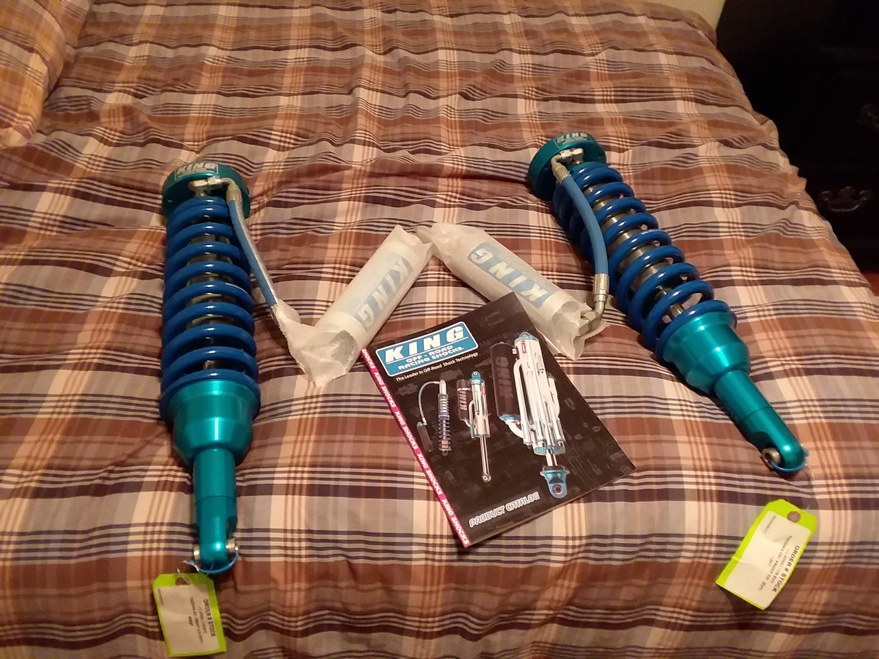

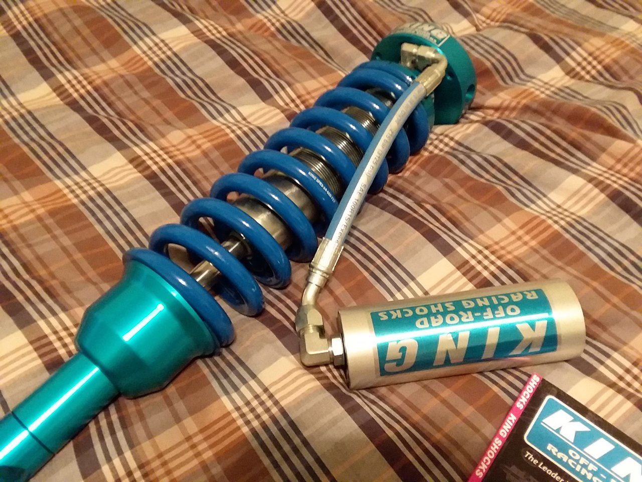

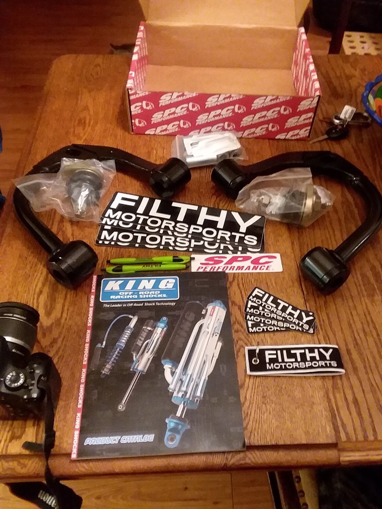

    Got these in today. Still working on getting my rear setup. So far, my impressions are the quality is top notch. 20170929_180148.jpg 20170929_180106.jpg 20170929_180030.jpg 20170928_215753.jpg
