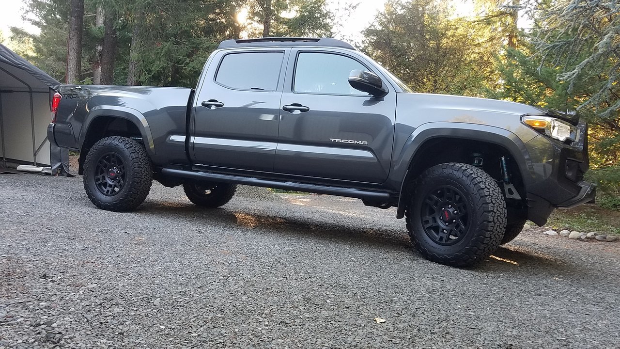

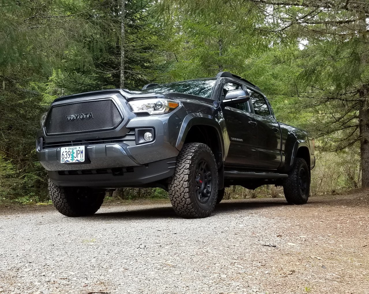

    I'm at 2.5 front running 275/70/17 with no rubbing. Only about a 1/2 inch shorter tire.

    would you mind posting pics? a nice solid side profile is what I'm looking for

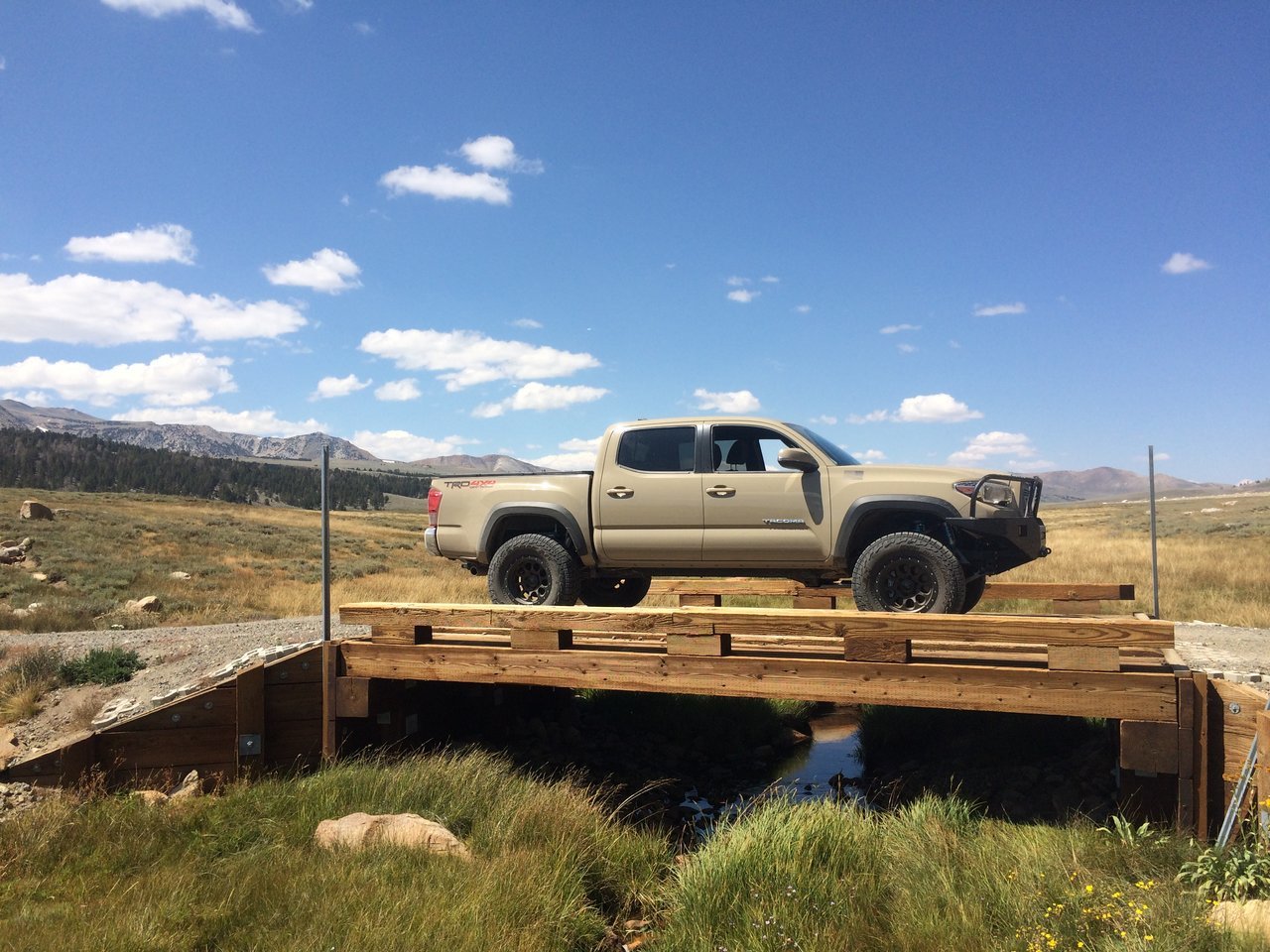

    2017 QS TRD Off-Road 4x4
    2.5" King w/Adj 285/70/17 Wildpeaks Ray 10's
    Pretty much exactly what you stated but with adjusters.

    how much of a lift is that? do you mind sharing your preload settings?
    285 kO2?

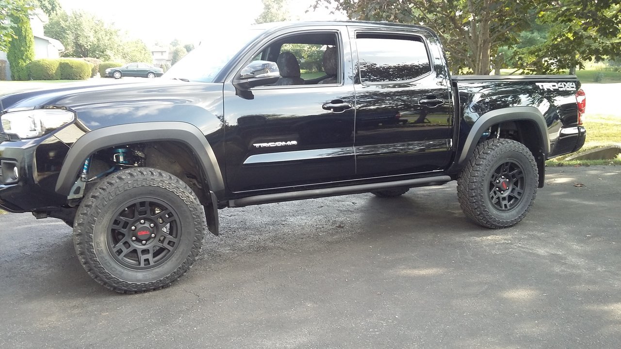

    2016 trd or dcsb & 2002 trdor exclb
    cool stickers and a baseball card With clothes pin, sounds awesome ! wicked
    dude there are also 255/80R17 you could look into no trim!!
