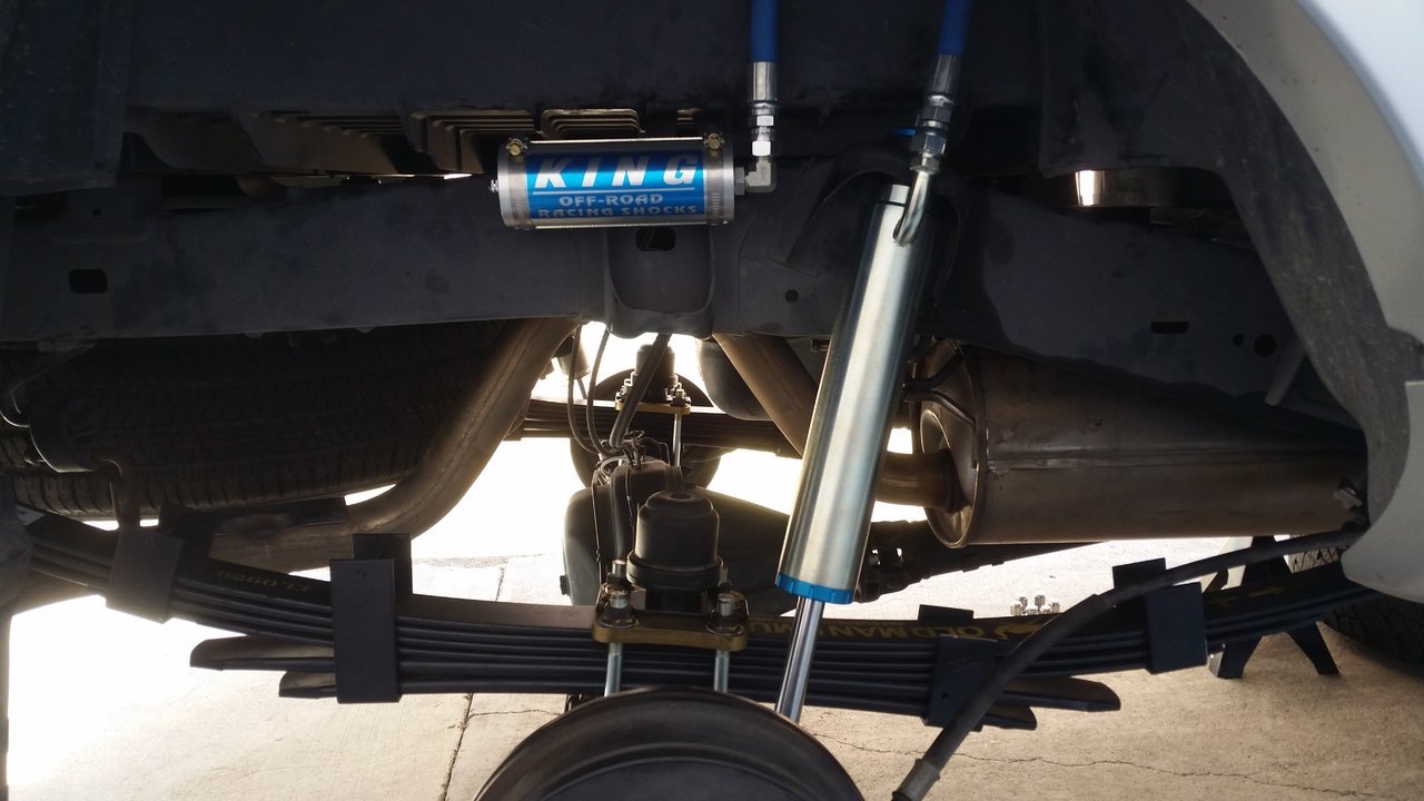

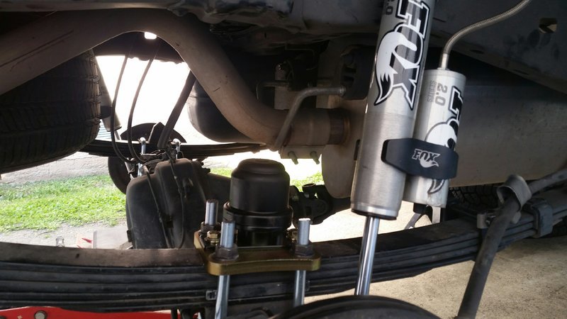

    My 3-piece AAL:
    My Dakar 95R leaf pack:

    What rides smoother/softer, the 3 leaf aal or the dakars?

    3 piece AAL but when loaded dakars are very smooth also. 40-50 lbs extra in the bed for the dakars makes a world of a difference.
