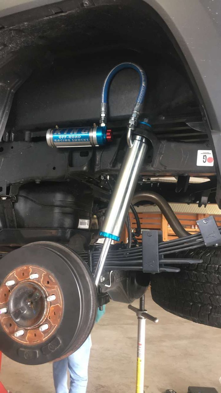

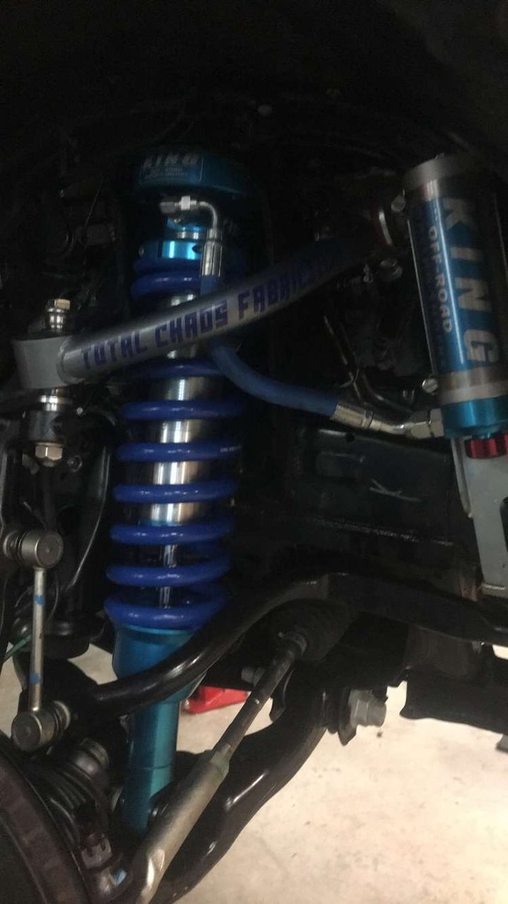

    So I did this yesterday.... But i have some question if anyone can assist.
    The front coils i had no clue couldn't be adjusted while on the truck due to the resonator.
    But is there any special spanner to do this while on the truck?
    Does anyone have some experience with making these raise to the 3" potential I.E how many threads do you have showing above the coil?
    Right now its drooped in the front because of this and i would love to make it even.
    Also need an alignment pulling to the right pretty bad.
    Now the ride with 12 clicks to firm is damn near perfect IMO.
    Thank you for your input.
    P.S Currently reading through this if i find answers i will delete. :)

    Just in case anyone has the same question on how to adjust while mounted I got a pretty solid answer that I think will work...
    Find a Solid punch cut it down to about an inch or so and put it in the spanner hole and use a wrench to pull it and bring it into a position where you can use a normal punch again.
    I haven't tried it yet but i will update once I give it a go.
