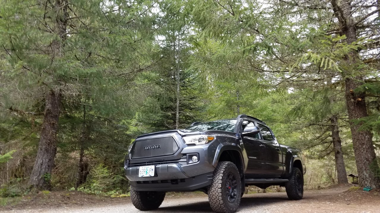

    Can you post a pic ? Please

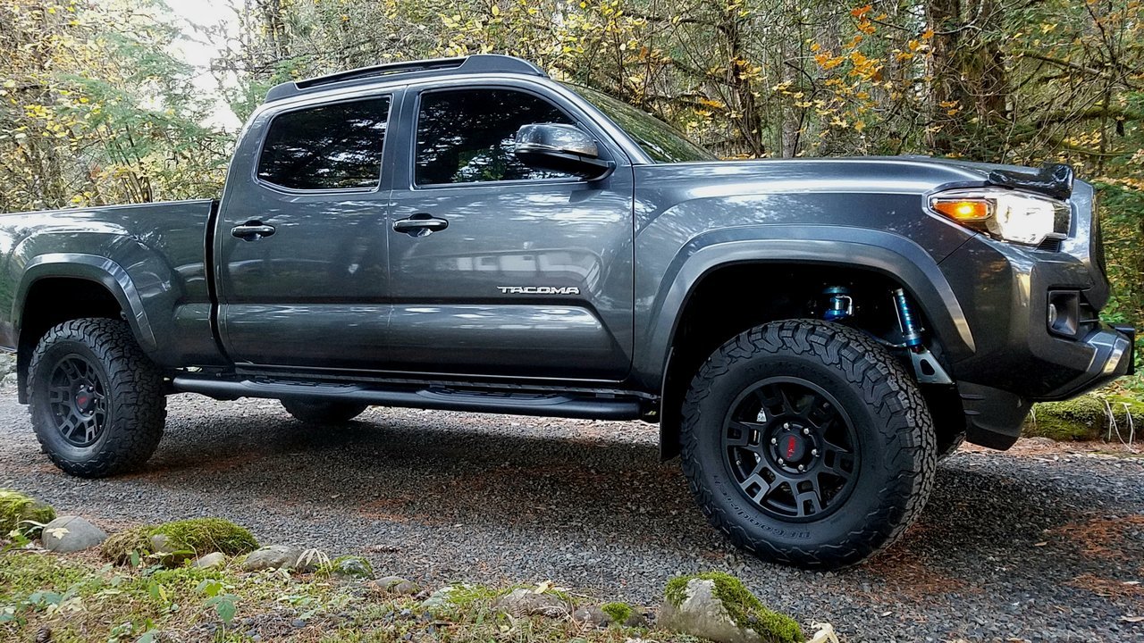

    20tacoma17
    20tacoma17 Well-Known Member
    Nov 8, 2016
    #201910
    7,079
    2017 DCLB Sport AT
    Kings, 275/70/17, a few custom items, lots of Meso mods.
    I have one in here somewhere but here's another. They are 275/75/17 ko2.

    Tacomamike mike
    Tacomamike mike Just that, nothing more.
    Sep 6, 2016
    #196650
    3,960
    Michael
    2017 DCLB TRD OFFROAD 4x4
    Working on it, dissent offroad racks, shift sense pro, pedal commander , ARB twin, rigid SS dually's , dual batteries, ARB fridge , 2.5 Fox coil overs wResi , 2.5 Fox rears w resi Total chaos UCA , deaver packs , Nitto trail grappler's 33" .
    Thanks !!
    They look great ! I’m thinking Nitto Trail grapplers on mine . But your opinion, in my opinion, is dead on. They look great
