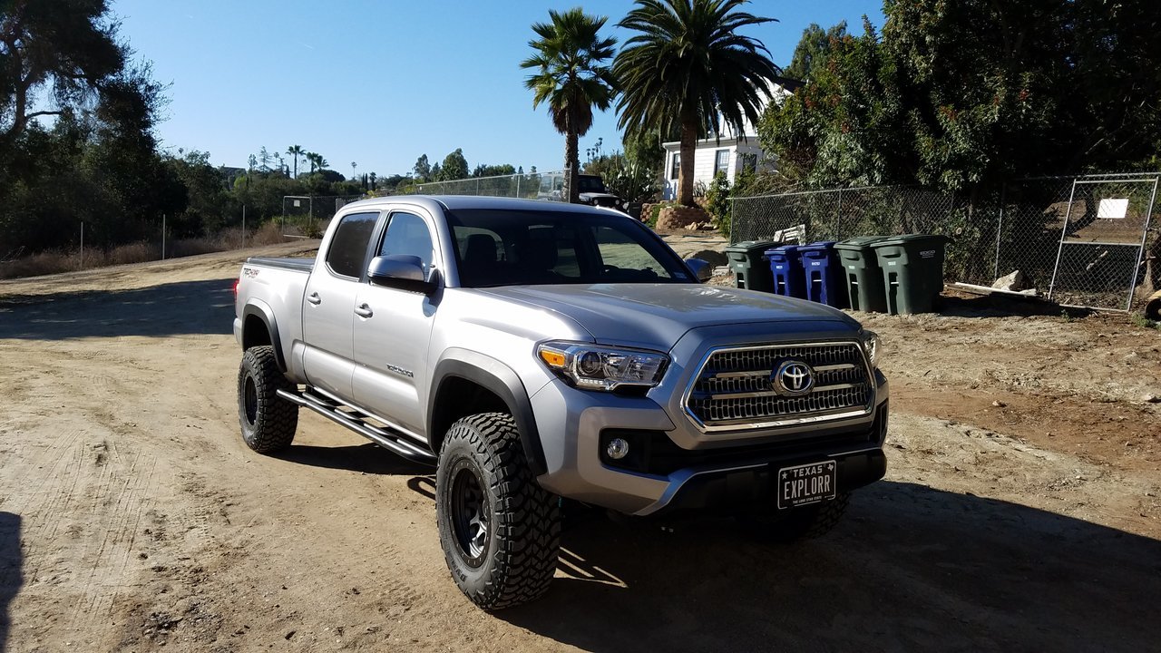

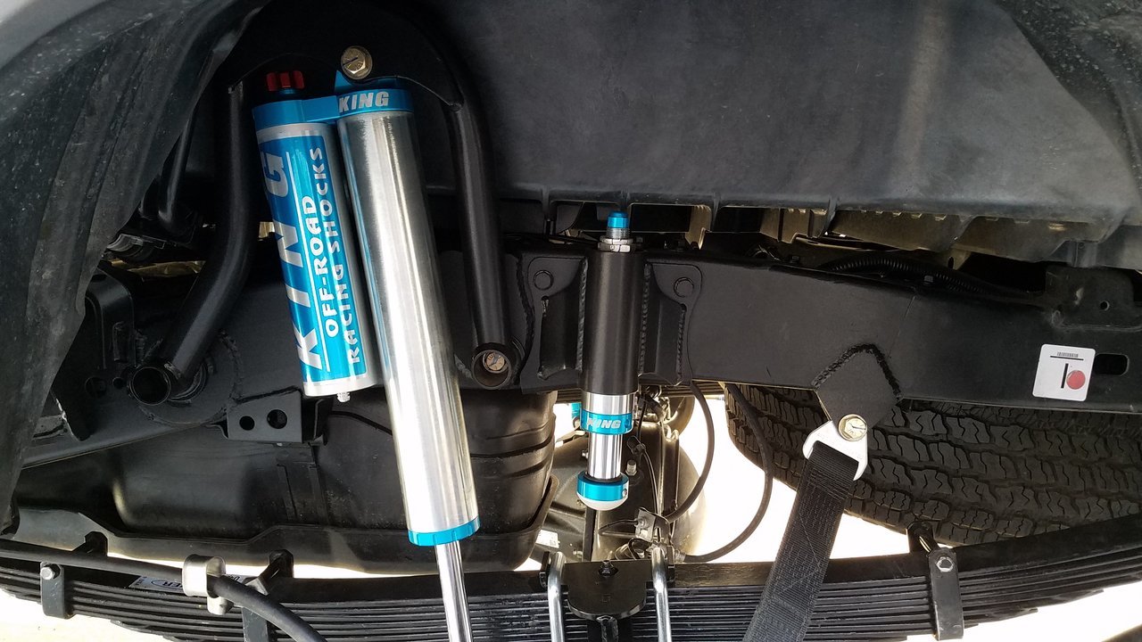

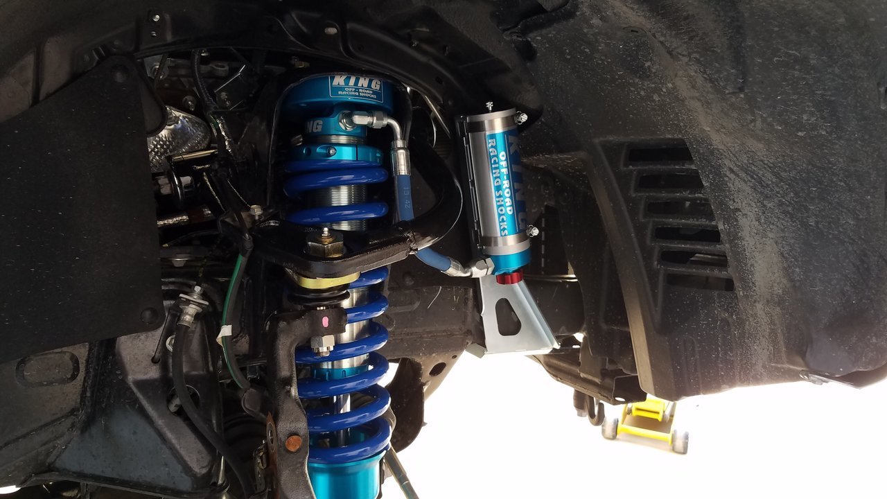

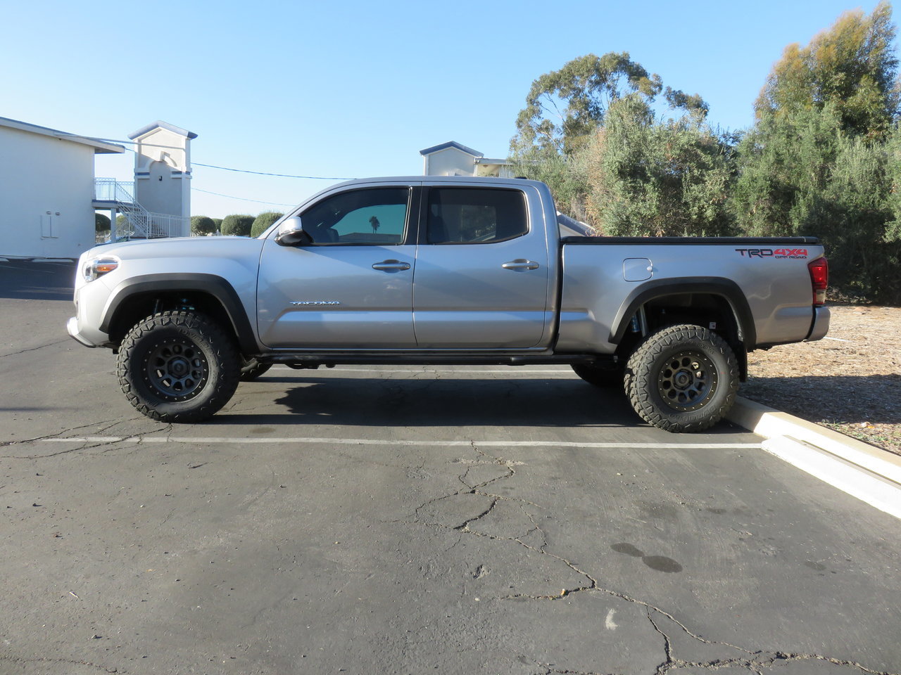

    Thank you!! Was a lot of work but I'm glad I got to do your build, it came out great!! I really enjoy taking the time to do a complete build with some fab mixed in.
    Looks AWESOME!!!!!

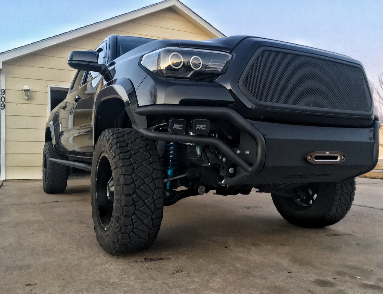

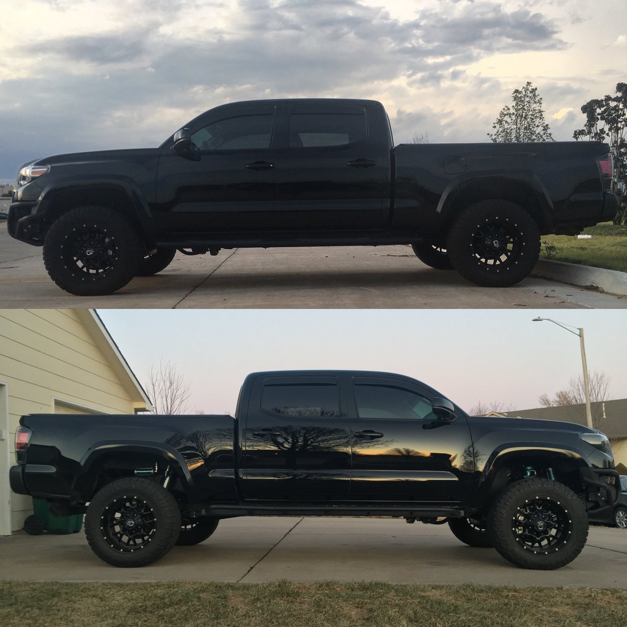

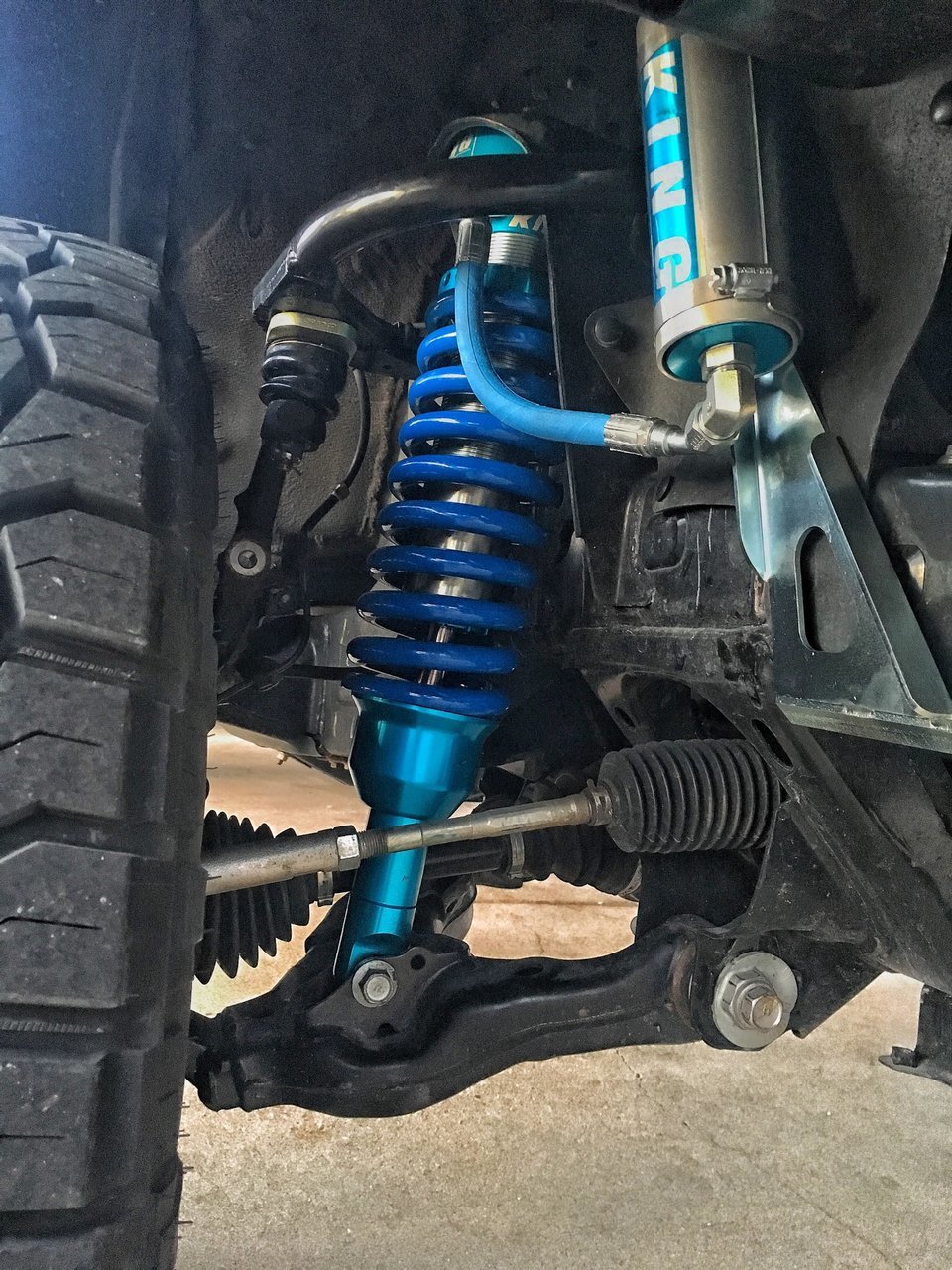

    Finally got my King’s installed. Extended travel. 14” 650lb coils in the front. Longer mount installed by DownSouth. SPC upper control arms. Dakar medium duty leaf packs. Love how much better they look than my 5100’s. Set them at 11 and 9. Thinking about going up an extra notch or 2

    They do look awesome don't they...im set at 10 and 12 but have 600#. Gave me right at 2.5 lift.

    Stock bumper or aftermarket? How much did yours end up settling?

    Stock bumper. Settled maybe 1/8 inch after 1 mo. Haven't cked since.
