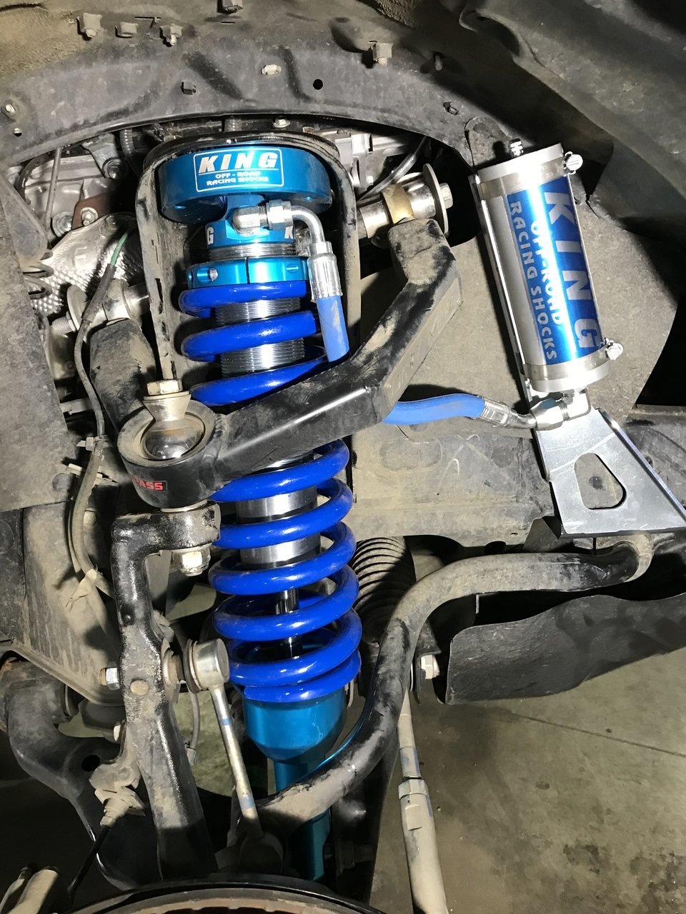

    I have installed a 1/4" top plate spacer with no issues. It has kept the taco lean to a minimum. Here's mine with 14" coils and 650 spring rates:

    If you preload your coils too much, does that limit your travel?
    I know I read about it somewhere, but don’t recall the answer.

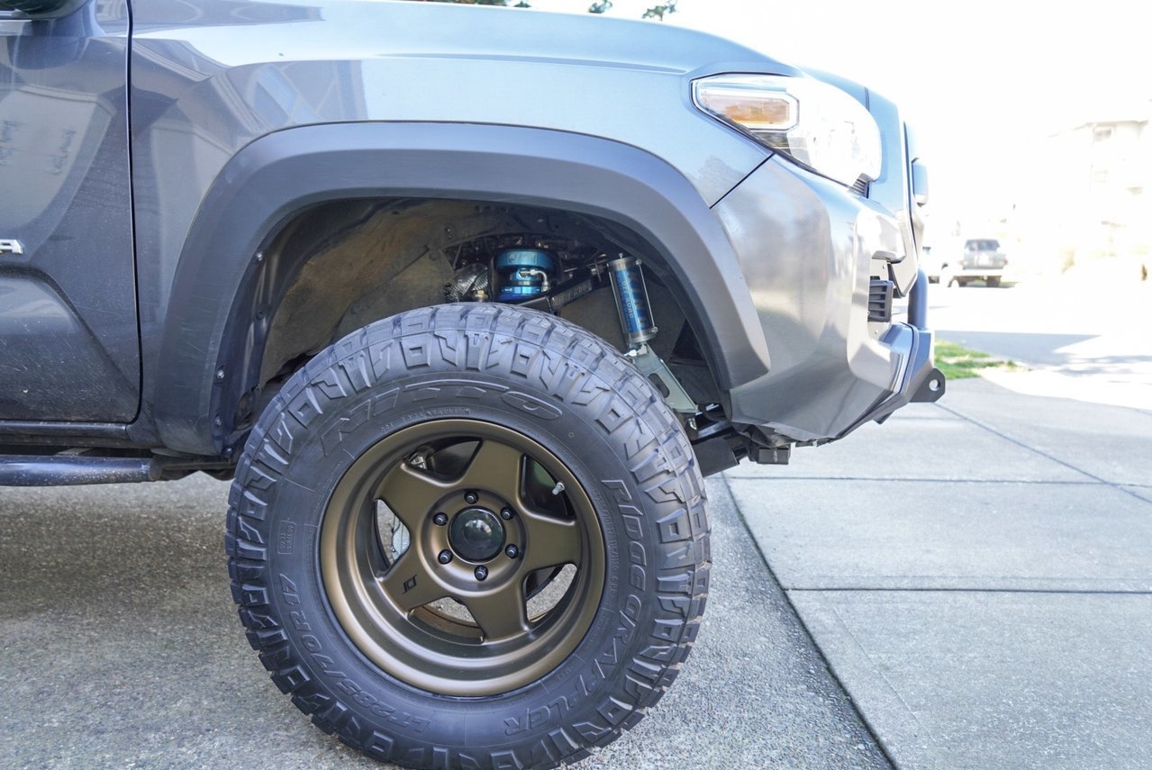

    Thanks guys. Right now I have the top plate spacer on both sides without additional preload since I need clearance for my 17x9 F5’s. Center of hub to fender is 23.5 drivers and 24” passenger right out of the box. Also, I’ll have full skids and a full bumper setup soon so I’ll re-evaluate leaving the top plate spacers on as everything is on and settles.

    Looks good! I’m about to get some Kings myself and am looking to run similar tires. What backspacing you have on the wheels and did you have to trim?

    Thanks man! These are 3.5” BS and I had to trim both front and rear inner fender liners. I previously did a CMC but it’s rubbing on the left side can mount. I’ll add more caster before I CMC more.

    The more you preload the more you are extending the shock while it's just sitting.
