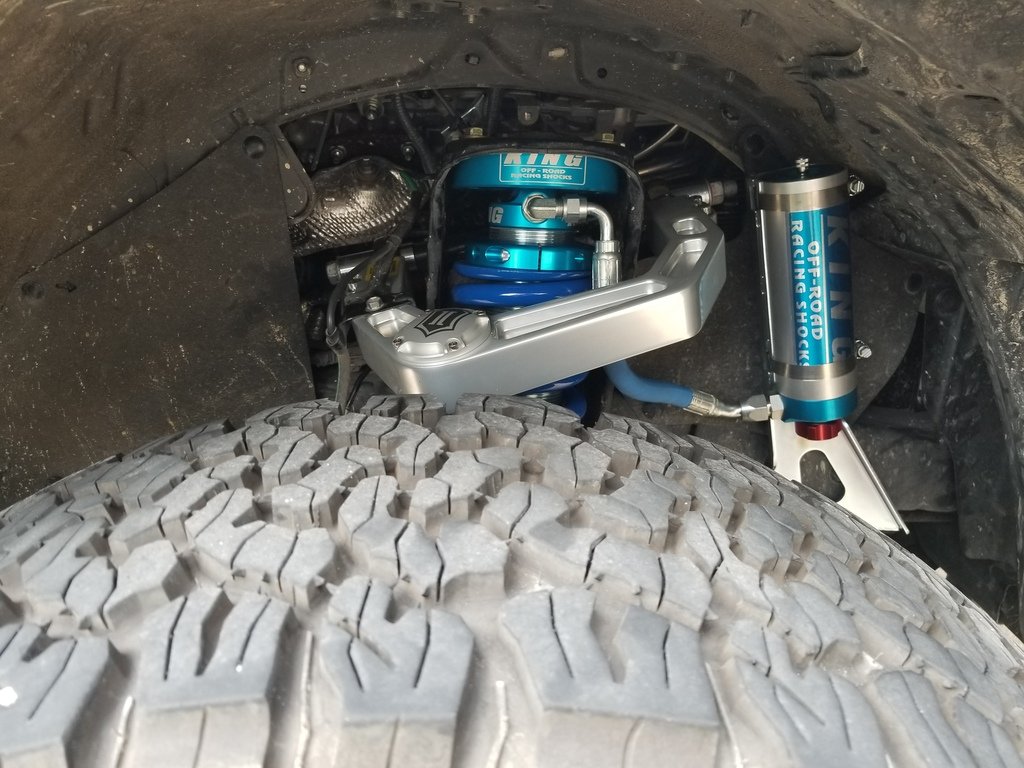

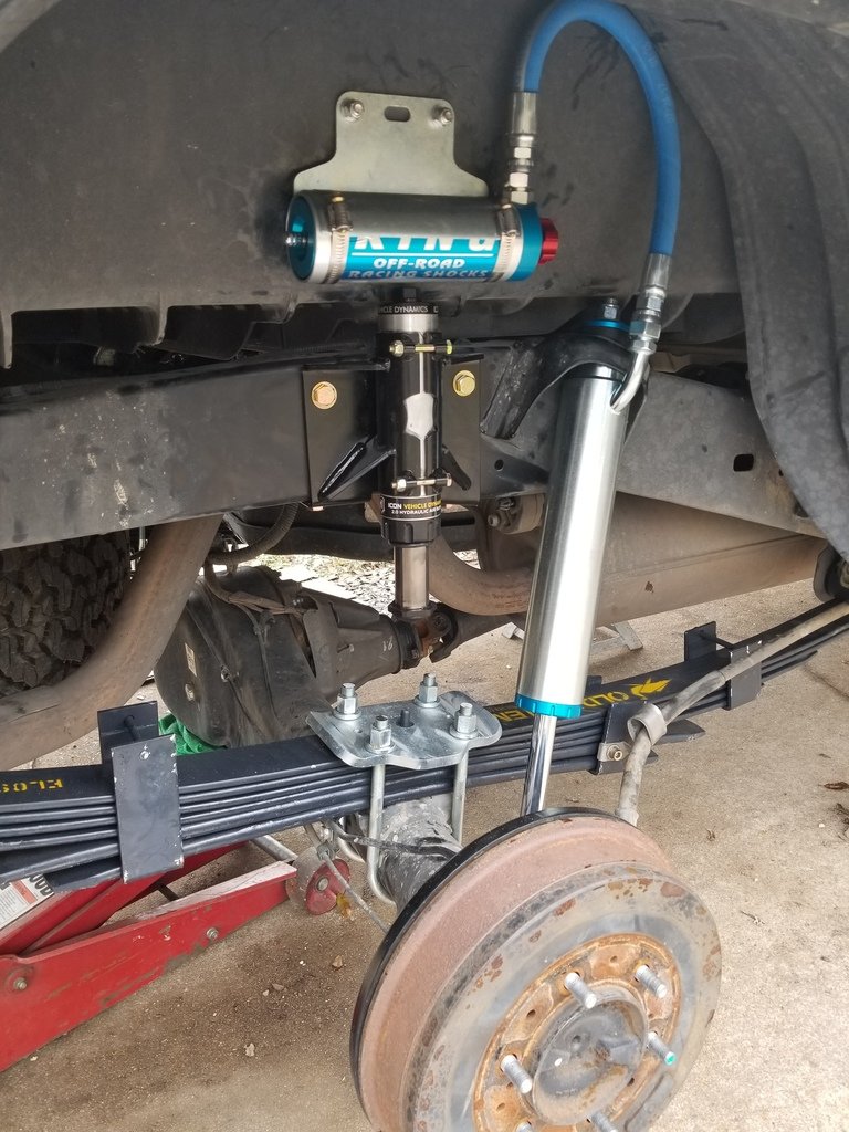

    Got mine installed a week ago and am waiting on everything to settle down before cranking up the collars on the fronts and revisiting the alignment shop. The Icon upper control arm uniballs were incredible tight when they first went on and the steering wheel would not recenter when coming out of a turn or going down the highway. I have about 150 miles on them now and they are loosening some, have not had a chance to utilize the Icon rear bump stops yet. Relocated the King reservoir mounts to clear the bump stops with some button head stainless fasteners, might make some different mounts later with different lines to get them on the frame.

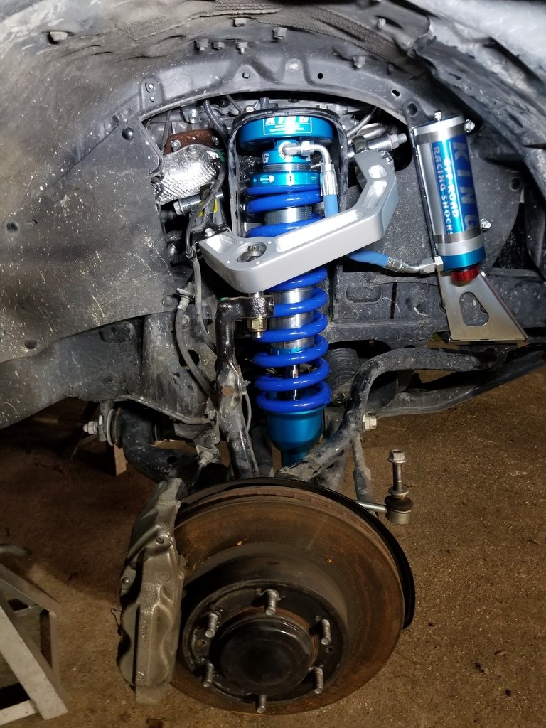

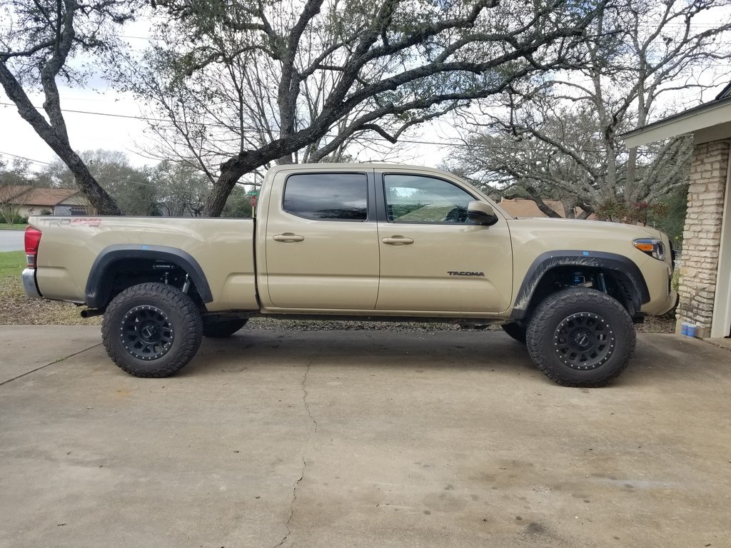

    1.25" of lift out of the passenger side and cranked the drivers side up a couple of rotations to combat Taco Lean and match the hub to fender lip measurement on the passenger side. On the Dakar 095 rear springs I received two "+" marked leafs and put what I thought might be the little bit taller one on the drivers side. After taking measurements though and adjusting the drivers side front I still have 1/2" difference in the rear with the passenger being taller. With my OCD it will not let me leave it as is so I am going to swap leafs to see if it helps, if it doesn't I will be swapping them back again, sometimes I wish I could just ignore things and let them go......

    @Pipeworx what U-Bolt flip/Strike Plate kit is that you are using?

    Purchased it from Wheelers Off-Road, very happy with it and cut down the u-bolts about an inch after getting them installed and torqued.

    Roger that, will look into it. Do the bump stops line up square with the strike plate?

    They look close enough without total compression of the springs. As the rear leafs compress they move rearwards with the shackles slightly and I am confident enough to use these. The Icon bumps were cheap enough and I did not want rubber bump stops that would need to be replaced instead of rebuilt for 1/3 the price...... cry once.
