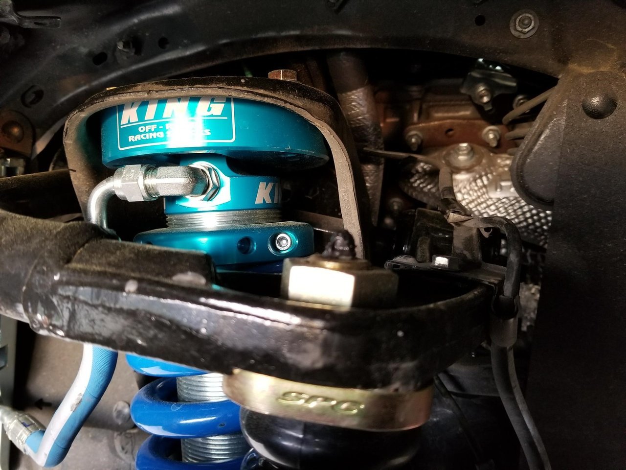

    He was talking about rear not front. Front is the one with the spacer for extended travel. Rear you have to swap out the bottom mount 25DEAF76-AA54-48B9-9074-4CE363C8E19F.jpg

    So how much length does that different lower mount add?

    I think it’s 1” over the normal mount
