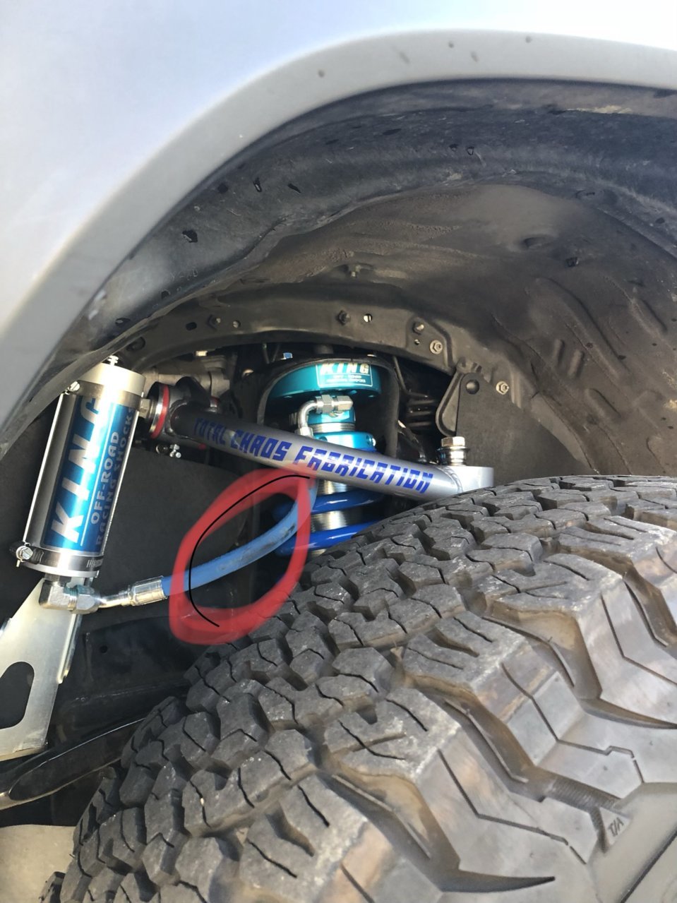

    Hey all,
    Just got my Kings installed. I see there is some black smudge on the hose(pictured). I turned my tire full lock and it doesn’t look like it is rubbing at all. Could this just be from kick up from the tires? Thanks!

    Exterior: King suspension w/compression adjusters Icon billet UCAs Icon 3 leaf expansion pack Timbren rear bump stops w/U bolt flip kit Wheeler’s Offroad front superbumps BFG KO2 285/70/R17 on SCS Ray 10 17” wheels w/black wheel lock lug nuts TRD Pro grill TRD Pro taillights TRD Pro skid plate Demello Offroad front bumper Smittybilt XRC 9.5 comp winch w/Factor 55 fairlead and Flatlink E RCI LCA skids Beast Fab rock sliders 4 Extreme LED 4” pods Baja Design Squadron SAE LED amber fog lights Relentless Fab bedrail mount w/KC Flex dual amber chase lights AVS vent visors Interior: TRD Pro shift knob OEM instrument switch panel conversion (from 3 to 5 slots) Taco Garage DMM with Scosche Magicmount Upgraded Kicker sound system Husky X-act floor liners Performance: Airaid cold air intake system Pedal Commander w/Bluetooth
    Although rare, especially with tc UCAs, I’ve heard of boxed UCAs rubbing the hose sometimes. Just try to see if your UCAs touch the hose at full droop.

    272
    2018 TRD OR
    Ah okay. Is there a fix to this if it is the UCA making contact?

    SOLD: 2016 White TRD Sport DCSB 4x4
    Not sure to be honest but I would imagine adjusting your alignment would slightly change the angles on it. Unless somehow you got a bad batch and they installed a shorter hose on it which I doubt it but it’s a possibility. Call Kings and tell them if you do find rubbing.

  20. Mar 27, 2018 at 9:04 PM
    #920
    Pipeworx
    Pipeworx Well-Known Member
    Aug 20, 2016
    #195087
    85
