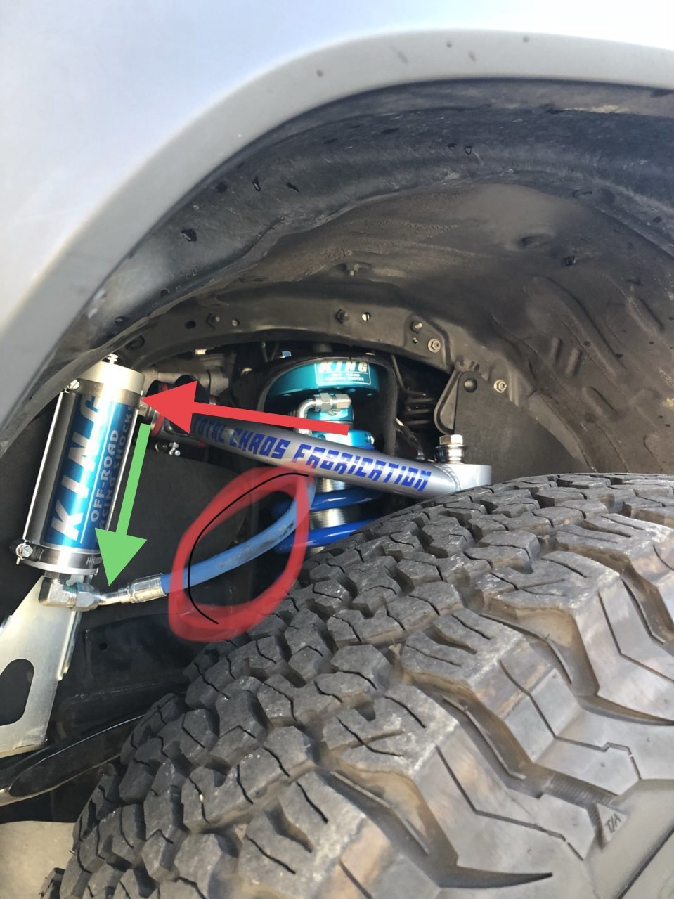

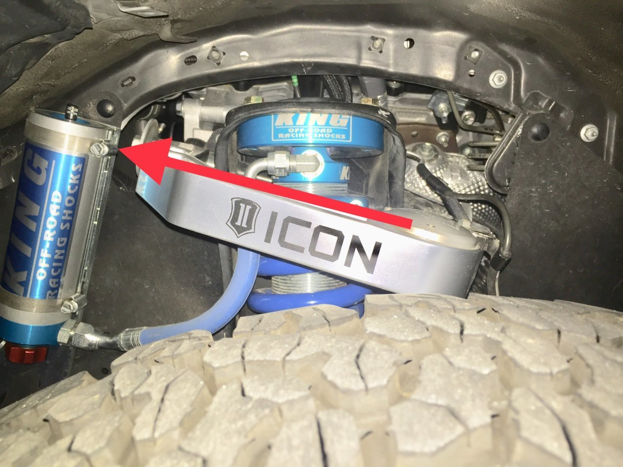

    Actually after looking at yours then mine, you can try to slide the reservoir down a little more first and see if that helps it. Although comparing ours, my hose looks like it has more give which is weird.

    Now that you pointed that out it does kind of looks like that.

    Thanks guys I’m going to try and see what I can tommrow. I will have to drive it a little hopefully it doesn’t do any damage.

    It is kinda weird though. When I turn my tire full rotation it’s not close to making contact. I almost wonder if the scuff occurred during the alignment process.

    Those hoses are tough and a little tire rub is not going to rub through it any time soon. Also those hoses are easily replaced although you have to recharge the system with nitrogen, worse case throw a zip tie on it to pull the hose more towards the inner wheel well, this is a temporary fix though.

    Okay that was my next question. They seem super sturdy.

    While driving slow speed in a parking lot with your windows down turn the wheel from full lock to lock and do some cirles trying to ride over some rough areas of the parking lot to cycle the suspension. If your tire is rubbing then you will hear it make a noise on the side lugs of those BFG's. I think it might have happened during the alignment, a dirty hand might have grabbed the nice blue line on accident.

    I’d say clean it up so you can see if new marks appear. Some have just added hose wraps until they rebuild them down the road and upgrade the hose and that’s typically for those that run boxes UCAs.
