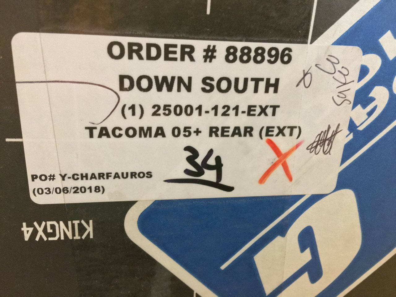

    Hella stoked my rear set finally arrived. Ordered them on March 6, and they just came in yesterday. Looking forward to getting them installed, but the lift kit for my wife’s 4Runner came in last week, so that project takes priority.

    Nice! Still waiting for my rear set up. I do have the front set up.

    Same here, initially had my front coilovers in March since they had them in stock, been sitting on them a bit while waiting on the UCA’s and rear leaf packs to get delivered, stoked to get started as all the suspension components are finally in.
