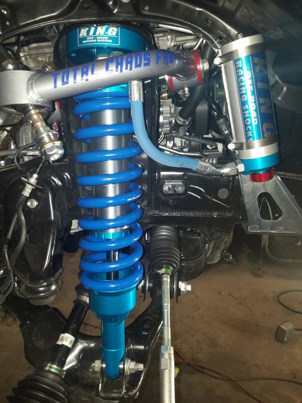

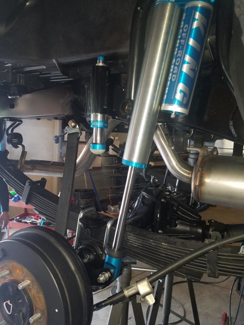

  15. May 5, 2018 at 1:45 PM
    #1075
    H3llRid3r
    H3llRid3r Well-Known Member
    Jan 23, 2017
    #208396
    3,449
    SLcUT
    2018 DCSB Cement TRD OR
    Not much stock left.
    New King’s installed. The truck is getting close to completion.
    AF64C9B8-8F7E-44EF-A70E-B6B19EE5782B.jpg D0008FDA-A3E7-4B14-9696-ECA72B2A4551.jpg

    2.5s in the rear?
  20. May 7, 2018 at 7:13 AM
    #1080
    H3llRid3r
    Jan 23, 2017
    #208396
    3,449
    SLcUT
    Yes sir.
