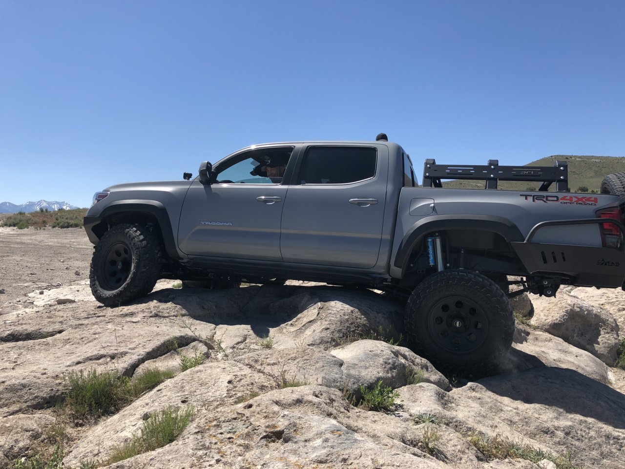

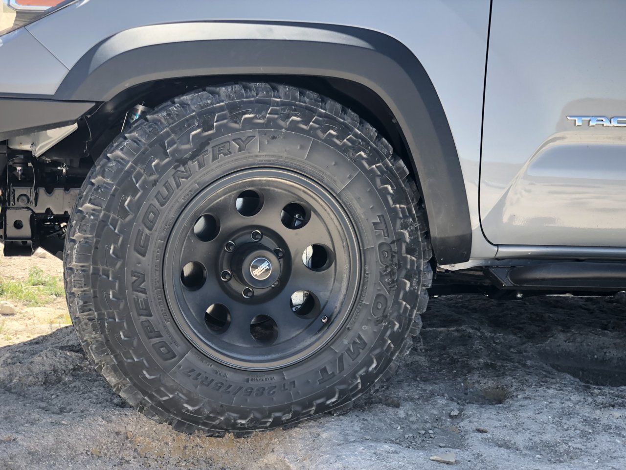

  14. Jun 2, 2018 at 5:55 PM
    #1174
    H3llRid3r
    H3llRid3r Well-Known Member
    Jan 23, 2017
    #208396
    3,450
    SLcUT
    2018 DCSB Cement TRD OR
    Not much stock left.
    Broke the Kings in today.
    B051CD71-7DB4-4596-8F2A-FE2E696B1032.jpg 85710BE7-B972-4499-8EAB-8930A5109CCE.jpg

    Anyone experiencing chirping noises when they off road?...at first i thought it was my leaf springs but i noticed on my last run its actually coming from the front.
  16. Jun 3, 2018 at 9:41 AM
    #1176
    H3llRid3r
    Jan 23, 2017
    #208396
    3,450
    SLcUT
    I get more of a thud sound, but I think it’s from the Deavers. I can’t 100% determine it one way or the other. I’m told that the way the Kings are valved can cause a chirp or maybe more of a hiss. I’ve not heard that yet.
