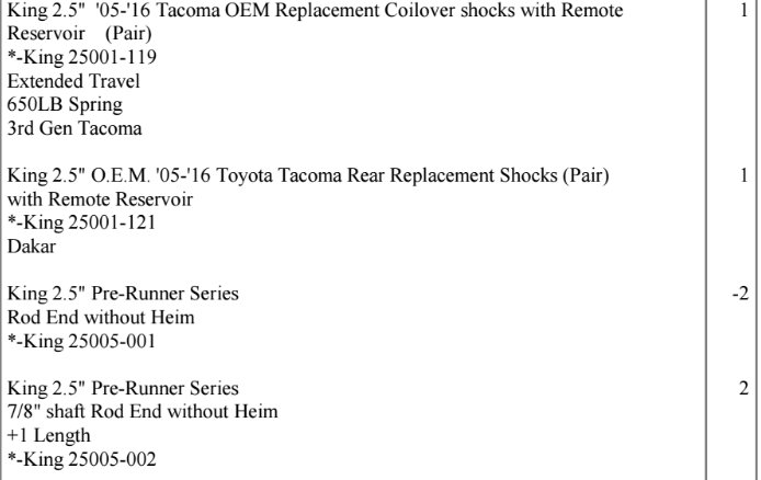

    For people with Dakar rear leafs, were these shocks long enough for full droop/flex? I heard DSM does some mods specifically for Dakars, but they haven't answered my email on what they specifically do or if it's required.

    Checked on DSM's website and I only see the extended travel versions for the front. Do you have a part number for the rear extended travels?

    This is my order receipt from DSM. They're not extended travel technically for the rear I guess.... See below

    Taking a guess here but DSM might have customized yours to work with the Dakars specifically, since you have "Dakar" noted as a line item.

    Actually, from the invoice, it looks it's still under the rear shocks line item. -2 quantity removed from 25005-001 (standard length rod end) and +2 quantity on 25005-002 (+1" length). Looks like that's what they do for Dakars.

    Here is the answer from dsm them self!:thumbsup:

    1" from the rod ends. Do they actually shorten the piston and rod to have a shorter extended and collapsed length?
