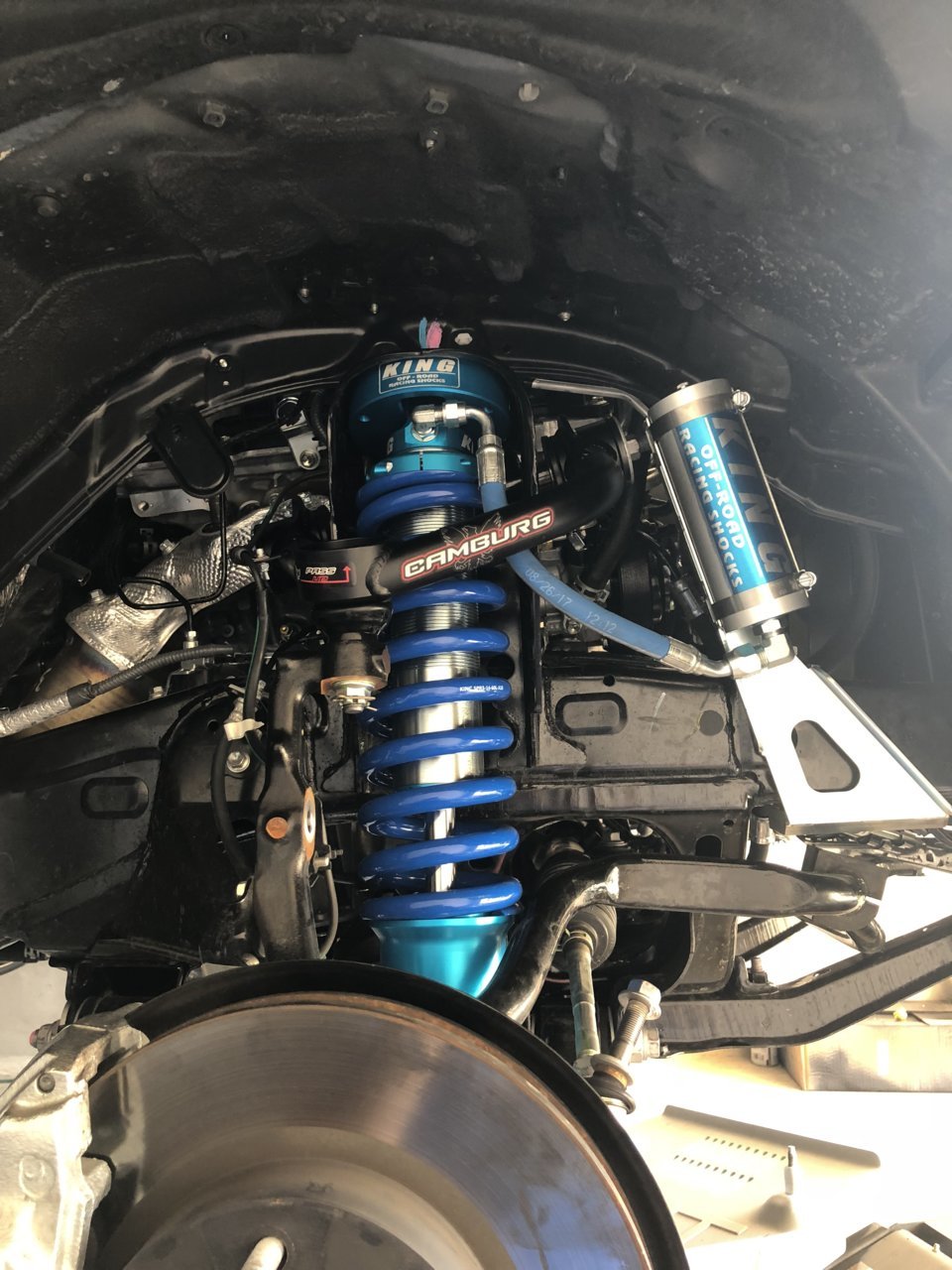

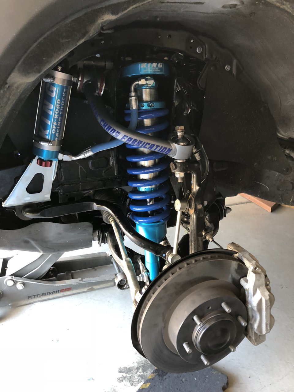

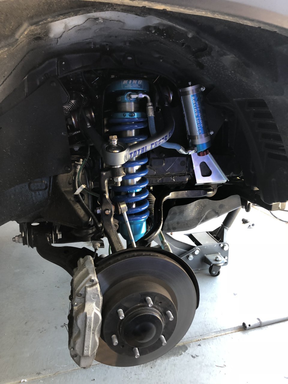

    Built it for a good friend of mine. For on road drivability, I left the sway bar on. Finished product-

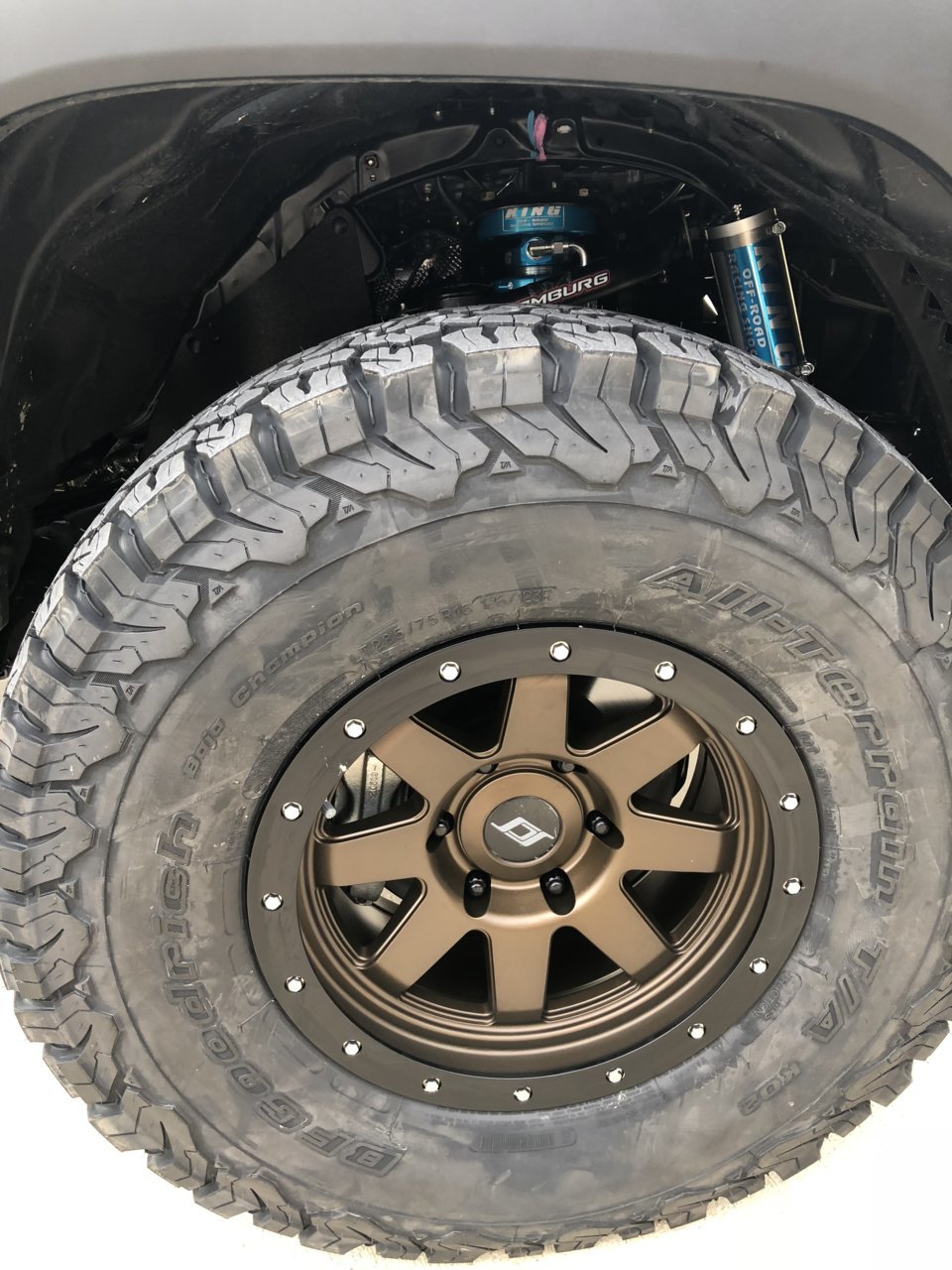

    I have king extended with adjusters all around with TC arms and Dakar leafs from DSM. Question tho, I believe I have a 600 spring and I have 11-11.5 threads showing on driver and 10-10.5 threads on passenger side. My 285/70/17 still rub it looks like the cab mount coming off the driveway with the wheel turned. I’ll post some pics but what’s everyone running as far as threads showing with the 600 spring. No weight up front. My wheels are Scs with -10 offset. It was a pain in the ass to adjust these. I hope I’m right on target but not sure if the springs have settled yet or not. How much rubbing are you guys getting on the cab mount with this setup? Thanks 0DB5F33C-09DA-42E9-817F-8C5DDBE02C29.jpg66734882-19FF-4919-A275-F773B716F489.jpg A9381AC9-8C63-4235-86B0-BBBA543C7842.jpg

    I'm running the same setup with the same wheels in 285-16s. I rub more on the front bumper than I do on the cab mount. I could probably crank up the coilovers and get away without the cmc. I dont want to mess with ride quality and even doing that I'll still rub offroad so I'm just going to bite the bullet and have it done.

    Have you done a CMC? You might have too much of a negative off set on your wheels. I have the SCS wheels as well, but did a large CMC with no rub. I’ve read that some have issues with the SCS wheels rubbing even with the CMC.

    I do not have the CMC done yet but I ordered the plates from bamf and another thing is I haven’t gotten it aligned just yet either and I know it’s way off so not sure if that is contributing. Right now Im hoping the 11ish so threads on the driver side is good enough. Are people going more than that? I am currently not rubbing but it’s about a 1/16th to 1/8th from it and like I said if I turn and hit a decline it will rub. I’m just trying to compensate for any settling too. Ya there is a lot of offset with these wheels so it’s def not helping me! Looks awesome tho. So you guys think I should leave it here or go one more turn in that would expose about 12ish threads. I think that would give me at least an 1/8 to 1/4 from the cab mount. Then align it and should be good. Well, then do the cmc just for extra clearance.

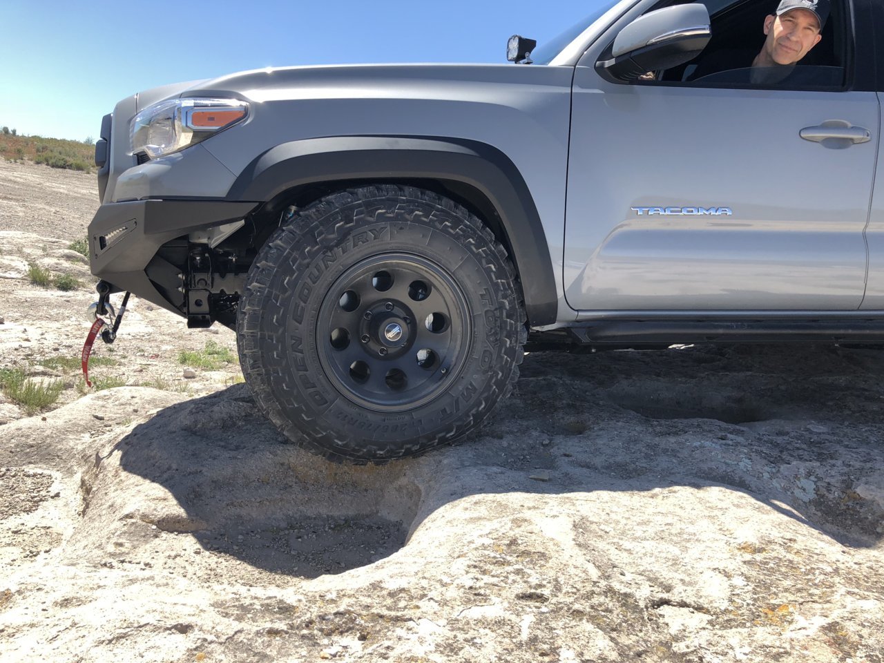

    I’m not an expert on these matters, so take it with a grain of salt, but I would recommend a CMC and take everything you can. Then have them push the wheel as forward as possible with the alignment. At least that’s what I did and I have no rubbing on the CMC at full lock. When the tires are stuffed I do get some rub on the inner fender plastic but WTF! It’s plastic.

    Pushing the wheel forward was a suggestion another TW member gave me, when I was trying to get 315’s to fit, the shop doing the alignment seemed to know what that meant. Unfortunately, that’s the best description I can give you.
    I don’t recall if you said you replaced the UCA or not, but I believe it’s accomplished through the UCA. I have the TC uniball upper. Someone with more knowledge might be able to explain better.
    I have about an 1-1/4” of threads showing on mine.
