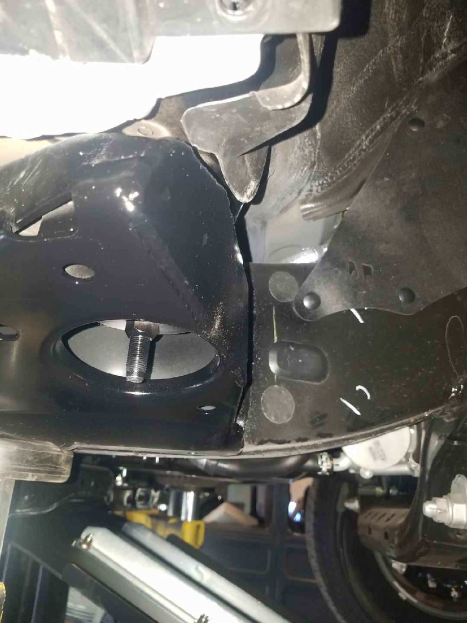

    When you say you rub at the inner fender plastic what do you mean exactly? Because I think im in the exact same boat as you.

    Like this spot?:

    No, that part has all been cut away. It looks like I had it cut to far up, so the plastic started to curl in and would catch on the tire when it was stuffed. I’ve since taken a heat gun to it. One side looks good the other side is going to require another treatment. Eventually, it’s going to come out.

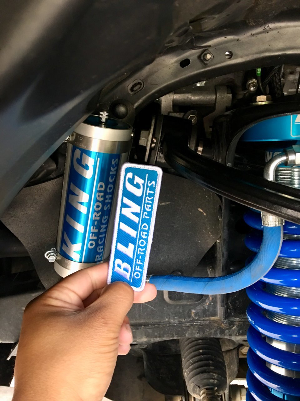

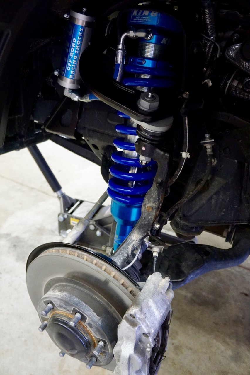

    Appreciate all the help and feedback from everyone in the thread. Finally got around to installing the new suspension. Pretty stoked with the outcome so far, gonna give everything a once over in about 100 miles, and hopefully take it on a shake down run.97387850-749F-4314-8BDB-33E3CE079B3D.jpg C94E3380-9338-4B39-B8D7-AAC663360AAE.jpg
