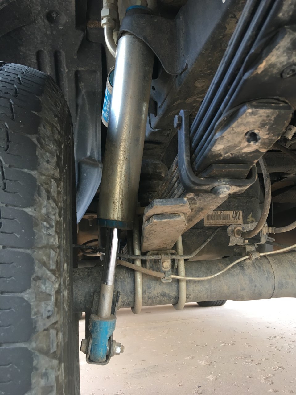

    Should be just fine. The Timbrens are progressive and will prevent the shock from fully bottoming out.
    I don’t offroad crazy or fast. Mostly rock crawling and forest roads without heavy bed load and my shocks have been compressed as far as they will go and have about 1.5” space before bottoming out.
    You can see in the pic below the clean and dirty part of the shock travel. Ignore my janking leafs. The overloads twist when unloaded at full droop.

    Thanks for replying and a fancy photo! Mine have longer bottom mount, which appears to be shorter that your dirty space. lol
    I don't go crazy neither. I took a little stoll on forest road last week, I'm planning on some low speed rock crawling etc. So I'm being hopeful that this set up will work ok.
    Now about your leafs.... You sure your U bolts are tight?

    Oh ya that are way tight. I have to use a sledge to move them back but they don’t hurt anything.
    I greased the leaf pack before assembling them and installing them so I think that is what allows them to twist a bit.

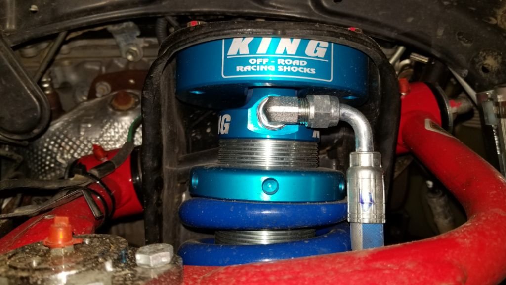

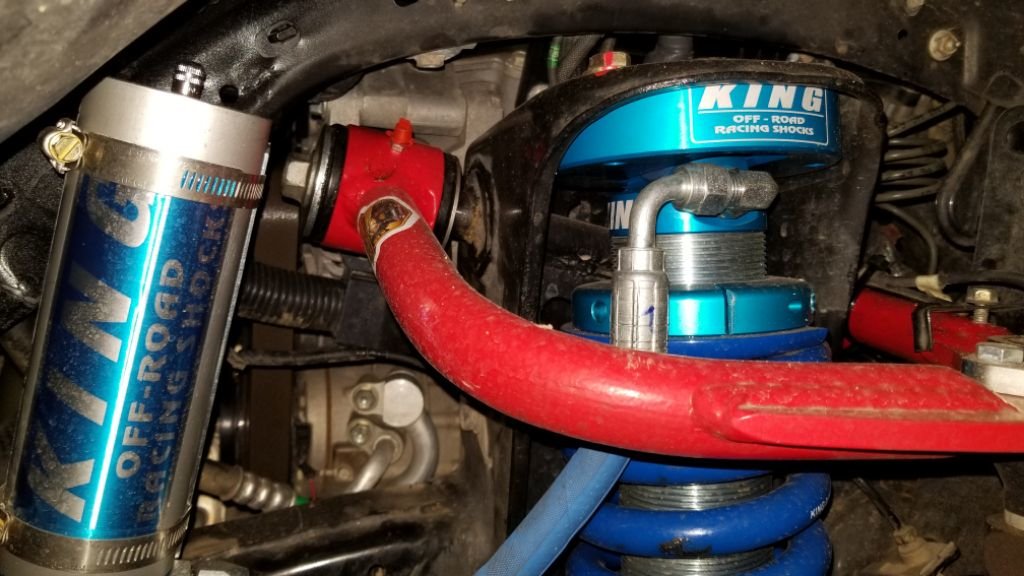

    OK, so I went out and checked
    So, there they are - 650 lbs springs--with full steel skids and sliders, but still stock bumper (no winch). Apparently front settled 1/2 inch in last 2 weeks and ~700 miles... On my slightly sloped driveway, I sporting 22 1/2 inches hub to fender in the front, and 23 1/2 in the rear (almost out of fuel). I'd say ride is firm but smooth, no jarring or whatever. I have a squeak on driver side, and slight "tap" on pass side when going over bumps. I'll have to go over all the bolts with a torque wrench maybe this weekend.
    Probably I'm not helping much, but at least you have something to compare.
