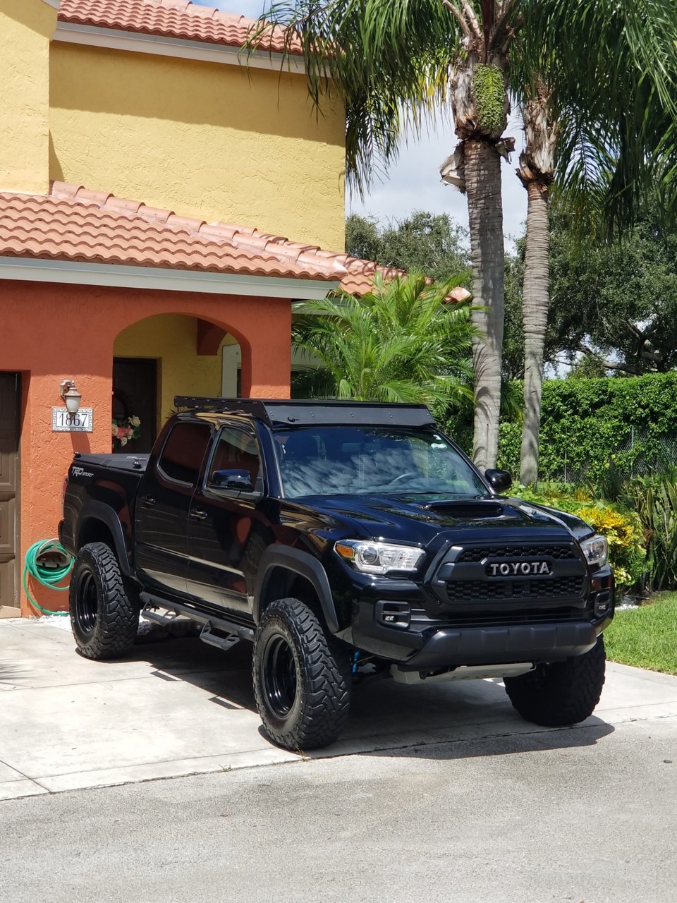

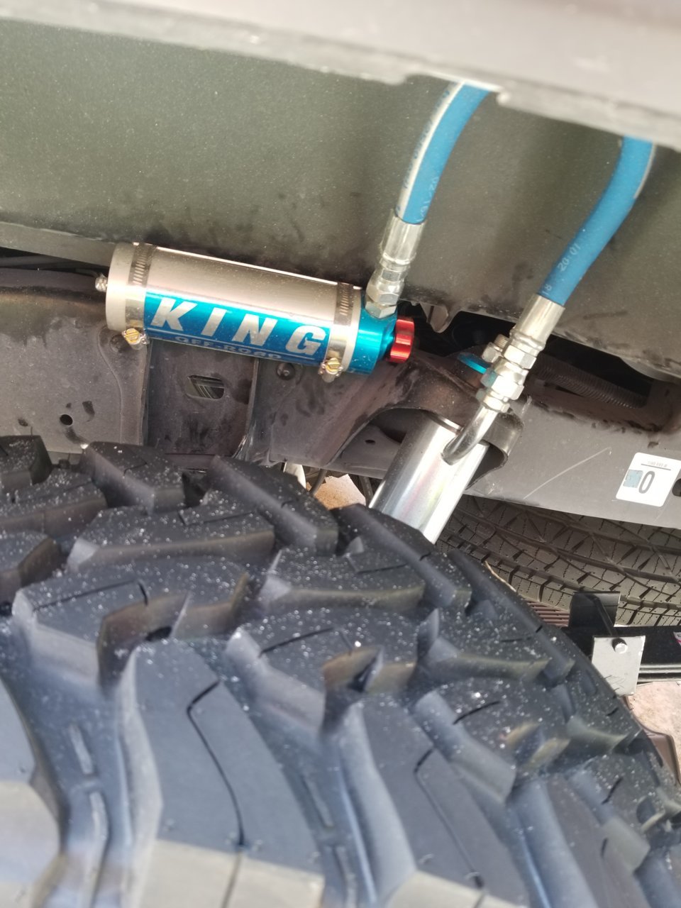

    Finally got my suspension installed last week. Rain prevented me from getting pics earlier, but I snapped a few recently during a brief period of sunlight.

    not hating. but you're a 4x2. that's some serious mall crawling action. yo.

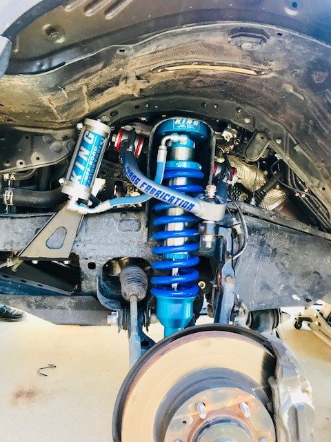

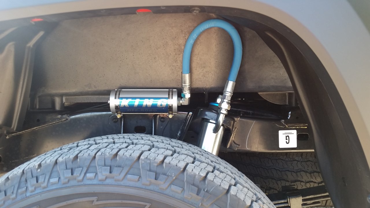

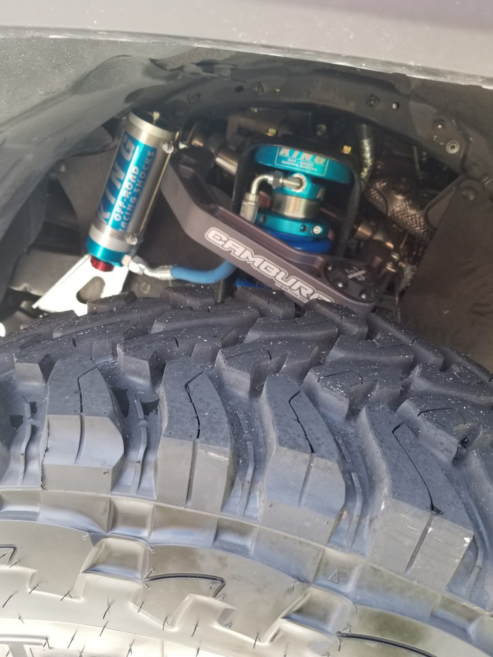

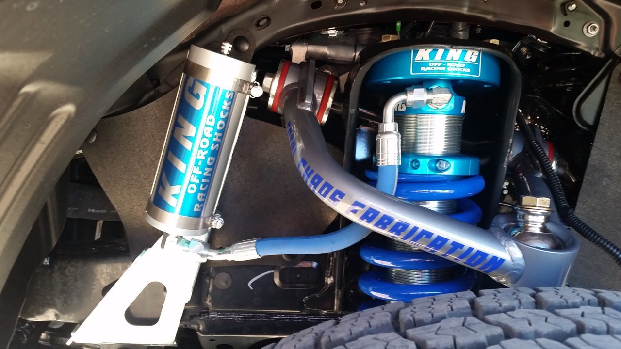

    20180810_165025.jpg 20180810_165012.jpg 20180825_183052.jpg 3.0 with Total Chaos UCA's and Deaver leaf packs. I have about 1.5" of preload and an extra two threads on the driver side to accommodate for the extra weight on that side from the driver. I will be doing Total Chaos LCA's in the very near future. The on road ride is phenomenal and offroad they handle the woops and the bumps as you would expect. Like butter.

    I thought the 3.0 came with finned reservoirs and a different top hat. Those kinda look like what I’m running which are 2.5s

    Same here.. maybe he meant 3.0” worth of lift?
