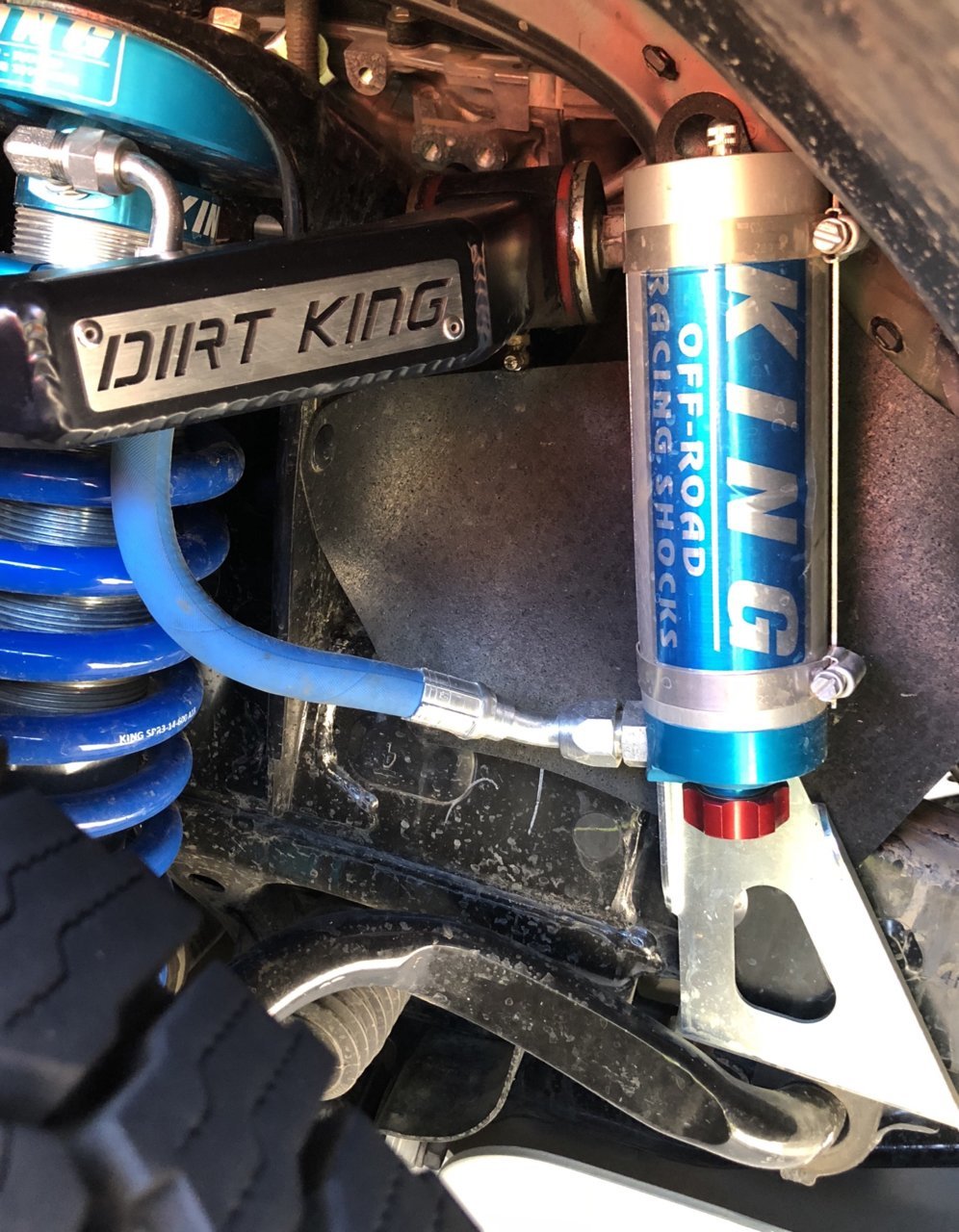

    Anyone have a resi mount they can take a picture of. My hose is rubbing my upper arm a little eating away at it.

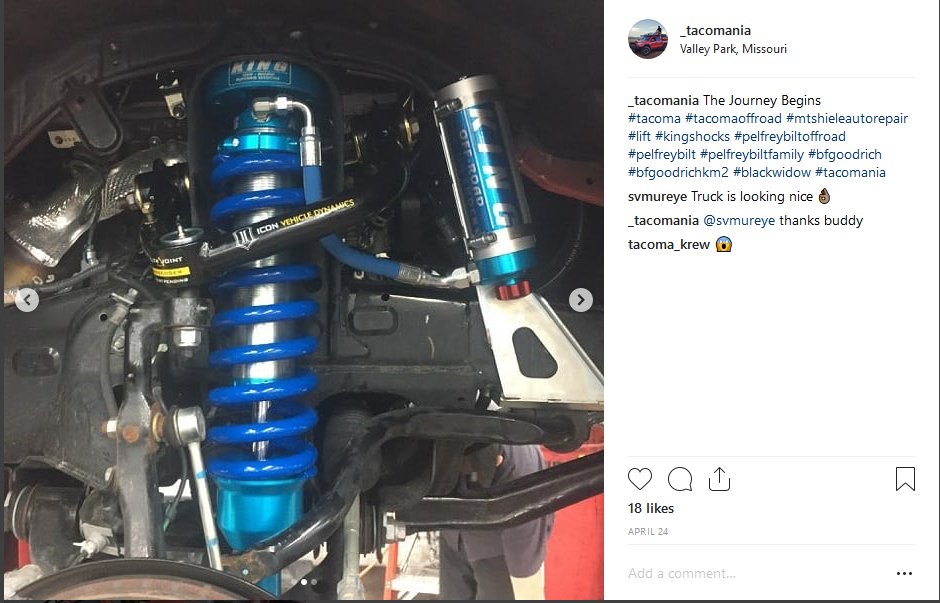

    anyone have a pelfrey bumper and running king's? does the reservoir mount interfere with the pelfrey bumper support? i have icon brackets. will those work?

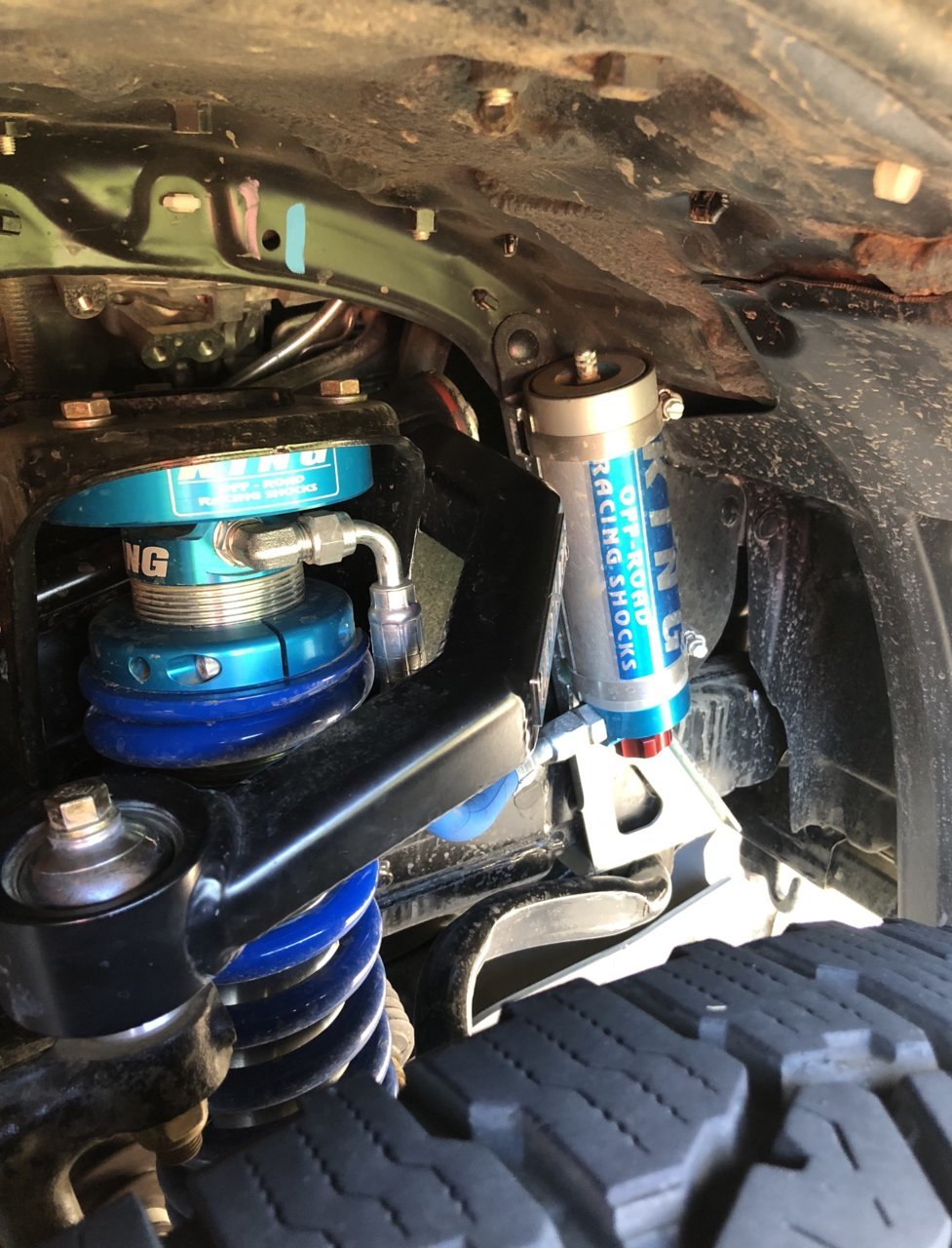

    Toki
    Toki Don’t get killed by Theta.
    Mar 28, 2018
    #248758
    532
    Jon
    San Jose, Ca
    2018 Tacoma 4x4
    Little bit of this and a little bit of that but stock af.
    44330C07-ED7D-4B0C-8558-A31C8A540E9F.jpg 65FC1B2E-1585-48A2-8564-F0A4E085326B.jpg
    Lord Helmet likes this.
  5. Oct 2, 2018 at 4:31 PM
    #1405
    Clay700
    Clay700 Well-Known Member
    Jun 19, 2016
    #189995
    176
    Clayton
    2016 tacoma trd offroad
    Thanks! Who makes those mouts?
  6. Oct 2, 2018 at 4:31 PM
    #1406
    Toki
    Mar 28, 2018
    #248758
    532
    Jon
    San Jose, Ca
    2018 Tacoma 4x4
    Came with my kings
    Tacomania likes this.

    mcharfauros IG: mcharfauros
    Apr 21, 2017
    #216893
    4,256
    MO
    2017 Black TRD OR DC
    Dumb Truck Thangs
    @hirod My buddy @Tacomania is rocking Kings with his Pelfreybilt Bumper. His bumper was already mounted up, but later Installed the bumper supports. Just remove the reservoir brackets and install the bumper supports under the reservoir mounts using the longer bolts from king.

    Tacomania
    Tacomania IG: _tacomania
    Sep 21, 2017
    #230668
    3,836
    Crazy Mike
    86 4runner / 2016 SR5 Tundra
    like @mcharfauros noted it does not, ill try and get pics for you and upload. i dont think icons would be any different unless their mounts are different, which i wouldnt think they would be. I just saw that @Toki is a perfect example, mine are the same...

    hirod
    hirod Well-Known Member
    Jun 3, 2013
    #105540
    1,245
    hawaii
    16 double cab short bed OR

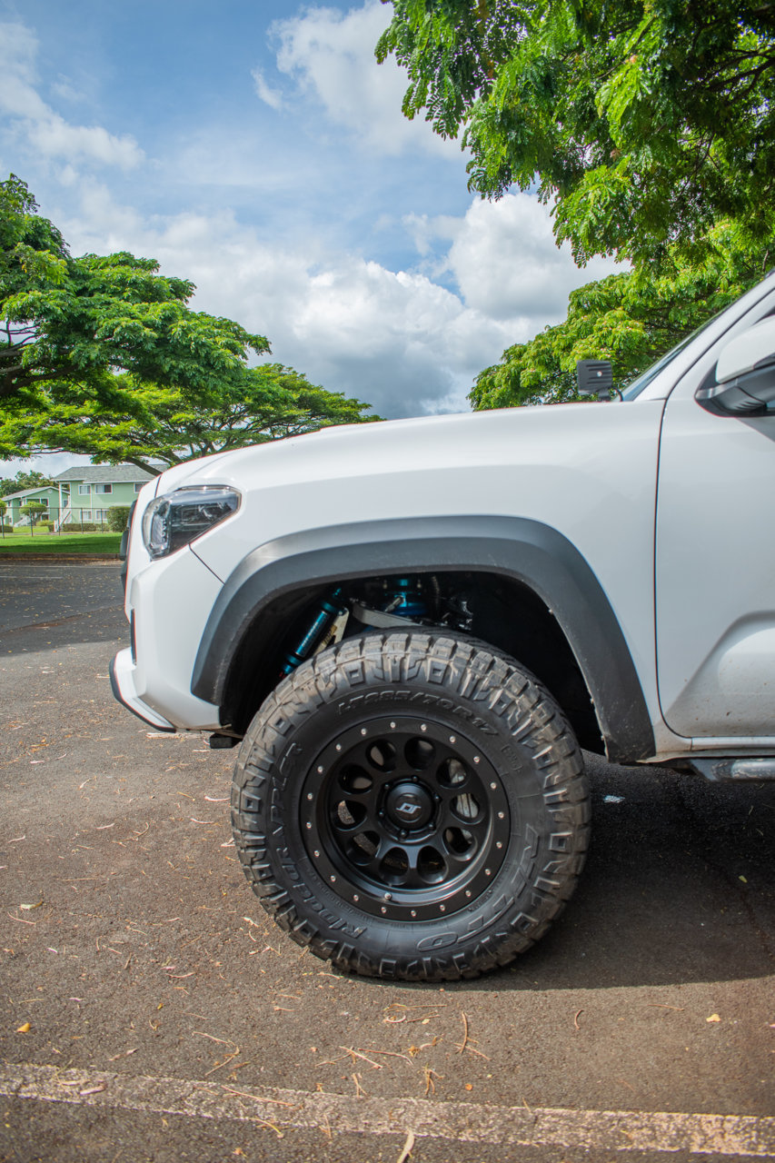

    thanks. picture worth thousand words. I'll give that a try. icon mounts are sheetmetal so they can squeeze in between the frame and brace.

  15. Oct 8, 2018 at 12:06 PM
    #1415
    hirod
    Jun 3, 2013
    #105540
    1,245
    hawaii
    installed mine this weekend. used same spring compressed length measurement to set the springs in the king's (i used icon springs because they're black) and got the ride height same as before. no adjustments needed. reused the icon resevoir holder in front because i have a project in mind for the king's. surprised i could tell the difference between the kings and icons.
