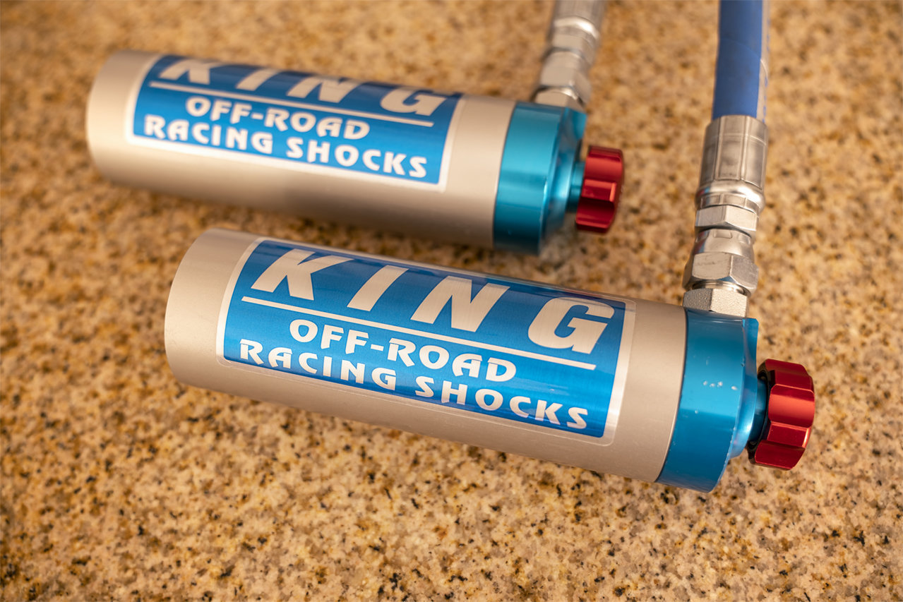

    Anybody else receive their King suspension a bit banged up? Just received my rears today, and they have a lot of nicks and scrapes around the anodized parts, and the part where the hose attached to anodized portion of the reservoir are two different shades of blue. I know they'll get banged up anyway, but for what these are sold at, I rather be doing that myself.

    Doesn't look too bad on the pic, but I think you make a valid point , at those prices they should be flawless! Lol
    BTW, no issues with mine

    Didn't take pics of all the flaws, ones pictured are the minor ones, and variation in blue is hard to tell in the pics. Decided to return them and pay the difference to have black anodized instead of the blue since I haven't received my fronts yet.
    That's good that they changed it on their own decision.
