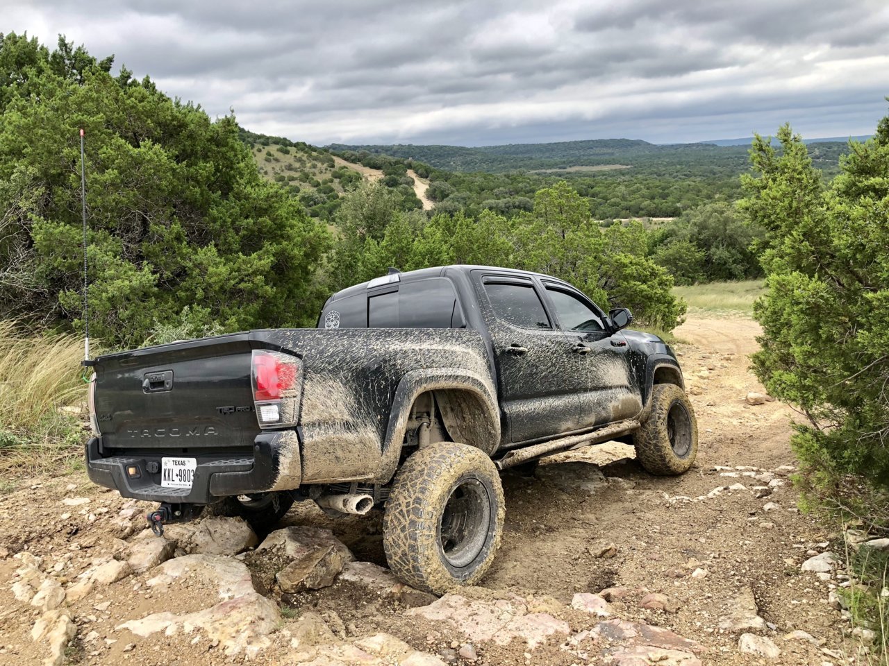

    Kings here. Gonna switch it up to maybe a chevy 63 and the 14in kings.

    Man...where was that trail/pic taken, looks awesome!

    That was hidden falls near austin tx. Cool offroadind park. Levels 1-5. That was level 2.. just typical 4x4 trail. There’s some awesome stuff there

    Nice looking rig :thumbsup:
