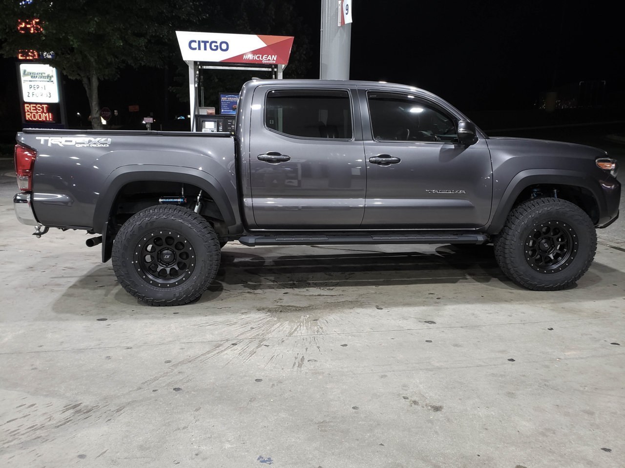

    Hey guys, i had the king lift installed recently. Is the front supposed to be this low compared to the back? It really bugs me.

    If it bugs you raise the front 3/4-1".

    I dont think the compression adjusters have anything to do with ride height right? So are you suggesting a spacer?

    You adjust the ride height by cranking down the blue ring right above the spring.
    You will most likely need an alignment after.
    Keep in ind if you carry any weight in the bed it will level out the truck. If it sits level without weight it will sag in the rear with weight in it.

    If you are maxed on preload adjustment now or at the suggested max specs from King, and still want armor, bumper, etc. you may want to consider 14 x 650lbs spring swap to get it closer to level with less preload. It will still ride pretty smooth when you dial down the firm / soft adjuster.

    That looks about right. You want more lift in the rear because the 2nd/3rd gen trucks have pretty limited up travel. You want the front close to 50/50 for the best performance.
    Throw 2 bags of cement in the bed and drive it that way for a couple weeks. The rear will settle some. You also want a little rake for when the truck is loaded so you’re not sagging ass or riding the bumps

    Thanks for everyone's reply, been huge help. Turns out I'm an idiot and didnt know that the front end can be adjusted on the coil over itself. My issue is that I'm rubbing and raising the front will solve the issue. I dont really plan on hauling anything yet but if I do start putting on bed racks and other overland gear/hardware, i might have to drop the front back down, or get stiffer springs in the rear is this correct?
