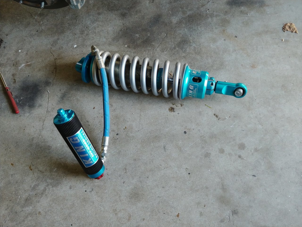

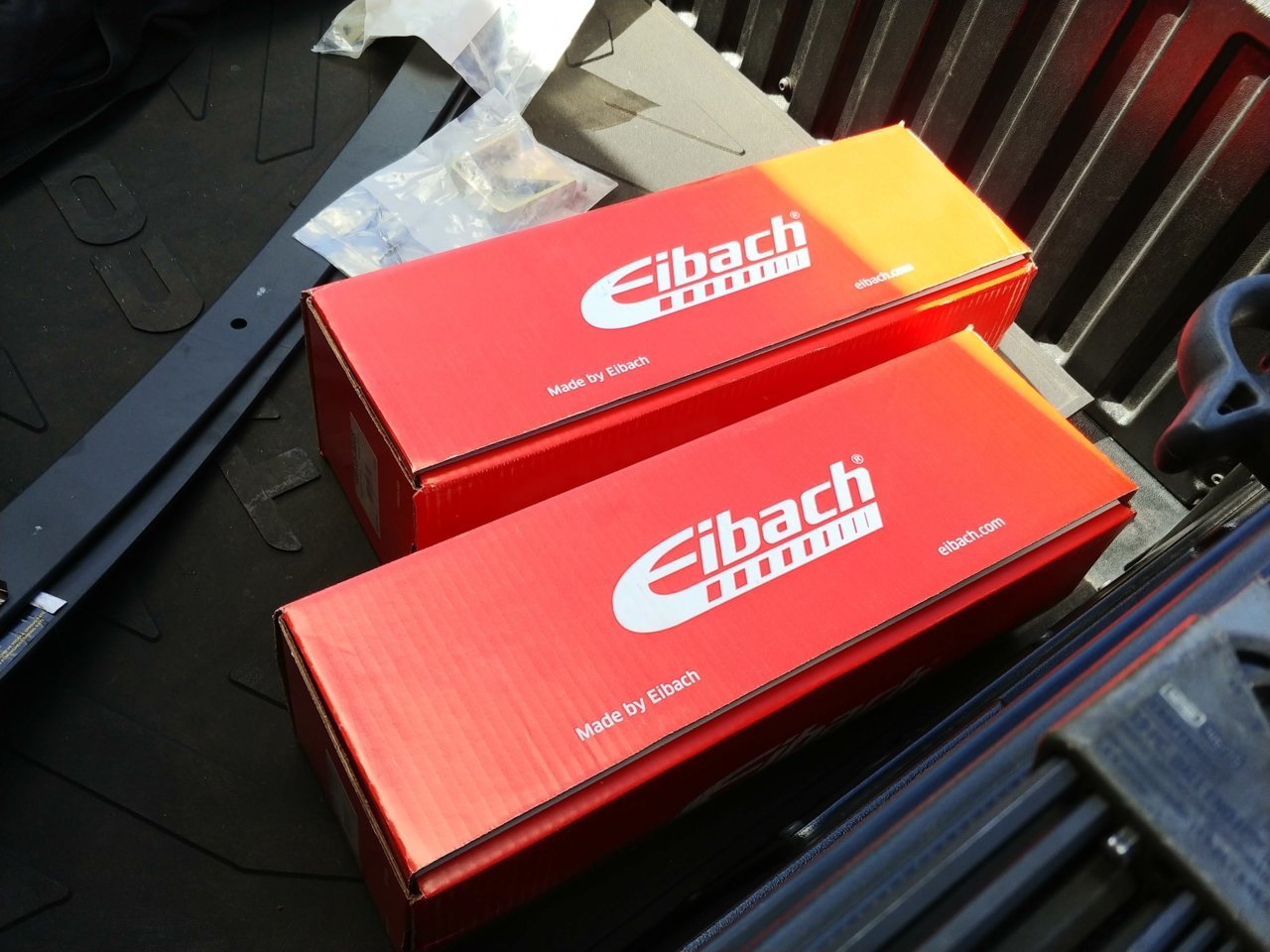

    Swapped out the stock king 550x15 for eibach 650x16 got rid of the 1.5” of rake I had.

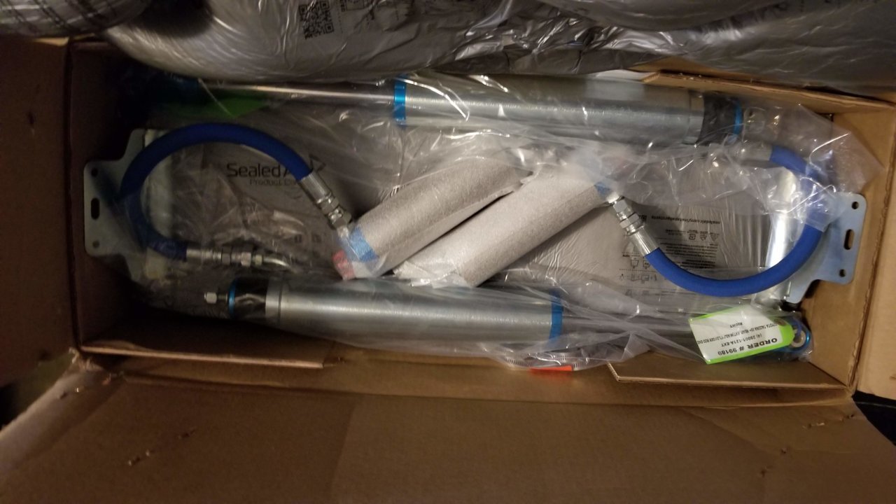

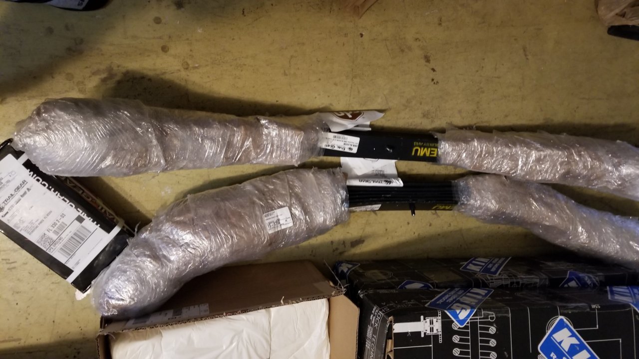

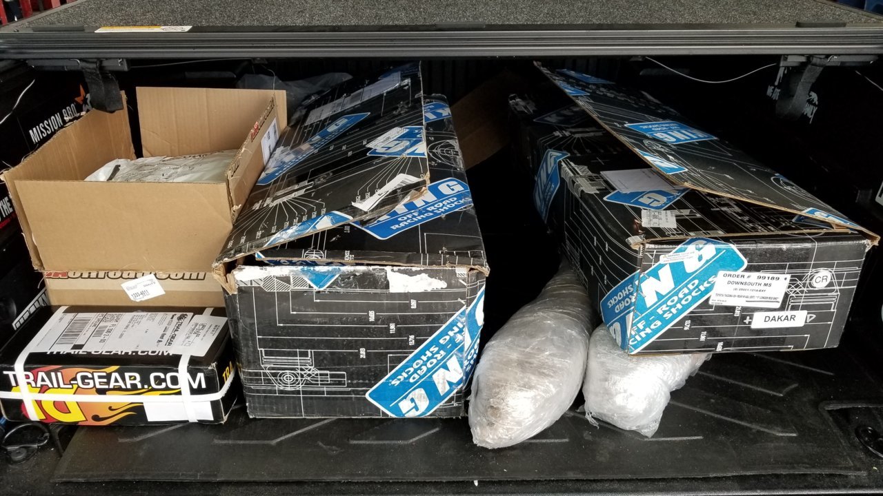

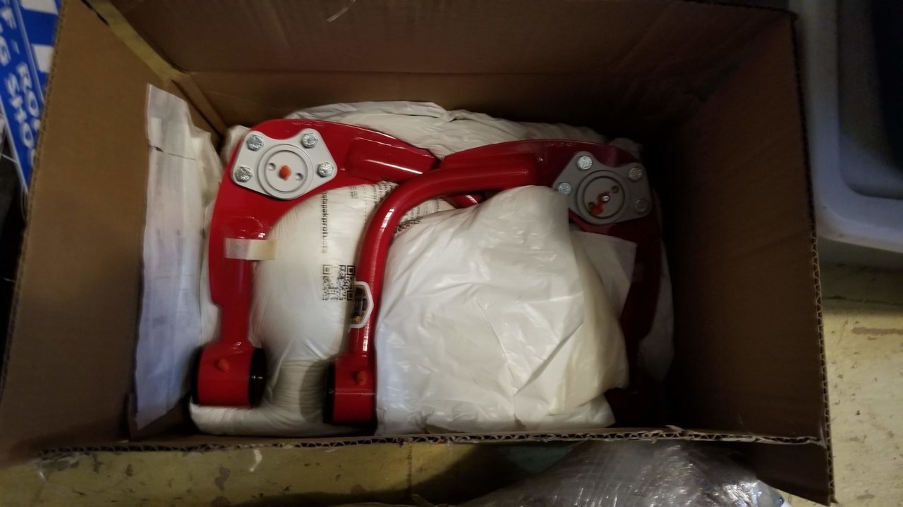

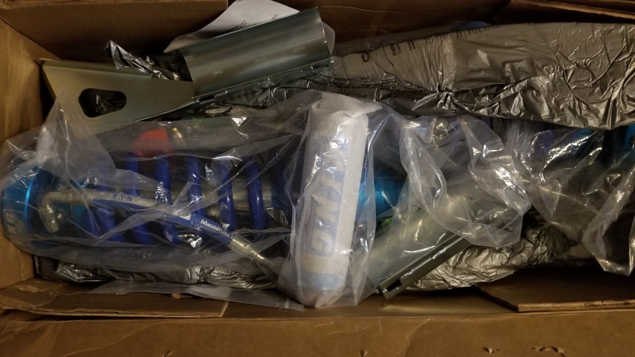

    Ok, got all the goodies. Hopefully being installed tomorrow. :fingerscrossed:. After all the reading, i believe that 8/9 threads is about 2.25" of lift.
    20181205_103201.jpg 20181205_103141.jpg 20181205_103131.jpg 20181205_103127.jpg 20181205_102057.jpg

    The factory preload is exactly like yours. I also got the #700 ext. I wonder if i should even touch the factory preload.

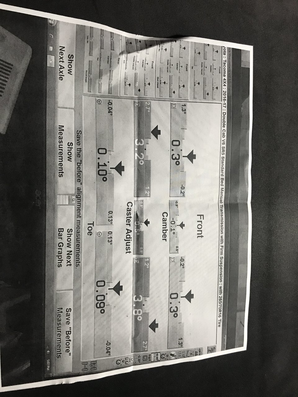

    How do these alignment specs line up with others? I've got TC UCAs.
