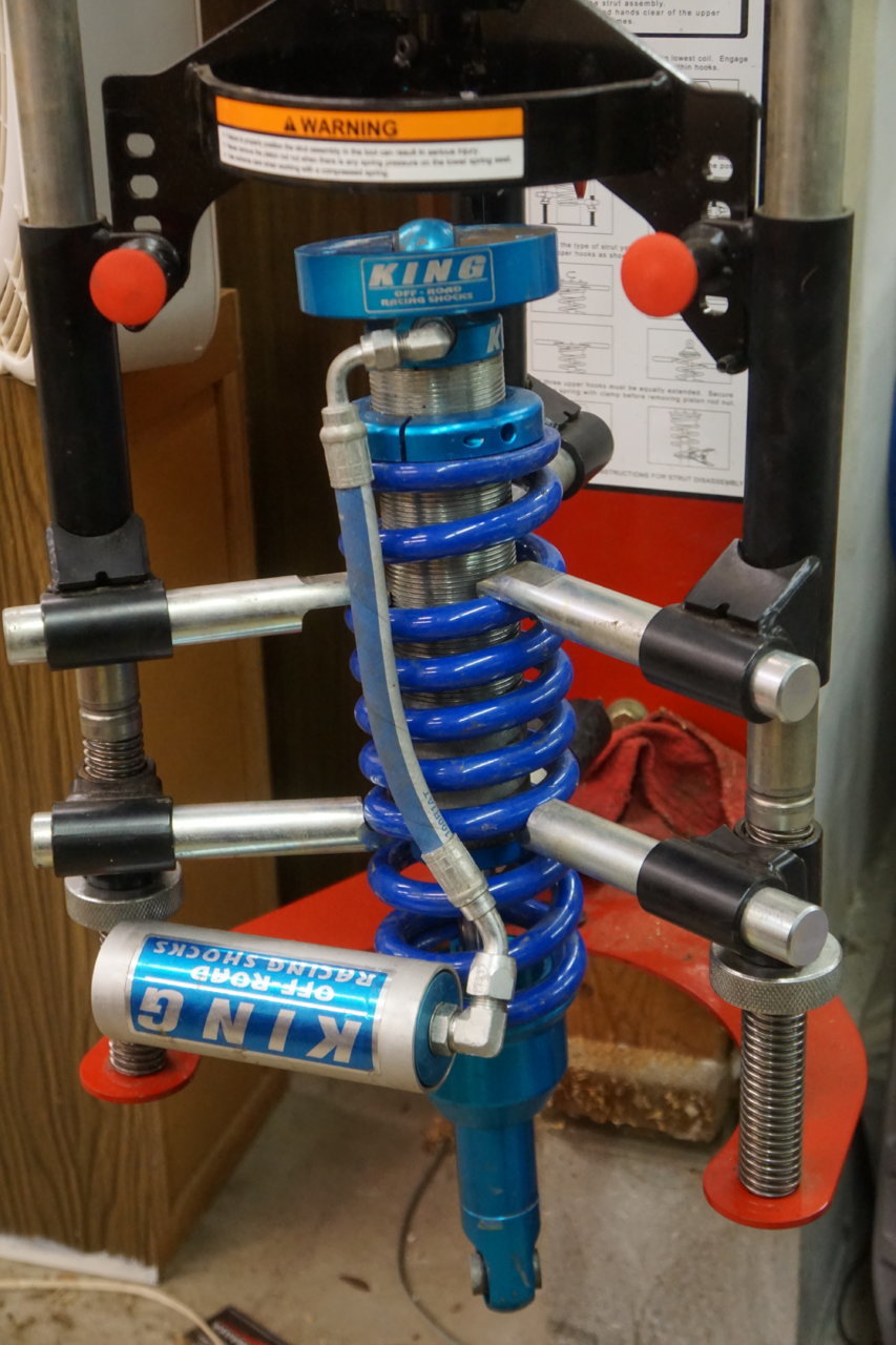

    #216893
    4,255
    MO
    2017 Black TRD OR DC
    Dumb Truck Thangs
    Spring swap in prepping for the extra weight to come.
    TheTacoma, Toynado, JoeCOVA and 2 others like this.

    H3llRid3r Well-Known Member
    Jan 23, 2017
    #208396
    3,450
    SLcUT
    2018 DCSB Cement TRD OR
    Not much stock left.
    That pic gives me wood.
